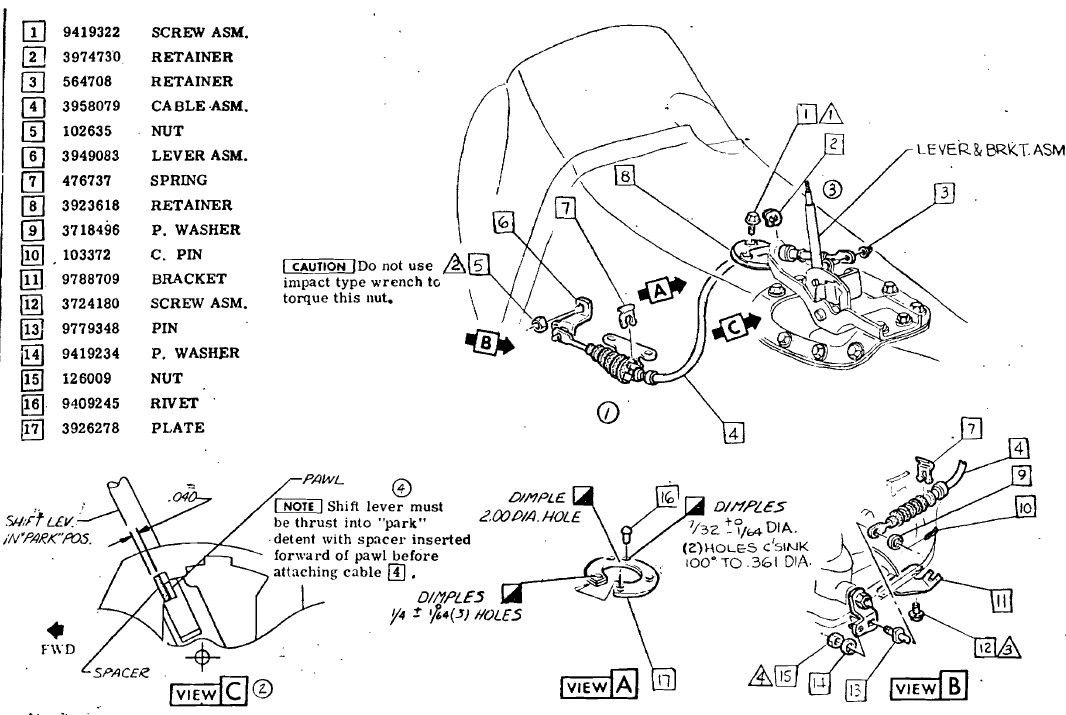

The adjustment is only on the transmission lever. The shifter was to be put into park (with a spacer holding it "not all the way against the stop" and then the with the transmission in park the bolt/pin that the cable attaches to is tightened in whatever place it was at.
The spacer was to make sure the transmission was in park and not just the shifter bottomed out before it was actually in park

They refer to it as a detent in the AIM, I tend to think of it as a gate
