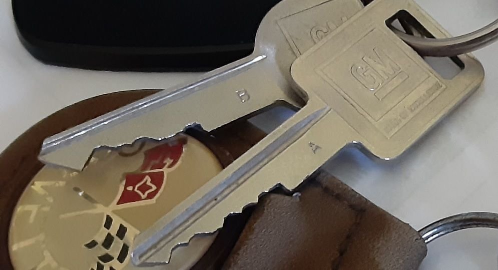

For 71 Corvettes there are only two different keys. The rectangular head key with the letter A keyway and the oval head key with the B keyway.
Rectangular head for the doors and ignition. Oval head for the rear storage compartment doors, alarm lock and the spare tire tub lock. These are GM “ Mark of Excellence” keys. Someone (
MelWff) mentioned above about a third key. Those were used on earlier ‘70 Corvettes with serial numbers up to about 12,250, and were a smaller round Briggs & Stratton Keys.)

This is absolutely correct… For 1971, two keys only. “A” key way is rectangular and operates ignition and doors. “B” key way is oval and operates the storage compartment lock, spare tire lock, and alarm if so equipped. The small Briggs & Stratton alarm key was discontinued during 1970 production.

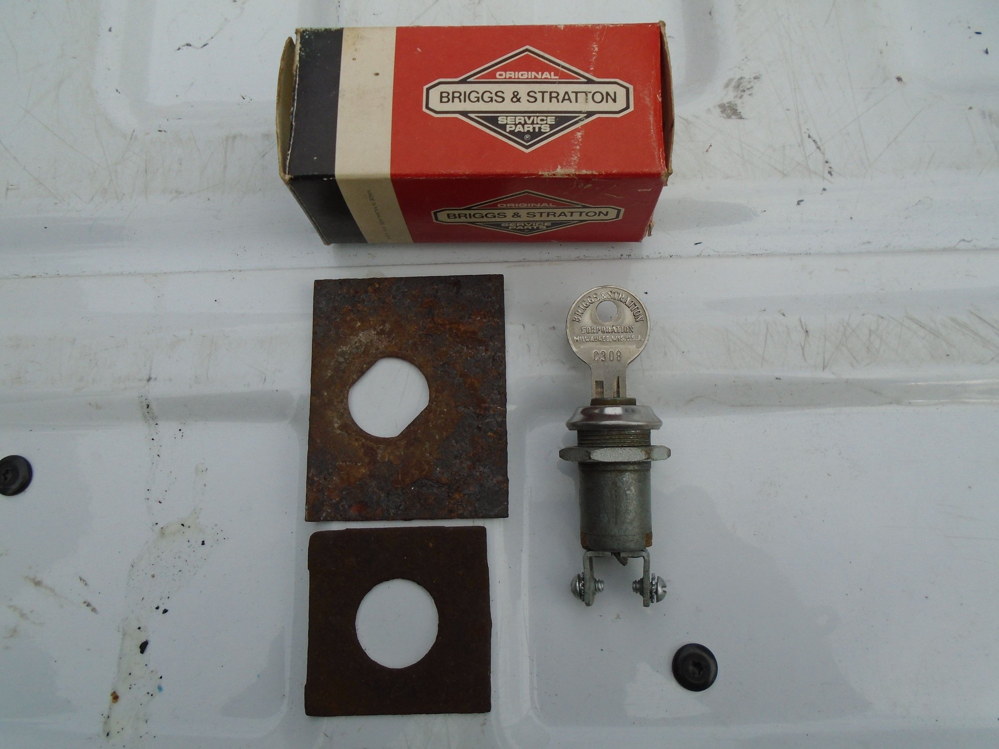

THIS IS FOR 1968 THRU PARTIAL 1970 MODEL YEAR

And the hardest part to find in that whole setup is the mounting plate shown middle left in your photo Ralph. Nobody seems to think that they are important, so they get tossed.

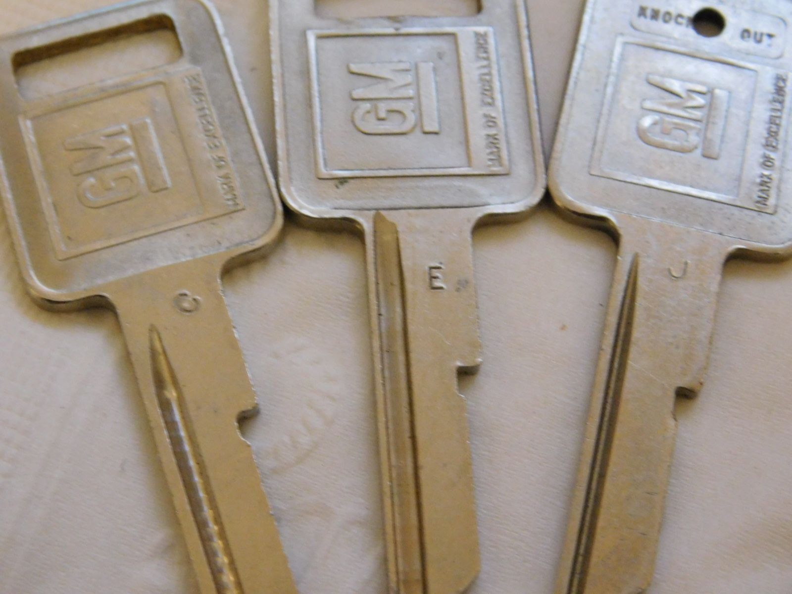

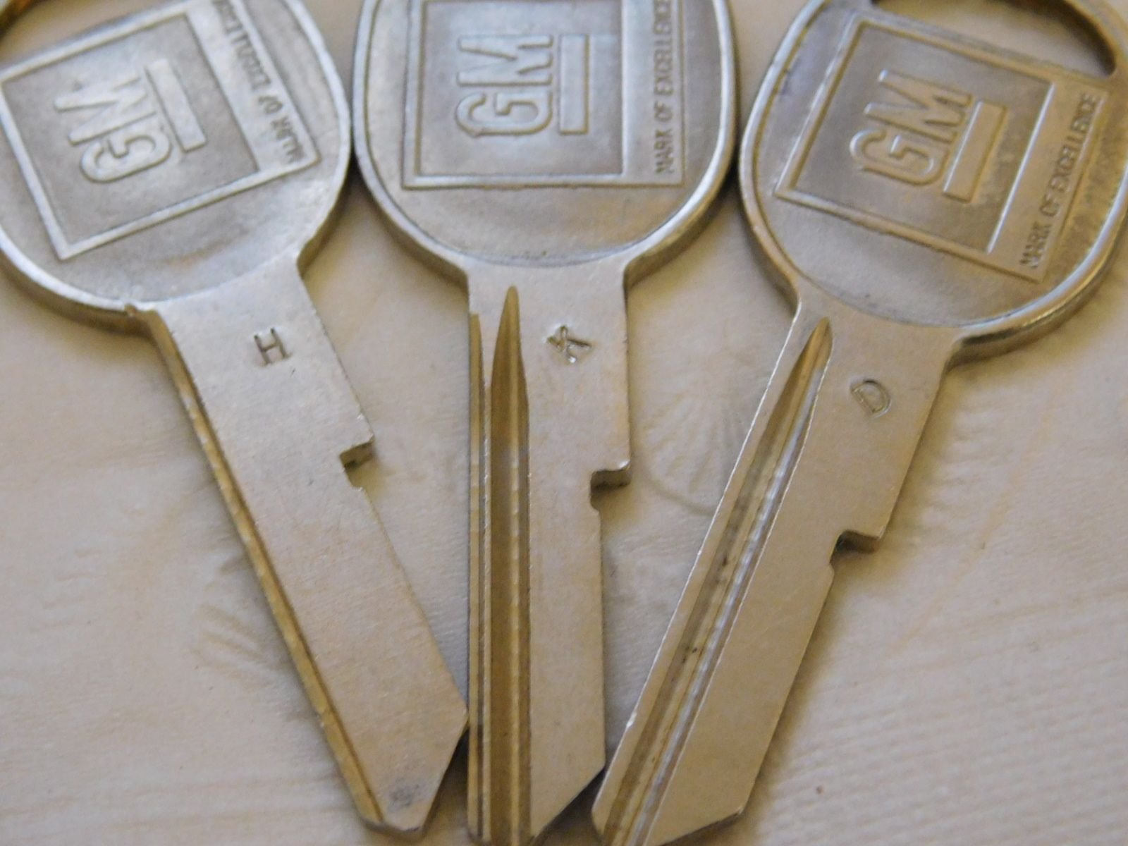

Most of the replies gave you the correct information about 1971 A & B keys and their usage. Keys for other years have different keyways, are stamped differently and probably not slide into your locks. See the pictures to see what original keys look like; set of J & K are for 1970 and C & D are for 1972.
If you have 1971 lock cylinders you can buy 1971 A & B GM uncut keys to duplicate. When you have A & B uncut keys you can inset them into your locks and if they slide in you will know if you have 1971 locks. Your existing ignition key should work on your doors.
You say you live in a small town which helps. You can take those uncut keys along with your existing keys to the local hardware store with a key machine; the kind that the guy locks your key and the uncut key in the machine to cut/duplicate your original. For your missing key, find a local lock smith, bring one of the B lock cylinders (glove, spare, alarm) and your B stamped GM keys and have him cut the keys. Everything I said works if you have 1971 lock cylinders in your car.

Does NCRS judge look for the mounting plate.

I always did Ralph... Only because I knew that about half of them would be missing/not typical. Couldn't tell you what they are doing now.
