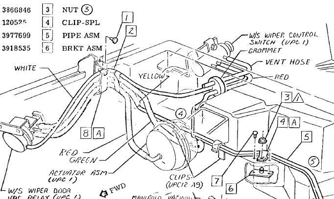

Have a 1972 454 convertible. My question is about the hoses attaching to the passenger side wiper arm base in the wiper compartment. There are three hoses(exclusive of the washer hose which runs up the wiper arm and is not part of this). Starting at bottom of wiper base: Bottom hose is black/white stripe. Center is black/red stripe. Third and top hose is all black. Top all black hose which is attached to wiper base then runs forward through the firewall and ends at about six inches long. It is attached to nothing. Just an open hose dangling. I assume it is there for a reason. What should it be attached to????? Thanks

It's just the vent hose for the valve. Doesn't connect to anything
Shown here marked as the "vent hose"

Great news. Thanks. And I really appreciate the schematic you posted.
