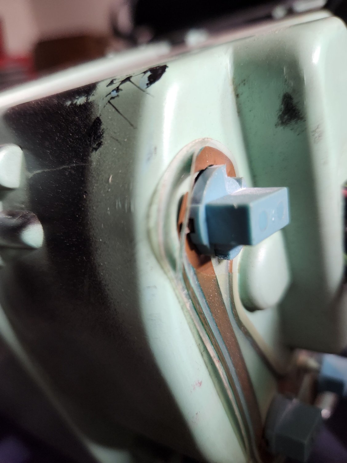

Hey, thankyou all for the fast responses! Here are pictures!
My main (uneducated) concern is the separation and possible oxidization around a corner of the sheet, at a bulb socket.
In all honesty, I've now had a few more unforseen setbacks with the resto and will more than likely just order a fresh one. But for future projects, knowing just how far one can push these old circuit boards would be helpful information to catalogue for my amateur self.
Thoughts?
Is the green crud oxidized copper?? Or is it glue/laminate??
Separation between the two halves of the sheet.

St. Jude Donor '22
oh, I see.
a new one is a good idea
That's about what mine looked like in several places some ten years ago, both the main cluster and center stack. Just speaking for myself, there was no way I was going to put the dash all back together with those ancient printed circuits.
That's what I did, but one man's meat is another man's poison. When I received the new printed circuits, they looked identical to the old ones, but were in brand new condition. I considered that the perfect solution. They have been working great ever since, which doesn't surprise me at all.
Thoughts?
That's a good question, but I wasn't tempted to experiment to see how long it would take for the old ones to fail. I was seeking peace of mind. In the case of my C3, they had lasted 34 years when I replaced them. They were still functioning but were deteriorating, like yours are now.

The green “crud” is oxidized copper. If it were mine, I’d wipe it down carefully with a q-tip dipped in vinegar to remove the oxidation, then temporarily tape it down in sections and apply a small bead of cyanoacrylate glue around the entire periphery to prevent further detachment. Will last forever.

Great to know that's the surefire way to go, C3Highway. And 69L88, thankyou for the crafty idea! I will definitely be saving this old printed circuit and I'll try that for the ol' grins and giggles.
I will be just picking up a fresh one (TopFlight has a good sale on rn) but this is exactly the kind of discourse I was hoping would happen - thankyou all to those who contributed.
