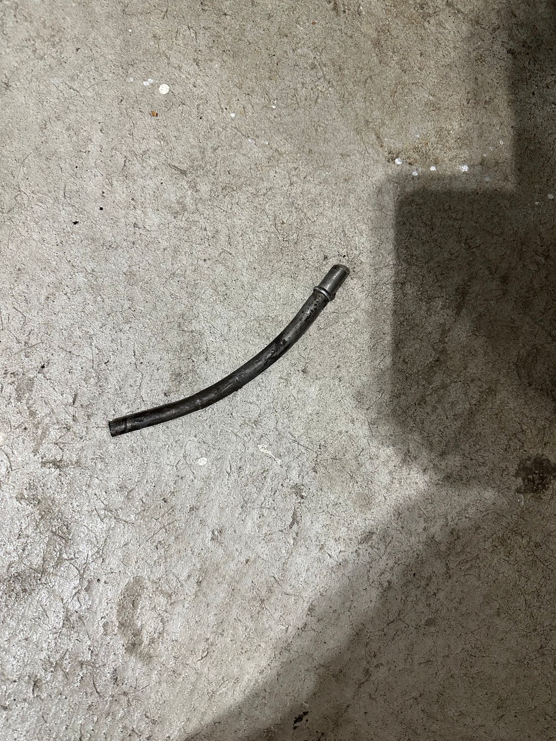

Came home from an evening cruise, went to check the oil and the guide for the dipstick to the engine popped out.
I don’t think any of it broke off, should I just buy a new one?

No, the originals are better. Put it in a bench vise or use vise grip and pinch it a bit just below the stop bulge, then drive it back in. Be careful not to get the bottom opening out of round or you'll have trouble getting it started.

Should an o-ringg or silicone sealer be used to prevent seepage?

I had that happen a few years ago. That tube is meant to be a press fit. Trying to crunch it with a vise grips and reinstall doesn't sound good to me at all.
I remember I did have to look around a fair bit to find the correct length tube and dipstick. But it was also a good excuse to purchase a nice chrome one.
put the new tube in the freezer for a few hours. Then quickly tap it into place making certain of the alignment. Hasn't budged or leaked.

Clean the hell out of everything and use Loctite Green Machinists retaining compound......a little pinch as stated above doesn't hurt as well....

I think we have all experienced the loose or disconnected oil dipstick tube...unless it's the one that has a tube support for a bolt.
