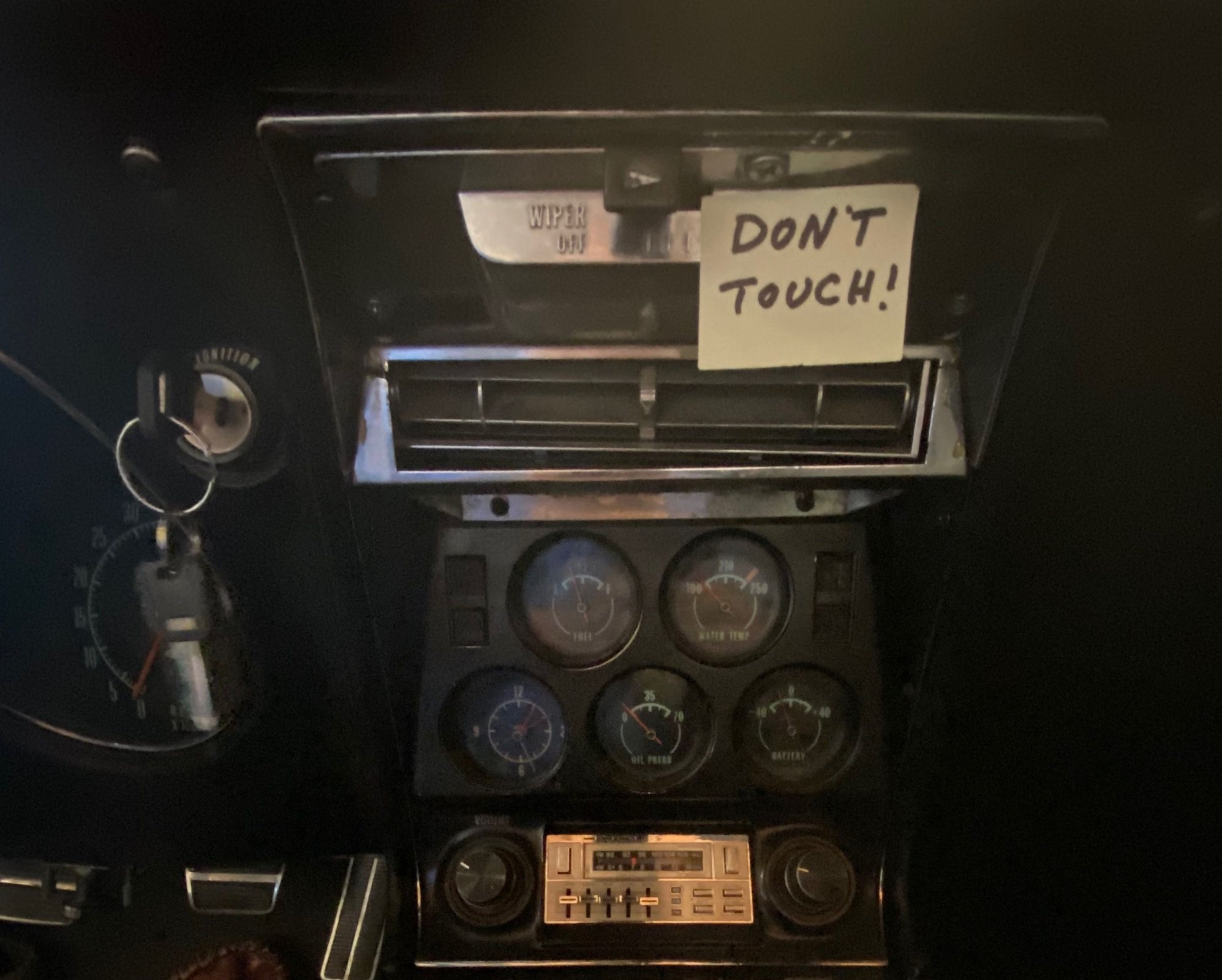

Step #3. This is most valuable advice. Don't drive in the rain, just leave that freakin' wiper system ALONE!
Mine's got a yellow PostIt note sez DON'T TOUCH on the wiper switch. /s

Thats why most states have a safety inspection so that if you are caught in the rain, you will be a safe and responsible driver and be able to see and drive safely....I never plan to drive the corvette in the rain but I have been caught in un-predicted down pours. I would like it if we Bud Lighted the weathermen for being so bad. It doesnt matter if you have a note or not, if the wiper door doesnt open, the wipers arent going to work, theres a safety switch on the cowl and on newer years under the door

That's why most states have a safety inspection ...
It were a joke, RR.

This needs to be ALOT bigger.....lol
