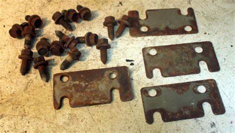

Does anyone make a set that are correct? It seems all the (remaining) parts suppliers have holes that are WAY too close together. I tried a C-2 set for comparison but same problem.

Just to make sure we are talking about wedges...do you mean these...
or these shims/spacers.......( some people refer to these as wedges)

I was able to get a pair off a parts car today, thanks to a generous neighbor. For the record, I held it against the also original decklid wedges, and they are absolutely different.

FYI...ALL the wedges on my '68 door and deck lid are the same shape as in the picture below....

None of the vendors reproduce the correct style wedge for the lock pillar for 68 and at least E69 convertibles.

If necessary...buy a strip of solid nylon and fabricate your own wedges.
Fabricate a wedge on the end of the stick using the stick as a handle.
Grind the wedge to shape/drill holes/cut the wedge off and finish-sand the end.
