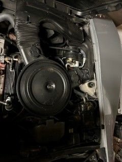

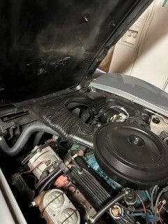

Old Jul 17, 2023 | 04:16 AM
Lawdog74's Avatar
Lawdog74
Joined: Jun 2023
Posts: 23
From: Katy, TX
Default Pictures of current air cleaner
Old Jul 17, 2023 | 04:48 AM
4-vettes's Avatar
4-vettes
Posts: 13,282
Likes: 7,863
Cruise-In VIII Veteran
Going to be hard to beat that duel snorkel air cleaner for performance reasons.
Me, I'd gut out, delete the hot air flappers. I never run in below zero weather. And those flappers are a bit in the way restricting flow.
Put a chrome lid on it if you want to pretty it up.
.Or rip it off for a much cleaner look. Maybe give up a couple high RPM pony's. But a much cleaner look.
Old Jul 17, 2023 | 05:45 AM
Lawdog74's Avatar
Lawdog74
Joined: Jun 2023
Posts: 23
From: Katy, TX
what are hot air flappers?
Old Jul 17, 2023 | 06:37 AM
bmotojoe's Avatar
bmotojoe
Joined: Oct 2007
Posts: 4,384
Likes: 1,755
From: Seattle Area Washington
You have what is called a TAC or Thermostatic Air Cleaner...
It is part of the emissions system and used primarily for cold starts.
On a cold start, under hood temp under 85* fresh air is closed off from entering the air cleaner and only pre-heated hot air from the stove pipe is allowed in.
There is a vacuum sensor inside the air cleaner, when that sensors temp reaches at or above +85* - 128* both fresh and pre-heated air are allowed to enter the air cleaner.
Under hood air temps above 128* only fresh air will enter the air cleaner.
That's the way it should work anyways...
You can see there is a vacuum actuator on each air inlet of the air cleaner, this controls the (flapper) on both the drivers side and passengers side.
On the drivers side, it also controls a gate that allows or closes off hot air from the stove pipe.
Old Jul 17, 2023 | 07:57 AM

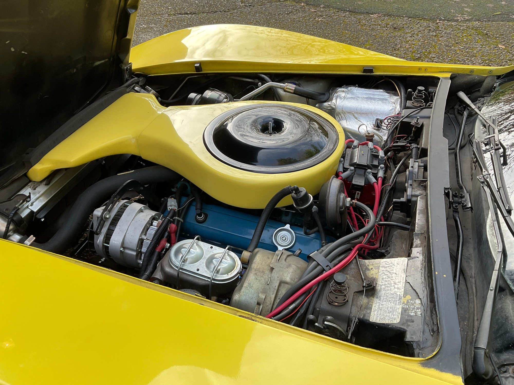

So a few years ago after pulling my rad and swapping to electric fans I decided to go for a drive with the hood still off my car... I was pleasantly surprised at the increase in power I felt with the hood off and cooler air getting pulled into the carb. (some of this was also from the freed up hp from the lack of the clutch fan drag)
So I built my own cowl CAI setup using a spectre piece. I wanted to make sure it was working so before I did it I installed a dual temp gauge with a thermister in the engine compartment down by the back passenger spark plug location and another sensor inside the air cleaner.
What I found was my new air cleaner setup keeps temps very close to ambient when the car is moving and while sitting still its still at least 20-30 degrees cooler than in the engine compartment.
upper temp is inside the air cleaner and lower is engine compartment at full temp just pulling away after stopping at a light. When moving on an open road the difference in temps climbs I do not have the flaps installed above my control arm and I have open space between my hood and the top of my rad which normally isnt a great idea but I have a high rise hood and found the engine compartment stays cooler this way with my engine temp also still being consistent.
And no the gauges are not hindering air flow and the temp sensors are accurate. The vents in my hood are functional as well.
