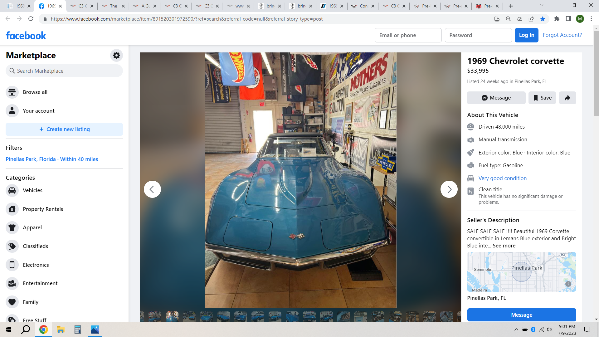

It's hard to tell from the small pictures. I found a listing for it on facebook marketplace. Its been listed for 24 weeks, could be the same car.
