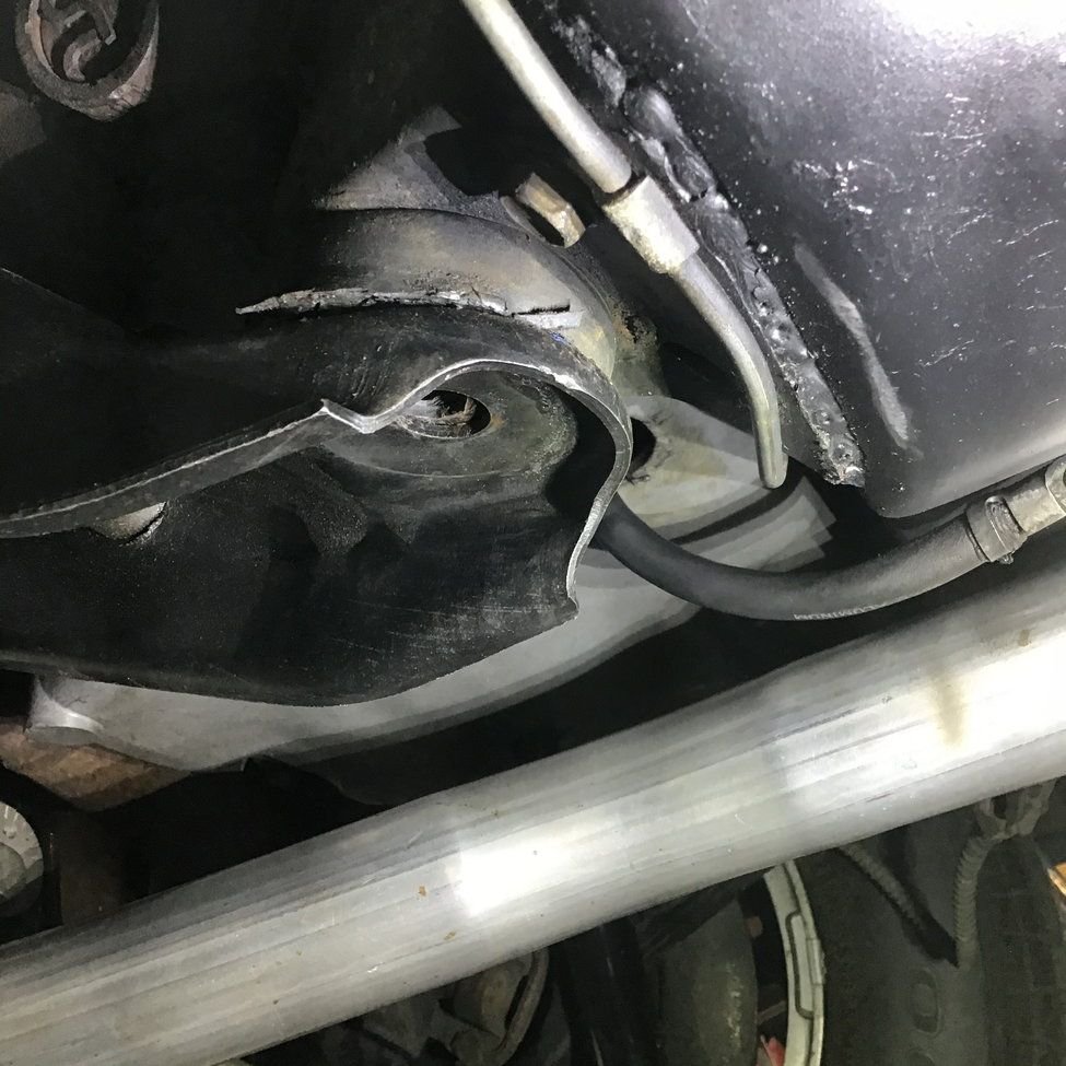

this is this is
snubber i replaced 79
https://www.corvetteforum.com/forums...hing-79-a.html

Thanks for the pic's, I order a snubber mount kit, going to attempt the replacement. Hopefully this eliminates my clucking noise!
Mike
