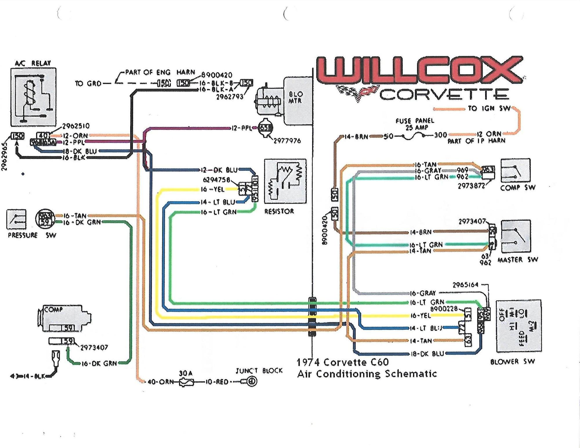

Just bought a 75 Vette. The console is all out of it including cluster, radio. Previous had started renovation and then lost interest. I bought a new a/c control and now trying to figure out where all the wires go. Can someone send me some pics of the units installed so I can make sure I get it right. Need help.

I can't find as '75 schematic, but this might help:
