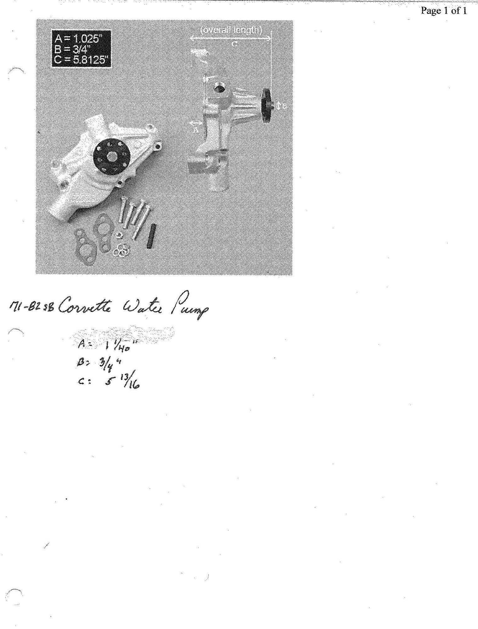

Just make sure that is a 'Corvette' water pump, not a long or short one.
Check the dimensions.

If you order it from Top Flight you'll get whatever "Corvette Water Pump" they are selling. That will certainly work.
If you order by part number, you can be more precise. Here's what I wrote the last time this came up.
Originally Posted by Bikespace
Here's an ACDelco water pump, Delco part 252585, GM part 88926099, bought from RockAuto, painted GM Corporate Blue by me, and installed in my 80. I think it was cast in China, but seems to work. I replaced the (likely original) pump when I switched to electric fans.
There are certainly nicer water pumps out there, but this one was $35-.
