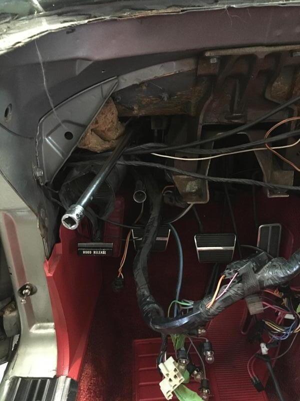

Default Replacing brake booster
I bought a tuff stuff power brake booster and MC months ago,and after a little research found that where the location was would be a challenge,and after a hour,finally found they were 15mm nuts,and would need a swivel and at least 12-15 inch extensions and a deep wall socket,because the bolt threads come out 1 1/2-2 inches,fine threads,so,a lot of turning.this is on a 1981,to begin with I’m not a big guy,and even though I am 62,I can still twist and turn very good,which you will have to do,first,I already have seats and carpet out already,I don’t see any way to do this with the seats in the way,I couldn’t.as I look with a good light can only see 1 nut,their is a huge wire harness the size of my wrist in the way,took a long plastic tie and tied it to the brake pedal tight out the way,and could see all bolts,so at this point I have removed three nuts,and the top corner one,everyone says is tough is all I have left,and unhooking the Clevice which I still haven’t seen yet,but it’s alot of wires,but this is a tough job.

Old Jul 30, 2023 | 09:52 AM
doorgunner's Avatar
doorgunner
2026 Loser of the Year
Posts: 36,607
Likes: 7,053
From: New Or-leens Loo-z-anna
It gets much easier after the 2nd time.
You learn where to reposition/zip-tie the wire bundles permanently...
How to grind points on the end of the bolts so they "find" the nuts much easier...
How to use that battery nut-driver to remove/install bolts.
Old Jul 30, 2023 | 10:05 AM
John 65's Avatar
John 65
Joined: Dec 2003
Posts: 5,381
Likes: 416
From: N J
Did mine on my 77 a few months ago and found the only way to reach that top left nut was with a short stubby ratchet and a deep socket.
No universal or extensions. An 81 dash is different so not sure if that helps. Also I used the same clip for the clevis again, the new repro wasnt the same as the original.
Old Jul 31, 2023 | 07:54 AM
Catfish4818's Avatar
Catfish4818
Joined: Mar 2006
Posts: 4,555
Likes: 5,161
From: Chester VA
On our 1972, the only way I was able to access that top left nut was to remove the driver's side dash, which then gave me a straight shot at it. I know your dash is a bit different, so this may not help you.
When I installed the new booster, I did not reinstall that last nut. Three out of four kept the booster quite stable.
Good luck with this difficult job!

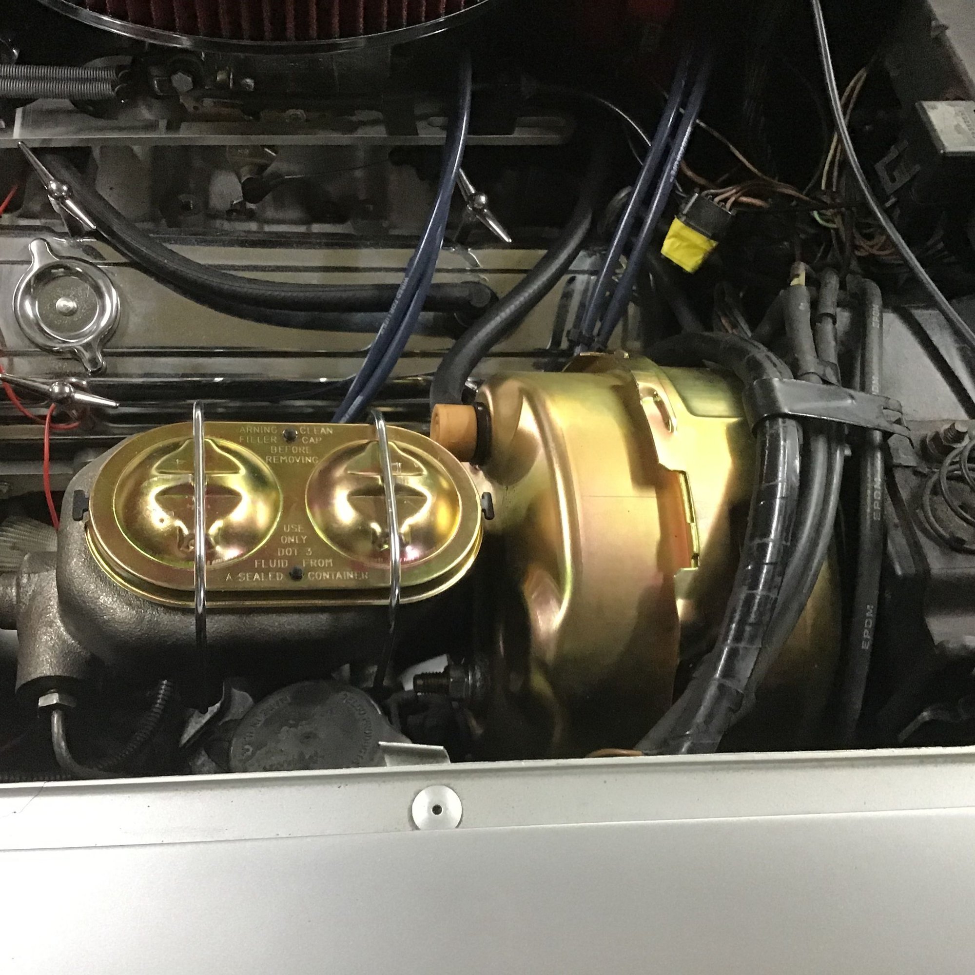

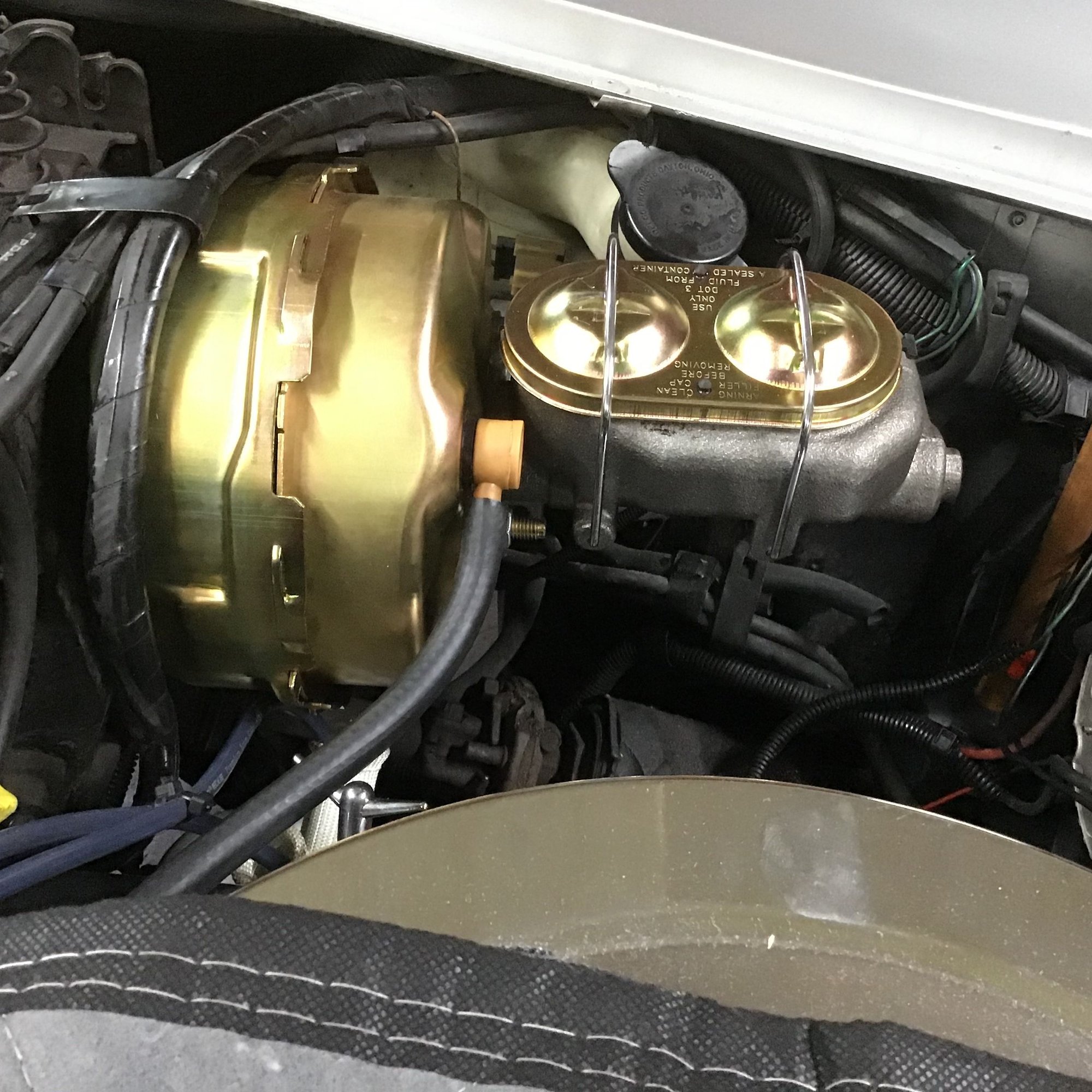

Old Aug 2, 2023 | 08:41 PM
Golferdad's Avatar
Golferdad
Joined: Feb 2022
Posts: 988
Likes: 183
From: South Carolina
That looks much better,thanks for the help.
