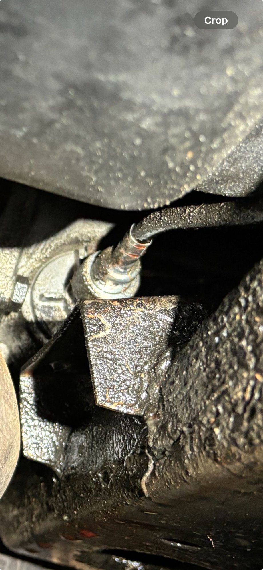

Default Drivers side trans leak - '82 collectors edition maybe the speedo gear seal?
Can anyone advise what this leak would be caused by? '82 collector edition driver side trans leak. Can this be replaced with the transmission still in the car? Will the cross member support need to be removed?

your picture is of the speedometer assembly , there are two seals in this unit plus the driven gear itself can wear a groove where the seal rides making it leak
Dip stick tube , case through connector and TV cable are the three seals you haven't replaced yet and they are common to leak after sitting a few weeks after the torque converter drains fluid back into the pan causing an over-full condition where the speedo assembly usually leaks after a drive cycle .... all of these items can be repaired without transmission removal

Thanks. I've seen some videos of breakdowns and replacement of those mentioned seals for the speedometer gear. Is it possible to remove and replace those two seals pictured? It was a tight fit to get the picture
