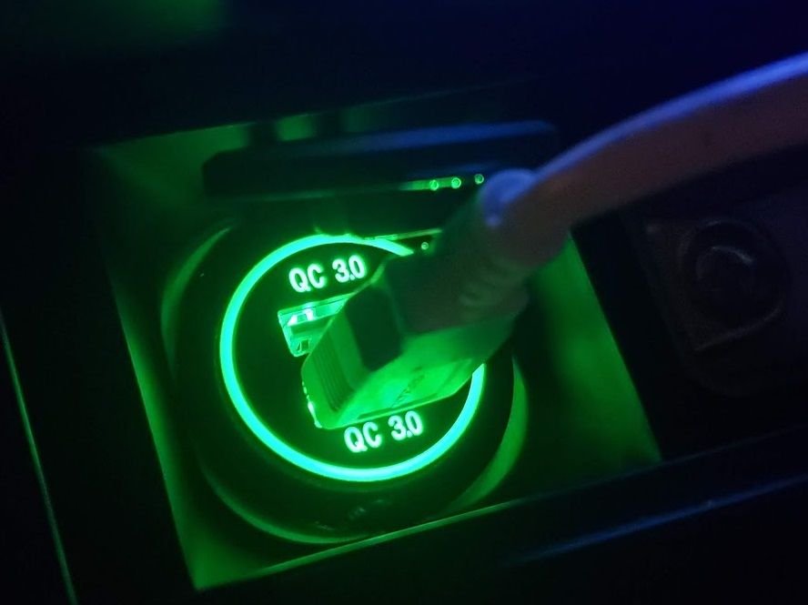

If you are going to modify it anyway, consider direct wiring the accessory, and putting a phone charger in place of the cigarette lighter. A step-drill makes short work of the plastic center console (77-82).
The cigarette lighter is on an always hot wire, so you may want an IGN fed wire circuit anyway.
