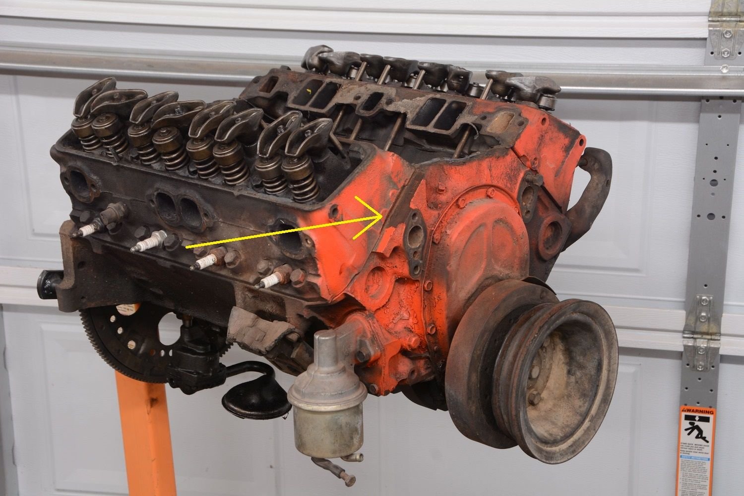

Stamp pad is on passenger (right) side of block in front of the cylinder head faces up. Probably need to clean it up to read it BUT DO NOT use sandpaper!

LQQKS like this:
LOCATED HERE :

Or anything abrasive. Thinner or paint stripper are all you should use on the stamp pad, or you could change the appearance of the pad's surface, which is as important as what's stamped on the pad.
