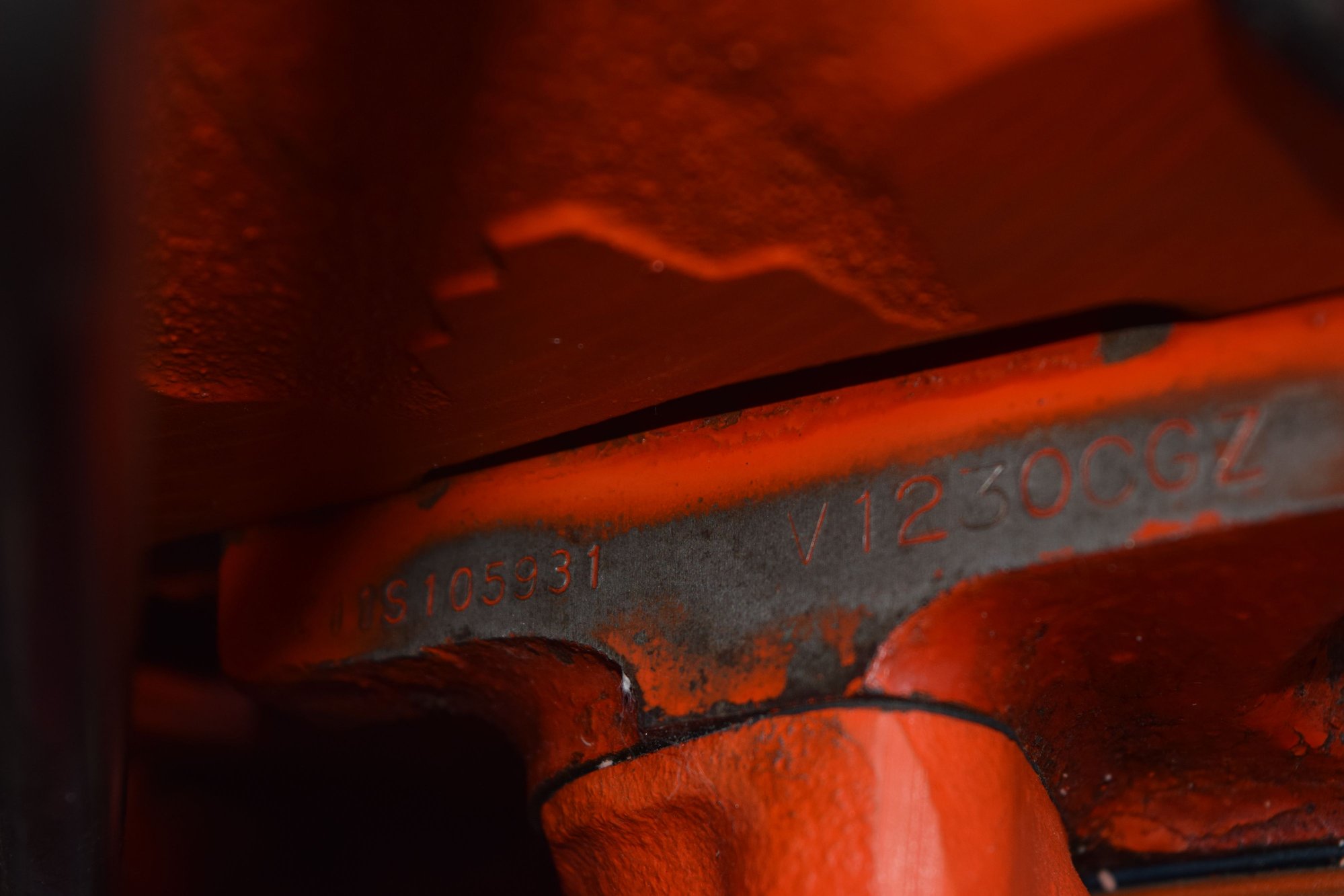

Hello all,
I'm getting ready to submit my car to Bring a Trailer and pulling together my photos. I know the engine stamp is one of the important things people will expect to see. Have I removed enough paint in this pic? Would this satisfy you if you were in the market?

If it was me i would want a brighter picture or flash on…
i study all picswhen buying and anything hard to see would not help.
note.. look at it on phone or ipad…manyare not on a large computer screen
the removal of paint appears fine

A clearer photo would be helpful, but from what I can see, the pad looks good.
As I always say though, you really need to see a pad in person to make a definitive determination. That’s not your problem though if you are selling on Bring A Trailer.

at some point motor was resprayed?
Why not? It's 52 years old.
curious if owner rebuilt

Bottom end not rebuilt, but cleaned up and painted at one point. I discovered that the valve guides had play in them about 10 years ago. So I had a shop rebuild/refresh the heads. Motor was not removed and not decked.

Thanks all for the feedback. It's difficult to get a good close up angle with the fuel line there. I'll get a better pick of the pad before posting it.

If you get the right angle and lighting, you can see the broach marks clearly and in focus.
Most people like to see that...
  • The pad is supposed to be completely free of paint, I'd suggest removing all of it. This just shouts, "Repainted by someone not in the "know"."
  • Get a soft light in there to brighten it up so there are no deep shadows.
  • Make sure the stamps are sharp, end to end -- even if you have to take a separate pic of each one. Backing away and cropping in may be what's needed if you are too close for the camera to focus.
  • Lastly, see if you can capture the texture (broaching marks) of the pad surrounding the characters. Textures are best captured with low, raking light.

painted pad brings up questions and you want to play it off as it is common on old cars.
You wanted opinions on your pad.
