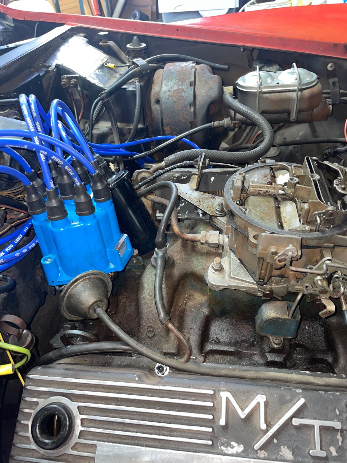

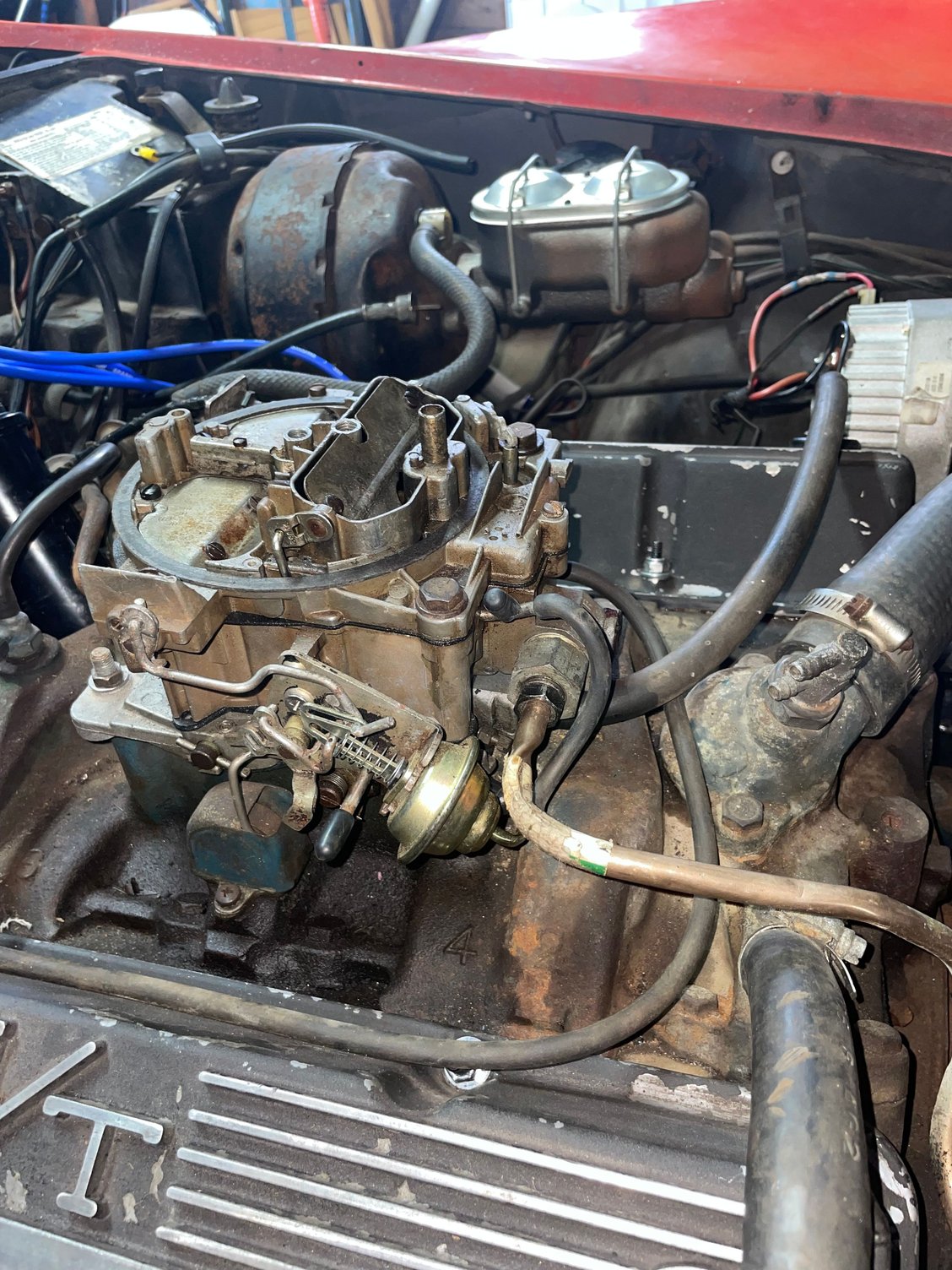

These pics are pretty big, but thought maybe they'd help to show the current configuration..
Does anything look really amiss to you?
(aside from the fuel line)

The first picture it looks to me like your metal fuel line just before the carb is crushed. i would replace that asap. second pic looks like there is no wire hooked up to the temp sending unit.

Does your headlights ooen and close. You have an open vacuum line near you brake master. It doesnt sound like its idling like a big cam, just sounds like a bad idle
Pat
does this look right?
Honestly,. I haven't even started messing with headlight system yet..
It also occurs to me that I took apart the center console, and I have that round bundle of hoses that goes to the heater/ac control, just hanging out in mid-air... is that a vacuum leak?
Probably. easy to find out. next time youi start it just see if any air is being sucked through those lines. if yes then you have a vacuum leak. plug them all with golf tees before you start doing your tuning.

You could just unplug the vacuum lines just behind the carb on that post and cap the ports on the post

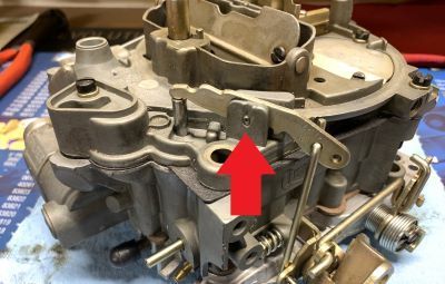

Accelerator pump rod should be in the back hole. Just push the pin far enough to release the arm, if you push it too far it will be difficult to push back in place. Insert a flat feeler gauge on the other side so as to have some room to push the pin back after the switch..
