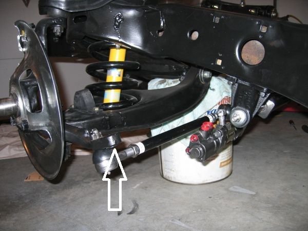

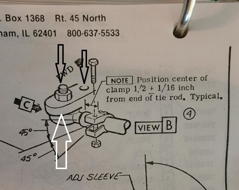

Why are there 2 options here on these steering end connections? Thanks
Not my car, for further illustration.......

The rear holes are for manual steering, the front holes are for power steering. The front holes can be used for manual steering and will give a quicker response, but the steering effort will be increased. If you have a four speed, the Muncie linkage also has a short throw option as well. Jerry
