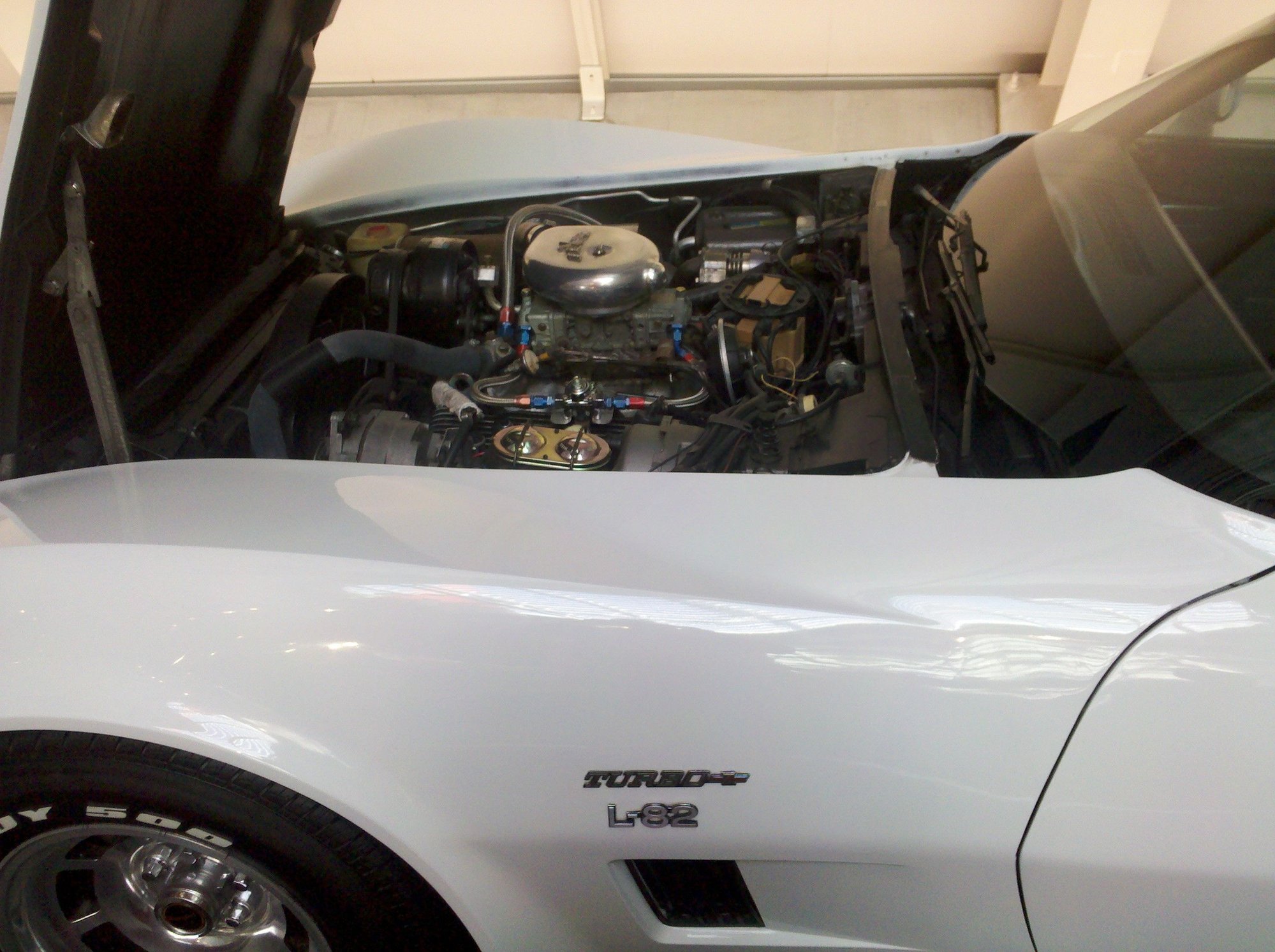

1980 Turbo Vette at Corvette Museum
The conspiracy continues. Probably a bad thing if they ever admitted building a non-emissions certified vehicle driving around on the street.
