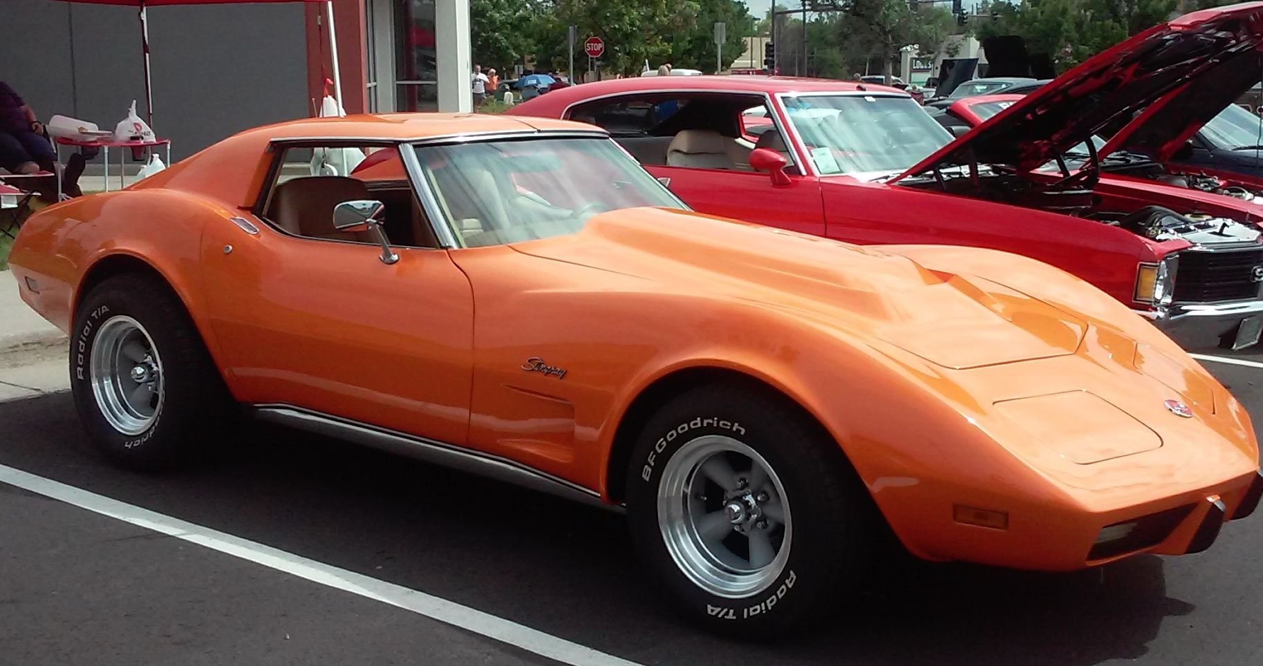

TTO are the original wheels but need a 5mm spacer to clear calipers due to the fact they were designed for drum brake cars back in the day.Here they are on my 76

The wheels pictured look a little
lighter in color than the standard
Gray offering, are they current
wheels? Also where to get spacers?
thanks
This 76's color combination, orange over tan, is just like the '76 that was my wife's first Corvette, which she later traded in on a '79 C-3. We've often wondered what happened to the '76. Any chance the last digits in your car's VIN are 4005222?
Sorry No It was originally Maroon from the factory and its painted Porsche Orange.
thanks
I bought them 5-6 yrs ago .I believe the TTO from American Racing are lighter grey than the other versions they offer. Spacers are 5mm billet hub/lug centric from www.motorsport-tech.com
