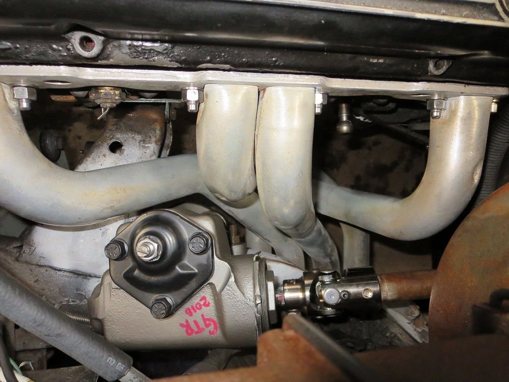

This is what Hooker sidepipe headers look like in a white 80 L48. I know there have been several threads on making them fit around a Borgeson box instead.
My biggest piece of advice: Use studs, not bolts, to hold them in place. Ideally, get the 3/8 studs that go in to the block, and take 5/16 threaded nuts. This will give you the best clearance. Pictured below are 3/8 studs and nuts. The Z-bar is out in that photo, but you can see the ball stud where it passes through the pipes.
thanks Bikespace, thank you for the reference pics, looks great and will be looking into studs over bolts, did you go with universal over rag joint for header clearance?
I chose the Flaming River U-joint to have tighter steering. I didn't test fit the rag joint, I had already swapped.
I think these pipes are ceramic coated. I wish they were black (and still ceramic), but the were really cheap, used. I try not to have any chrome on anything if I can help it.

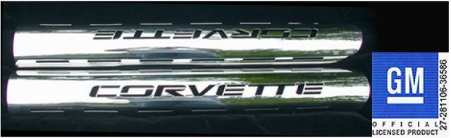

I've been considering the same ... except with heat shields like below.
Three questions :
1) In the posts above it appears Doug's have thicker gauge metal. Anything else that differentiates Doug's and Hooker's ?
2) Still concerned about ground clearance ... do Doug's or Hooker's have better ground clearance ?
3) Are you considering solid motor mounts ? I understand they reduce stress on side exhaust headers.
Thanks - Dave
Three questions :
Thanks - Dave
I did order Doug's yesterday from Summit, I went with Doug's because they were a bit cheaper and read enough good reviews, really no other reason, I even considered OBX but there is no direct contact number for them, I emailed them and they wouldn't give me a contact number.
most of what I've read and seen on YouTube clearance isn't an issue and not really lower than any other part of the car or oil pan.. in fact I think I will get a bit more center clearance.
my car was restored in recent years and the motor mounts are new so I won't be changing them but IMO with the two point pipe mounting at the frame I can't imagine too much stress on the engine mounts, but could be wrong.
I purchased two sets of inserts to play with sound vs hp hindering but with a 1980 L48 it will come down to sound more.
I will make heat shields decision after install.
I will start prepping the car this weekend and hopefully install next weekend, will update on install.
