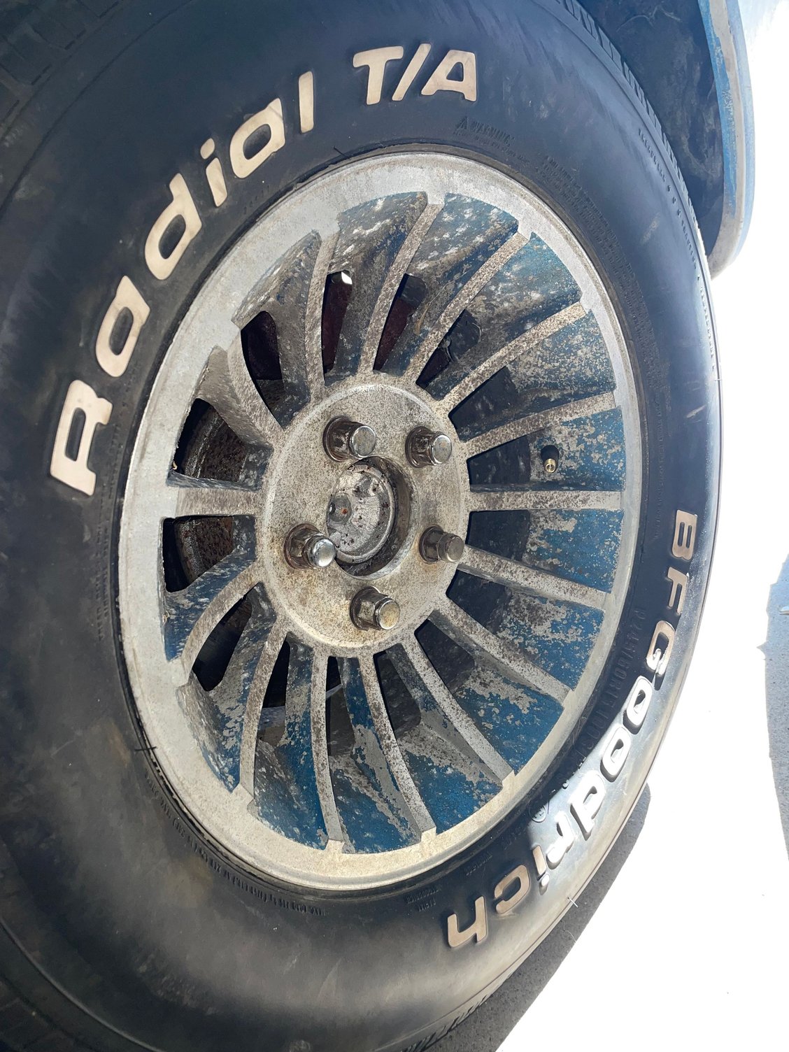

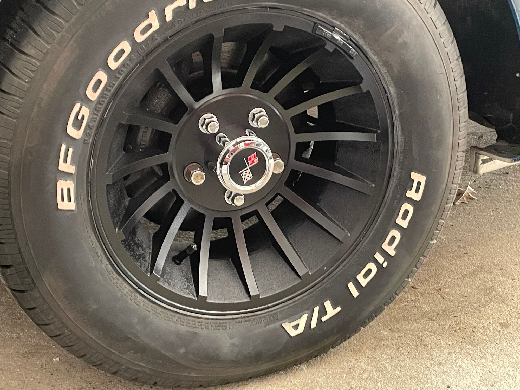

rims terrible. Old turbines. I used 60 grit , self etching, and wheel paint. Chrome wheel caps and lugs look awesome with the black ri s.
You used 60 grit on your wheels? Do you have any pics?

Yup. The self etching pre coat worked great. I’ll put some pics in the AM.

Here are the pics.
Before
After

Wheels look good, I would have thought the 60 grit would leave deep scratches but they were pretty beat to begin with...good job..

I'm thinking you did a 'tad' bit more than "60 grit" on those wheels. The After pics are really nice.....

Nope Just hand sanded them. Washed them with soap and water. Primed with self etch spray paint. Then sprayed with wheel spray paint, major elbow grease on the sanding.
