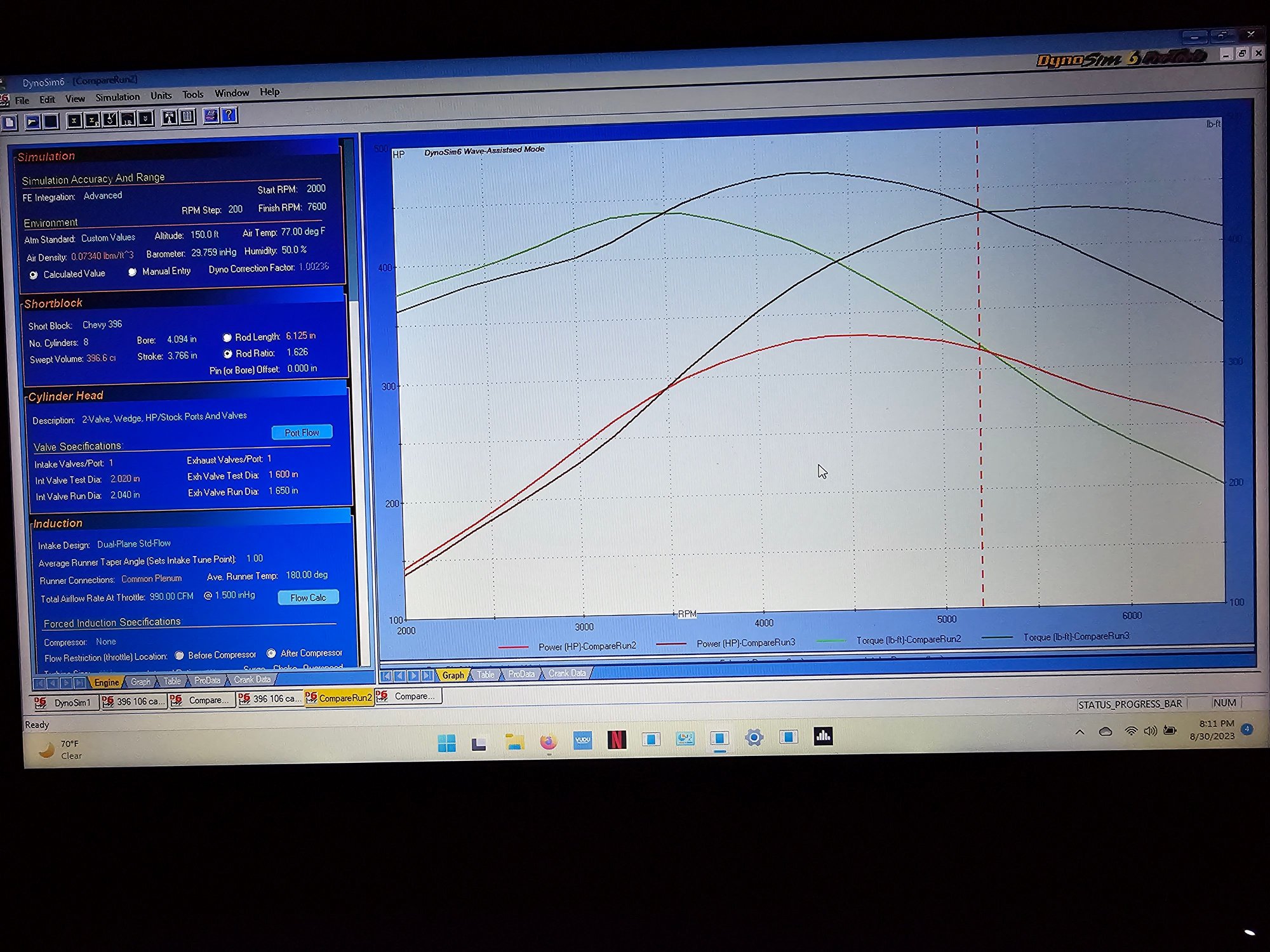

I wasnt happy until; I was at 13 flat...my lazy 396 is in the low 14s and I hate it,,,....aaaaand I just found out I cant get my motor on a dyno until October so I am throwing my good RaceRite heads on the 396...big compression drop but I gain about 100 hp and about another 1000 rpm
just the head change
