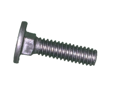

Man that's just crazy. I'm using 50year old ones and they are brittle but not like that. I wonder if the new ones aren't even worse than the originals as far as strength.
I'm guessing yours broke in the normal place where it snaps the 1/2 threaded stud off of the main body? I do remember looking at one once and wondering if a flattened head stove or carriage bolt cold be fit into the broken body somehow but never really pursued it beyond that as my 2 are still intact
I've got a broken switch around here somewhere I should dig out and look at to see if it could be modified to use something like this
