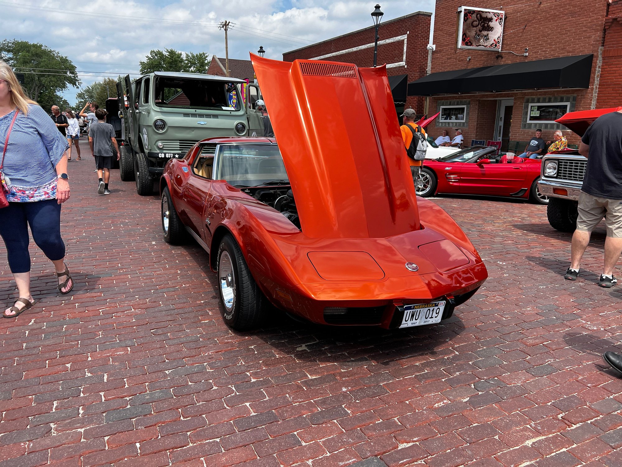

I've recently bough a car in Michigan, a 1975 Corvette painted a beautiful but not very common burnt orange. I naturally want to check what the original color was.
There are no remains of an original paint to be seen and the side trim tag is missing.

I was just going to say pull the door sills... Burnt Orange looks cool on this '75...

It looks cool indeed and the paint job has been done well and carefully. I'd still want to get a trim tag fabricated, for completeness and looks... and because here in Poland, where I want to register the car the DMV itself and even policemen sometimes don't like missing trim tags.

OP: that orange is one of my very favorite all-time Corvette colors. I hope you can find what you're looking for. The door sill/pushing carpet back a bit usually works well. If you're not certain, you can also try removing a door panel and see what you find along the edges. Best, Paul
