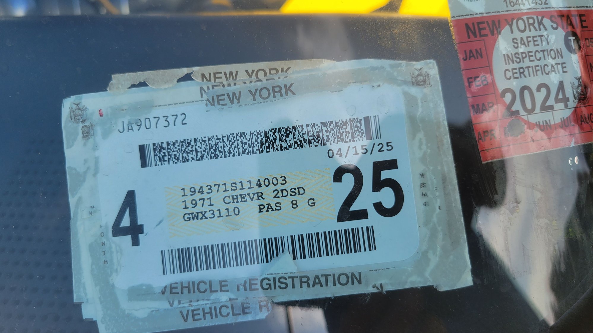

I'm confused with this VIN...see picture. This car has solid color Ttops, 4 speed. Looks very original except for electronic ignition.

What point are you attempting to make?

Looks legit to me. It was the 14003rd 1971 Corvette built. It is a coupe.

Sunflower yellow, black leather interior. Someone listed it on the c3 registry.

I'm sorry...I was looking at the vin decoder and I thought the "43" meant convertible. I'm new to this. Thank you for your help!

Here's a better decoder:
https://corvettec3.ca/vin.htm
Lots of other decoders at that site, too.
37 is Coupe. 67 would be a convertible. The digit used for the engine changed from the third to the fifth in 1972.

There was no engine digit before 72

Yes there was. From 68-71, the third digit was a "4", indicating a V8 engine.
This information is not particularly helpful, though.
