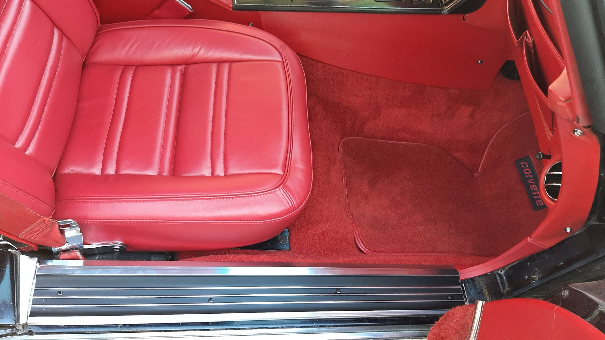

I just finished this on my car last week, the above advise is rock solid.
The only thing that I can add is I glued it all down using Permatex Spray Adhesive, where the original carpet is just tacked in particular spots. I started sticking it down at the foot well, then worked towards the firewall, followed by the sides. Work towards the rear leaving the final trimming of the sides until the very end. I kept the console sides and sill plates handy for reference as well. To make the holes for the seat bolts, I used an old sacrificial socket on a 8" extension, heated it up nice and hot, and then placed it on the carpet and twisted it by hand as it melted its way through.....the holes came out nice and clean. If you try this, do it on a scrap piece first to try it out.
Regarding the carpet plugs, my car (a late '77) didn't have any up front and only had the 3 in the back storage compartment. I couldn't find any required in the '77 AIM as well.
Work slowly and this is how it'll turn out....way better than the worn out crap that was there before!
