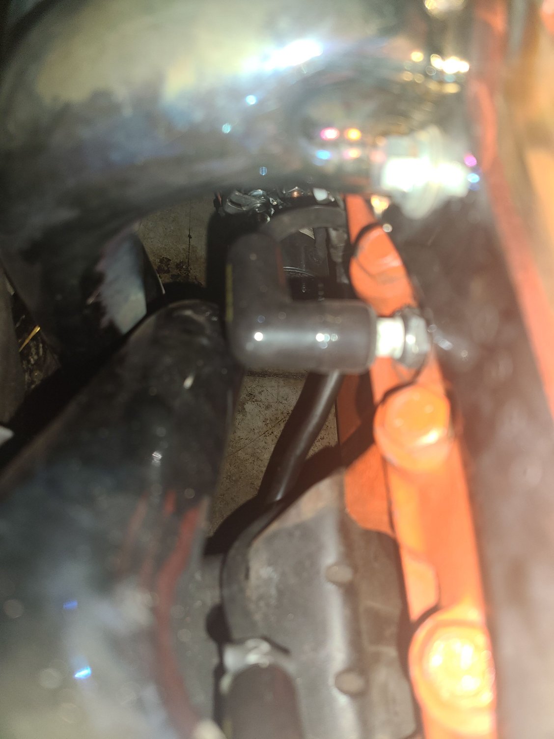

Thanks guys... I did get the head studs and cut to fit wires with 90 degree plug ends and plan to run under headers, the oval port gaskets do appear to be best fit against the Doug's headers from all that I read, haven't ordered gaskets yet but will tonight when I get home from travel and will look into above suggestions, just don't want to use the Doug's supplied gaskets, I will probably pursue the shorty plugs but still not sure which ones from accel 0576s and 0276s keep coming up.

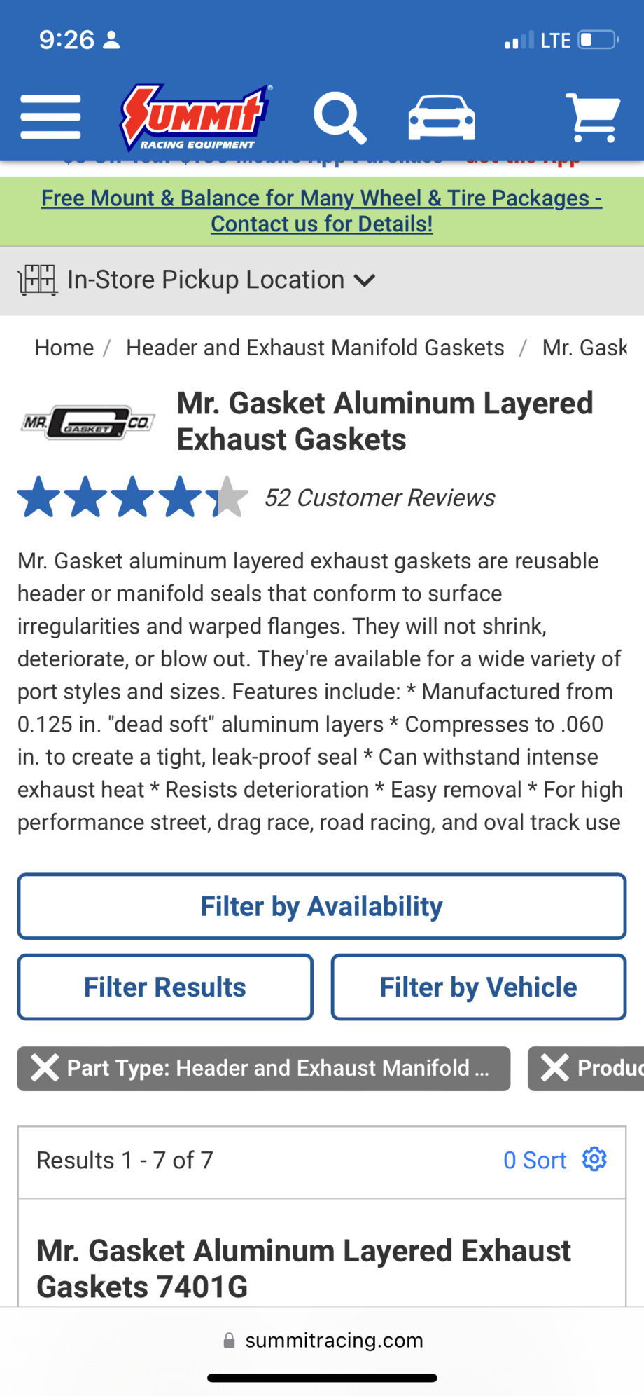

This type of gasket works well.
Old Sep 16, 2023 | 10:56 AM
Golfobsessed's Avatar
Golfobsessed
Joined: Aug 2016
Posts: 1,794
Likes: 936
From: Arizona
thank you, I ordered the copper already.
Got all disassembly done yesterday, mocked up passenger side, header went in without issue and pipe lines up pretty nicely (haven't installed insert yet, looks like it will be a bit of a task)
drivers side header install is next and looks harder than the passenger side, actually looks like the car needs to be higher for that side... so far so good, i will be happy if drivers side goes in even close to the passenger side ease.

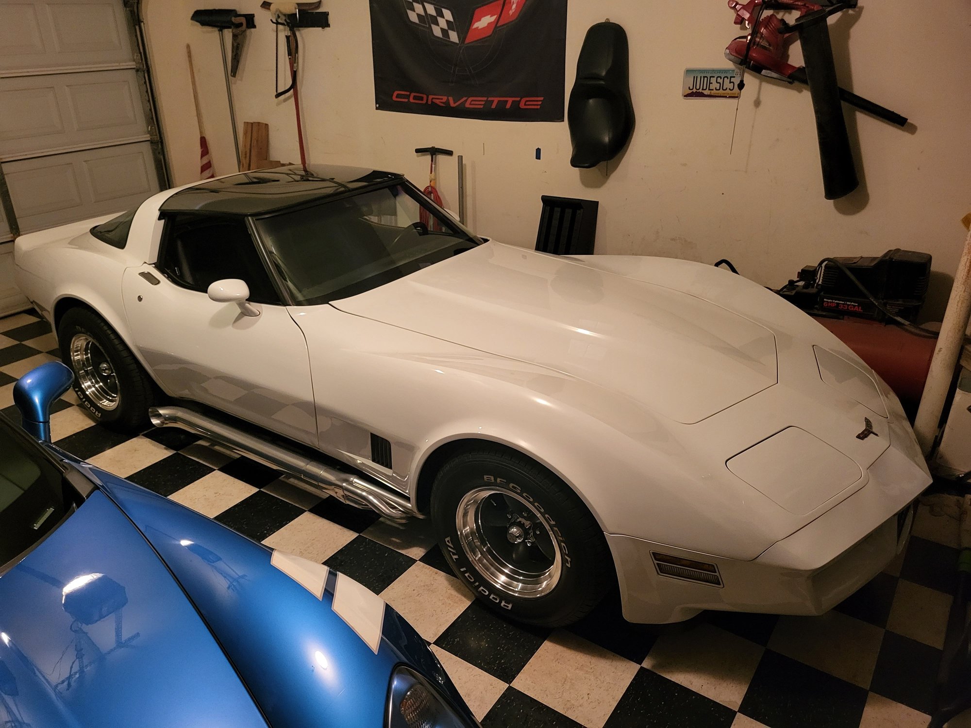

Done and couldn't be happier, bigger job than expected but did a number of things while I was at it. Took it for a short ride and love the sound... I expected a little louder and quite happy that it's not crazy loud, will leave the mid "glass pack" inserts for now. Thanks for all the help and advice along the way
