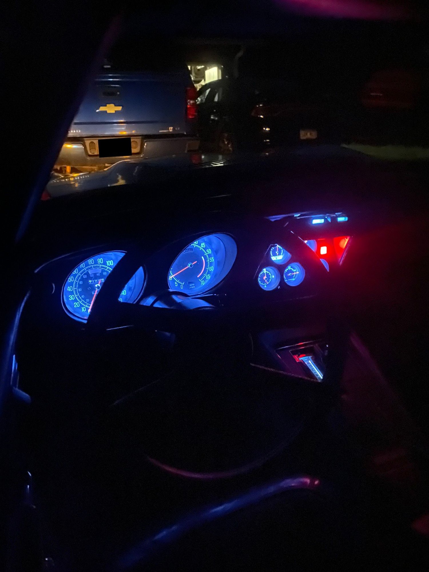

You might be able to reach it from underneath if you have small enough fingers. Otherwise you can slightly lower the steering column and remove only the gauge panel to gain access to all the lights.
Id also recommend replacing the bulbs with LEDs. I did it on my 76 a few months ago and love the blue backlighting rather than the yellowish green it was before.
Wow. The LEDs look sweet! I may have to do that as well.

I did LED's also in my '77. Very happy with my decision. I got mine off of Amazon and had no issues with polarity. Used Lt Blue for the gauges and white for the warning lights. I also painted the inside of my speedo and Tach cans white.
