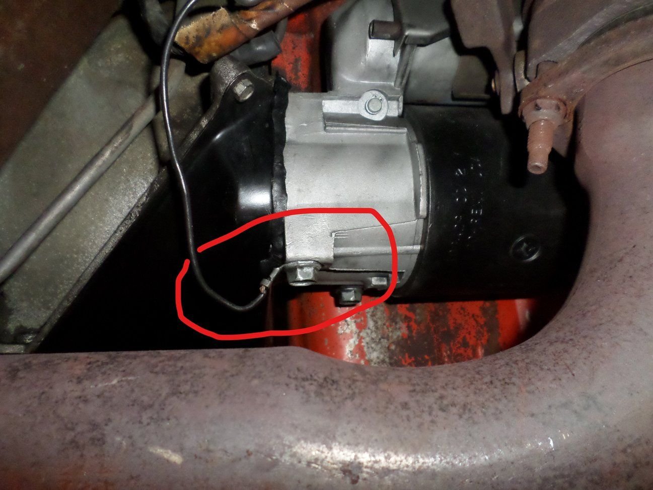

From what I have been able to find on here, I think the wiper motor and heater fan are on a common ground wire. Correct? My question is were does that ground circuit pick up it's ground from? The wires on my 68 are not grounded

The other end of that black wire should be connected to a starter or bell housing bolt.

Thanks Peterbuilt! I might get the wiper to work on this thing yet
