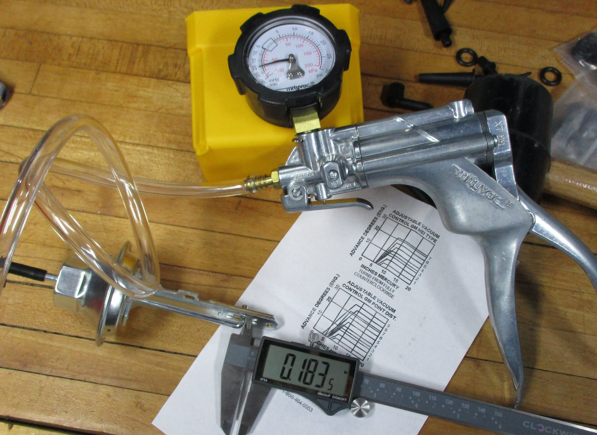

Old Sep 30, 2023 | 02:33 PM
Bikespace's Avatar
Bikespace
Joined: Mar 2017
Posts: 11,953
Likes: 4,509
Did someone say MityVac and Accel 31035?
Definitely test. 7-8 inhg looks to be the minimum all-in vacuum for one of these. If yours is on the ragged edge, you may get some hunting.
