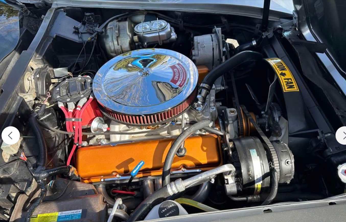

The second car making my search list is a 1981. It is $4500 higher in price than the 1980, but has had much more work done: blueprint engine, 3:55 differential, new brakes, clutch, and other parts. Seller has swapped in C6 seats and T-10 transmission linkage that sort of spoils the look for me. Anyone with C6 seats in an C3, or experience with the Blueprint engine, or transmission?

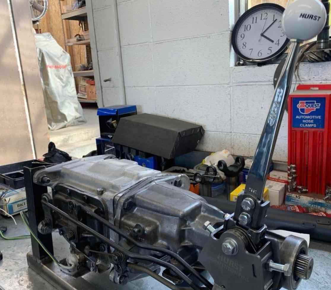

If you drove a Hurst equipped four speed then hopped in a stock shifter car....you would want the Hurst back.......
The Blueprint 350's are a decently built engine but I have found a huge oversight on their part as far as the intake manifold is concerned. There are a couple of people out there that have complained about leaky intakes and the problem is that this is a Vortec spec intake and the heads do not have Vortec ports......although they are drilled with both bolt patterns......the intake ports have a pretty horrible mismatch and I can't believe Blueprint ships them this way........
Jebby

You should probably start a new thread for the 81. I find it odd that it has an adjustable vacuum advance, that has been capped off.
