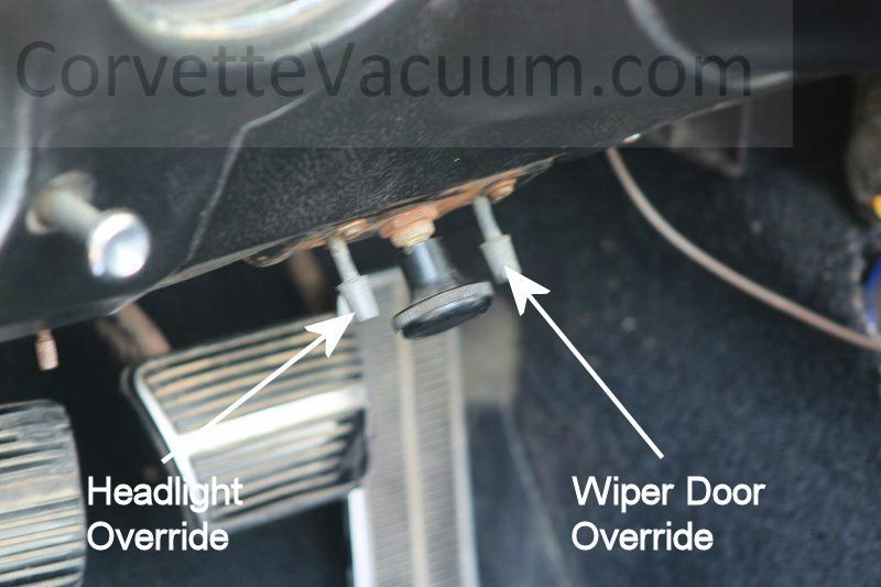

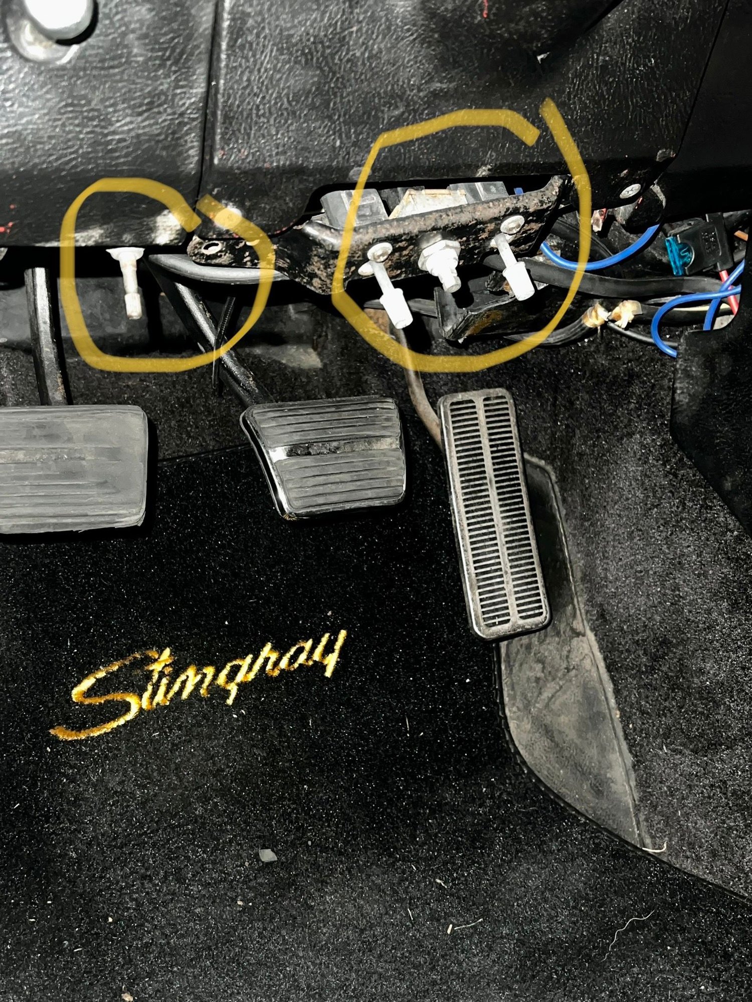

Can anyone tell me what these ***** are and what is the function?

The one on the left is a trip reset the next one is a pull down switch for head lights the next one is a on and off switch for headlights and windshield wiper blade and last one is for the wiper blades .when the car is running you pull down on the switch wiper door opens then the switch in the middle stops the blade so u can change them and the same for the headlights, but make sure when done u place the switch in the off position or it will kill your battery

Looks like you are missing the switch ****...
WHAT HE SAID .................
