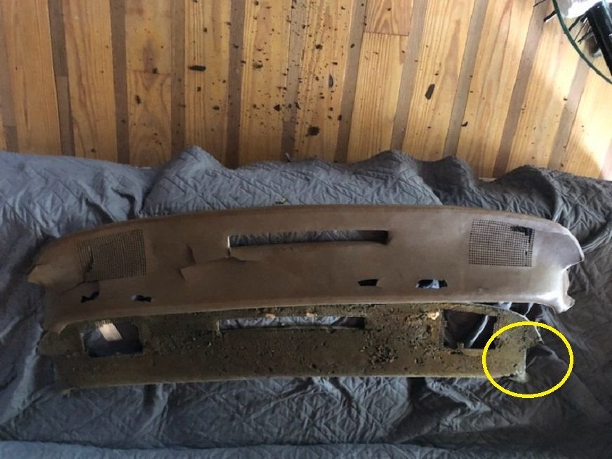

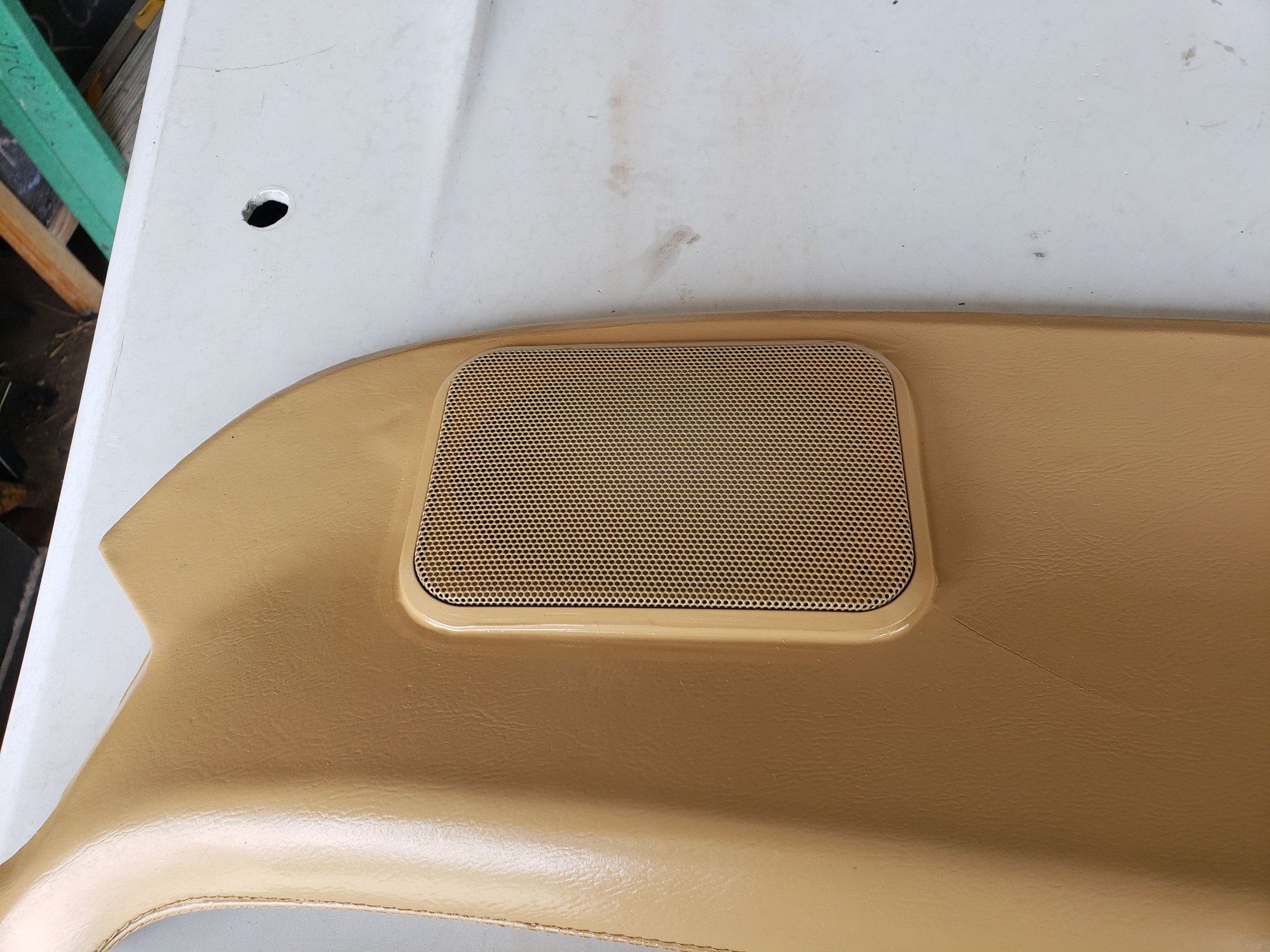

honestly the only thing that was wrong with mine was the speaker grill area was cracked, not even bad enough to worry about,
Well I fixed that this morning, no using it now, you can clearly see I did a nice job on it. Peeled, tore, dismantled, destroyed a decent cover
There is one spot on passenger side right at the stitching that had a void behind the cover, working on something to fill that small area.
I laid the Elk over the dash and smoothed it out by hand to get an idea. I think it will turn out nicely.
Will be filling in the speaker holes as I don't need the front speakers, doing a radio delete, (rare option haha) and adding 3 gauges in that spot.
Will use Bluetooth speakers in back & just run off my phone. Keeping it simple
The top of dash looks really bad but the leather covers it up & is smooth. have to be careful stripping the cover to not tear the foam under it.
Took about an hour working gently on it.
Since these dashes are a bit difficult to remove & install (at least with windshield in) I am going to trim off about 3/16" off each side where the little points are, this should
make installation much much easier & you won't really notice it since the edges are tucked in fairly tight to the windshield pillars.
Plastic was already cracked so will make an aluminum crutch to help it.

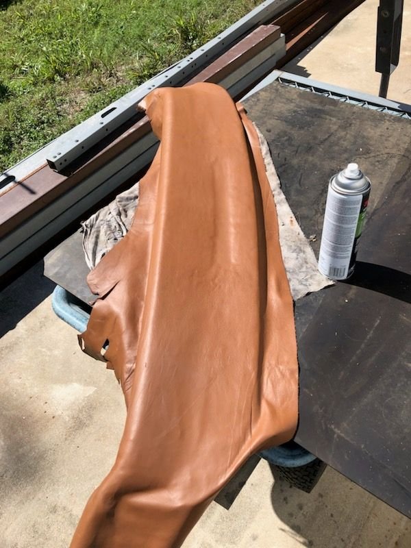

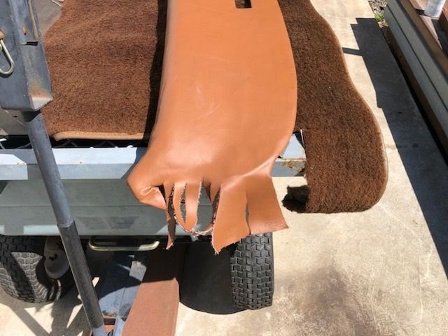

I bought a piece of Elk hide/leather brownish in color, a bit to much red in it, going to use
it at this point.

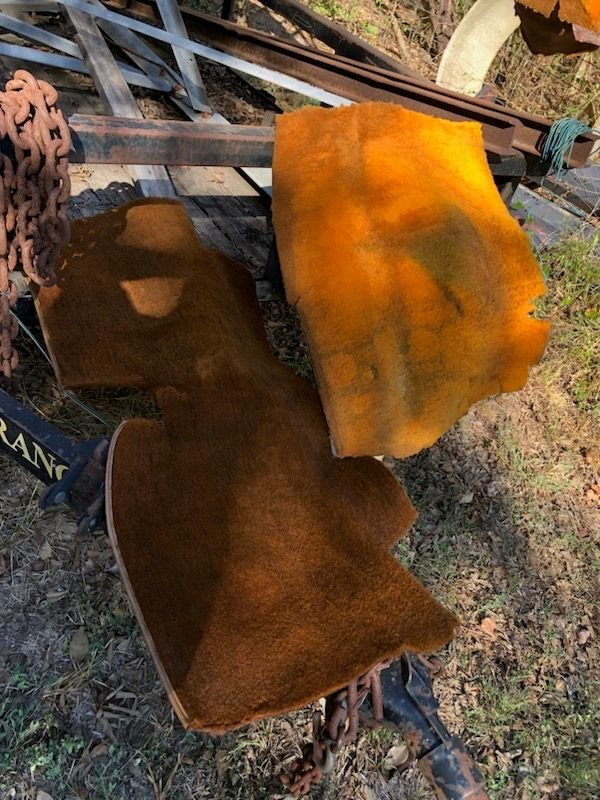

Also have been dying my carpets as they had faded to an ugly orange, not sure how that happened as the car has been undercover & out of sunlight
Carpet on left has 2 coats of brown, if I bend the carpet back on itself I still see orange so another spray of dye will be applied as the carpet is bent back
to expose the the roots so to say.
Elk hide on right, I bought way to much, so I will most likely use it throughout the front area, pillars, upper pad, the inserts by the door pulls.
Hopefully it turns out fairly nice, if not it's not to big a deal as it's just going to be a driver.
picture of the ugly orange compared to 1 coat of dye, dramatic difference, you can still see a tint of orange on the left piece

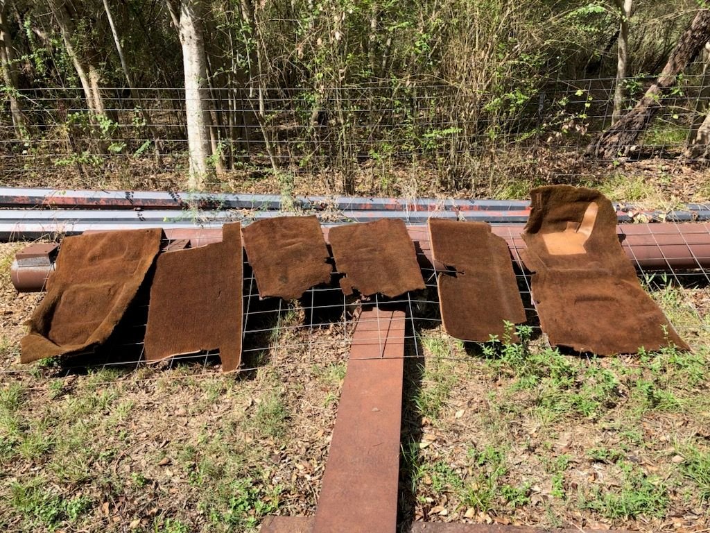

here is the final color of carpeting, still another coat to do on the 2 front pieces, & the 3 rear compartment doors came out decent
3 bottles of dye, some vinegar, & dish soap. = I'd say a cheap fix (under $20.00) & some time compared to purchasing new carpet

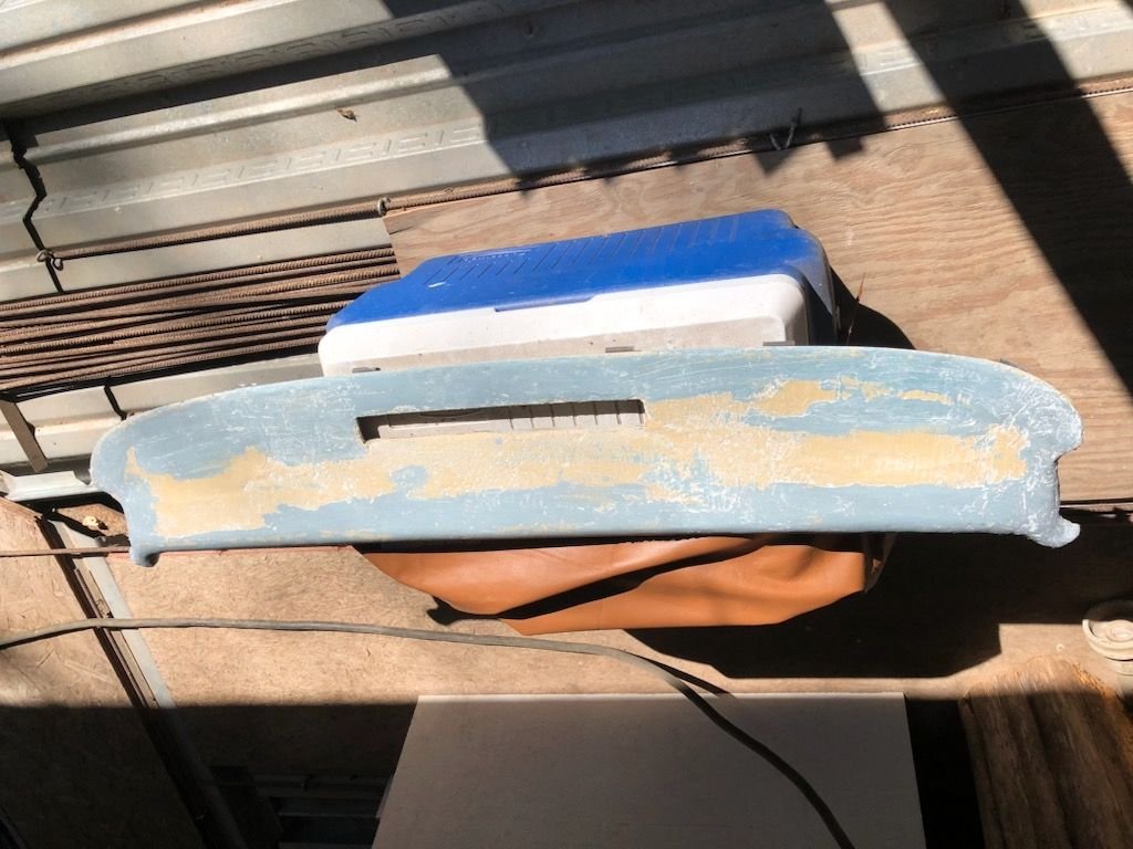

on to the upper dash, since it was cracked at some point that was my first area to address, my solution was to
put a crutch across a 12" section & clamp it together with small flat headed screws, I ended up using some scrap
perforated metal heated up with a torch to red hot and just pressing it into the plastic material, seems to have turned out
well & in addition I added hot melt glue to cover up the metal, between the foam on top & my Band-Aid the cover is rigid
again. while I had it like this I trimmed of just a small piece on each end so this will be much easier to install & if I ever
have to remove it I'll have a much easier time.

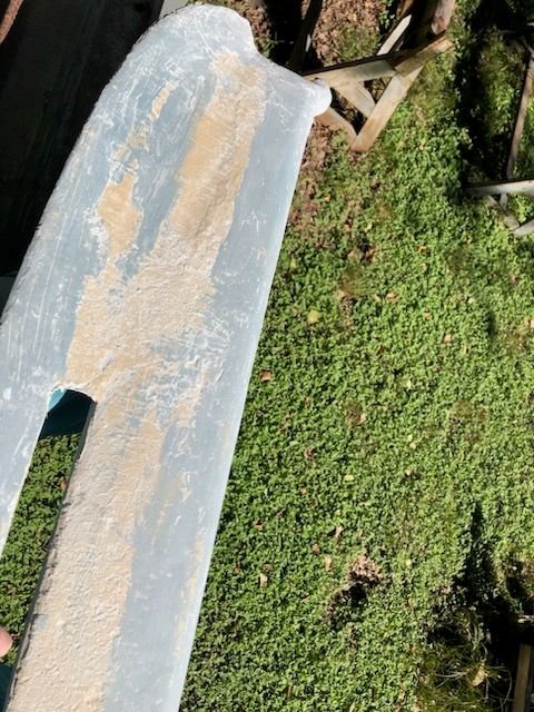

now on to the speaker holes = radio delete = gotta add $1000.00 to the value for that option
I used some .01 steel shim stock and fitted it to the bottom as a start = looks pretty ugly but serves
the purpose of support for filling the top side. jammed it under the 2 clips that attach to the windshield frame
& again hot melt glue to secure it in place.
on to the top side now.

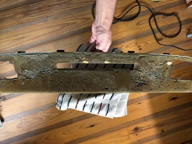

I tried using pieces of different thicknesses of foam / rubber for the top side of the speaker holes = it looked like that wasn't going
to work very good, looking around for junk = looking, looking = 2 choices spray foam or caulk, asked wife what she thought &
she said foam so I went with caulk. I opened a tube and smeared a little with a popsicle stick ( yep I'm cheap ) it started going on
very nicely, filling in all the small imperfections from when the dash was assembled, lots of voids under the vinal cover that never showed up.
Needless to say I covered the entire top with caulk ( yep some of you are thinking bubba, I agree ) I watched a guy on mytube that used bondo,
luckily I didn't have any or I most likely would have used that, BUT the caulk went on smooth, had time to work it into all the imperfections
you never see & there are many, filled the upped corners of the speaker holes to help secure the metal pieces in place.
couple pictures to this point so far.
waiting for it to harden overnight & will hit it with a touch of sand paper to knock off a couple whiskers of foam that poked up.
As rough as it looks it is much smoother than what was there after I removed the vinyl covering & I think it might add just a bit of strength to the dash.

Cut a piece of hide for the final covering, trying to get a the minor bends out where it has been folded, guy suggested
a heat gun, wife had no clue I put it in the dryer, maybe a bit of steam might help I can pull on it gentle and it smooths
out, I'll just have to watch as I install it.

A little update to the dash, caulk dried until Sunday, the glorified bondo arrived also, jumped on that ASAP
I guess it like a bondo product but has additives to make if flexible. I can push on the dash and it's still soft
The Polyvance is a bit expensive but cheaper than a new dash.
I couldn't get the caulk as smooth as I wanted it so I tried the poly, adhered nicely, you can feather the edges
Filled in the low spots & blended in the high spots, dried in 10 minutes of so, hard to see in the photos but it smoothed
out very nice, will touch it up 1 last time tomorrow, let it dry good & then start laying the hide on it.
With hide & without
Hard part is done

No I trimmed just a little bit off the pointy part. see picture where the little + is, I trimmed maybe 1/8" to 3/16 no more off each end, test fit & it slipped in easily just above that
small bracket on the windshield post when the hide is attached it will be a tighter fit but it will be so much easier. not sure why GM made it so close.

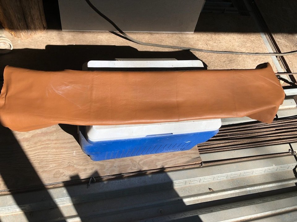

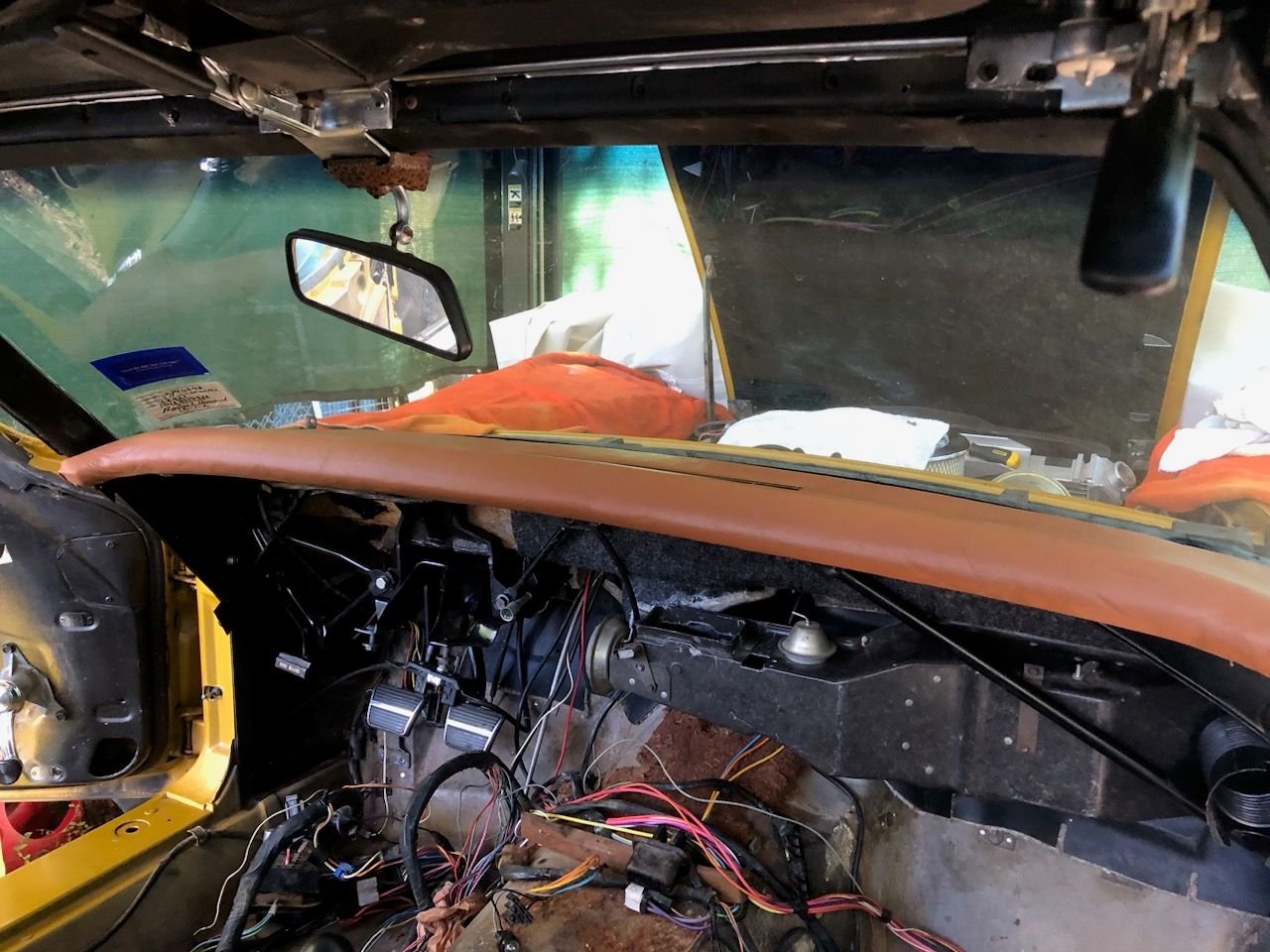

My update today is the hide is glued on, still have to finish the ends, defroster vent is in place, have to fix 2 tabs once more
Should have spent another 30 bucks on another can of the polyvance I can see some slight bumps showing = good enough for a driver, the
next lucky person can pay for a new one if they want.
Not stock = don't care, just cleaned up and different. now to finish & get it going back together

Finished, slipped in so easy with just a little trim on the 2 points on the ends of dash
