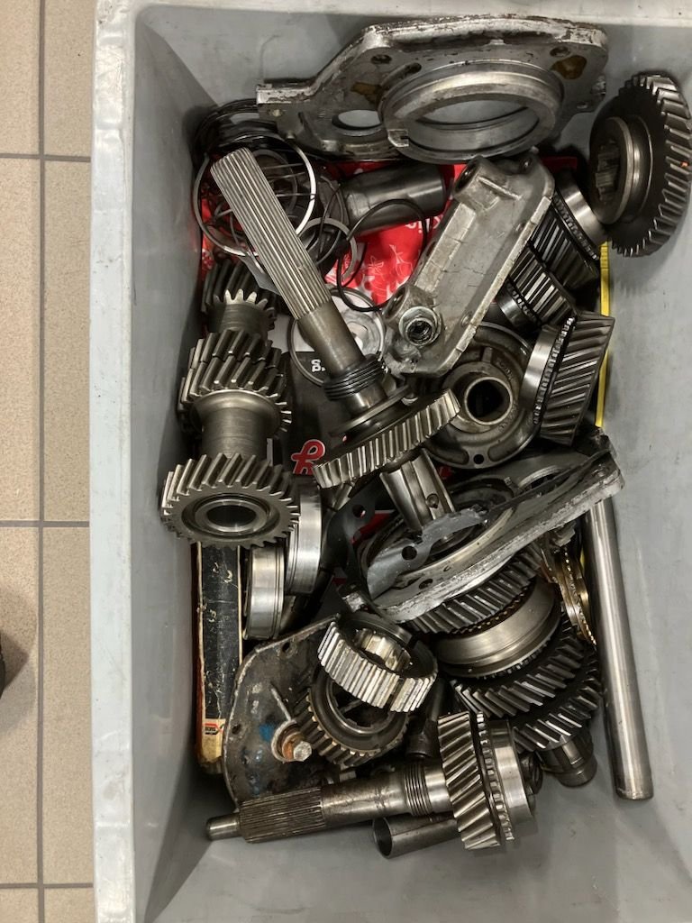

Can you help me Identify this muncie?

Looks to be an M-22, based on the 26 spline input shaft and the helix.

Where is the case? That's the easiest way to identify the year and model Muncie. Otherwise, you're basically guessing with just a mishmosh of parts stuffed in bins.
The helix maybe, but the rest of the gears?
There are one B (m21) case, and one without A B or C.
