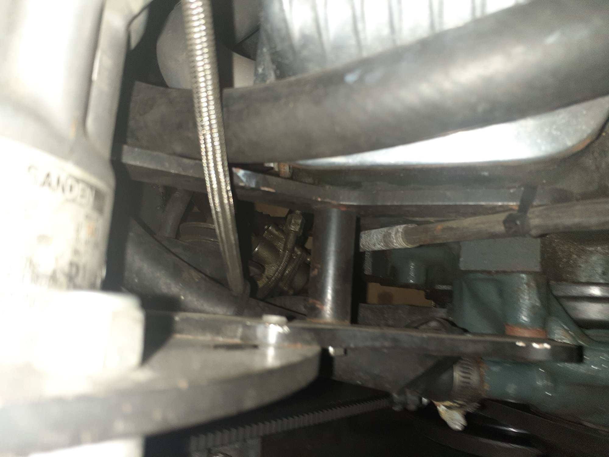

I used Allen Grove brackets for my sanden compressor. Headers are not a problem with them.

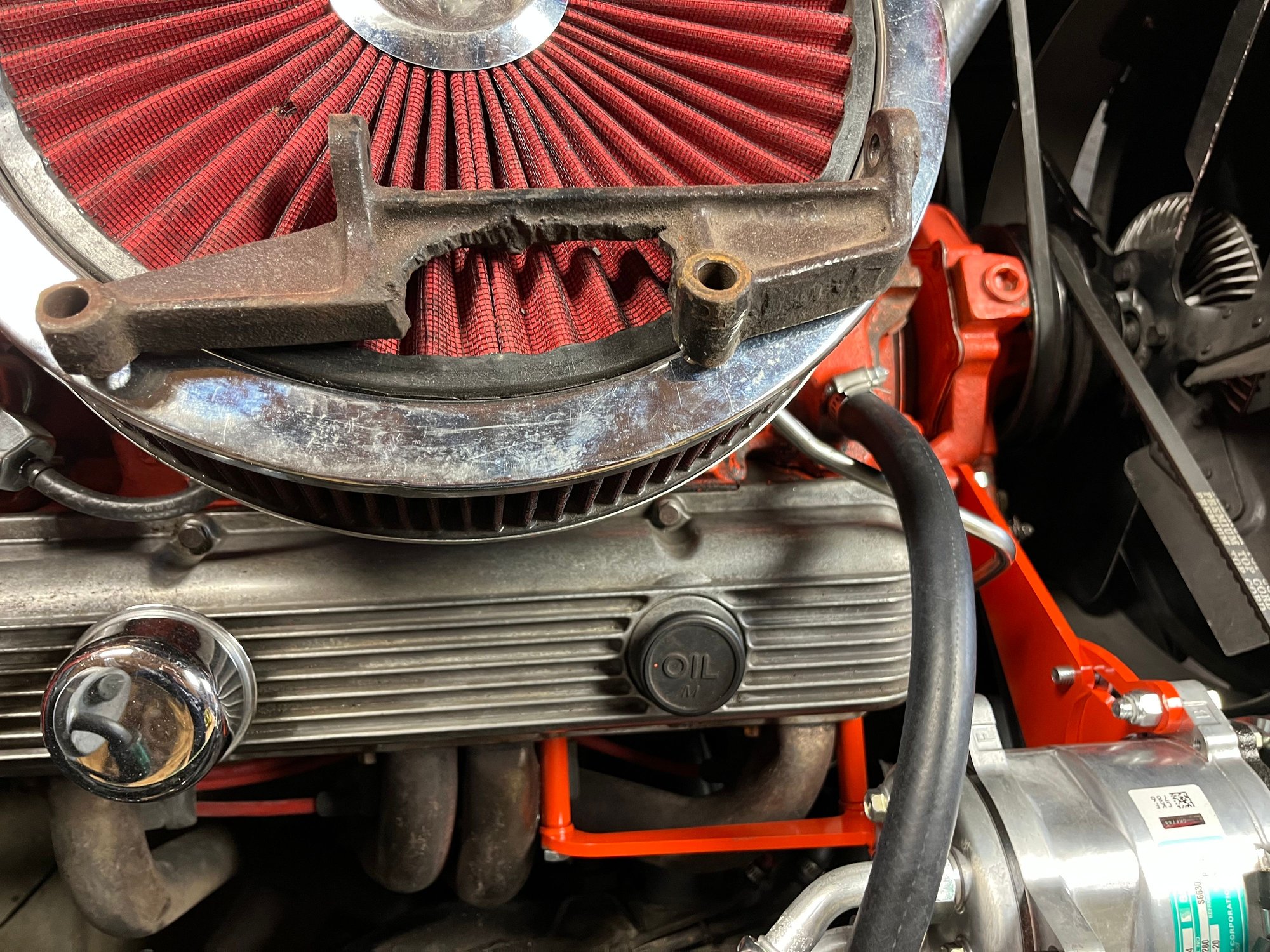

If your compressor is the same Sanden used by Vintage Air, they have a plain steel set of brackets that works pretty good.
(Ignore the Bubba-fied OEM bracket on top the air cleaner)

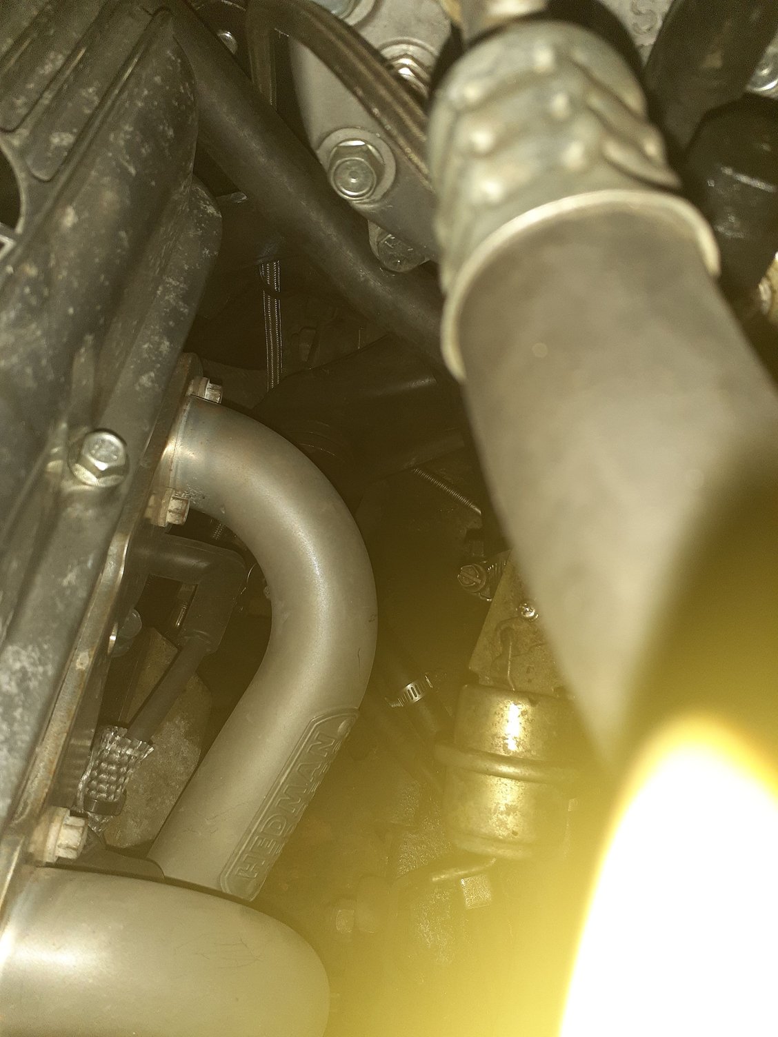

I used an Allen Grove bracket, but you are going to need a rear port compressor to make it fit. Getting a rear port manifold and the fittings was the hardest part for me.

My brackets don't attach to the exhaust. Mine has 1 bracket against the head which bolts to rear mounts on the compressor along with the bracket attached to the water pump.
