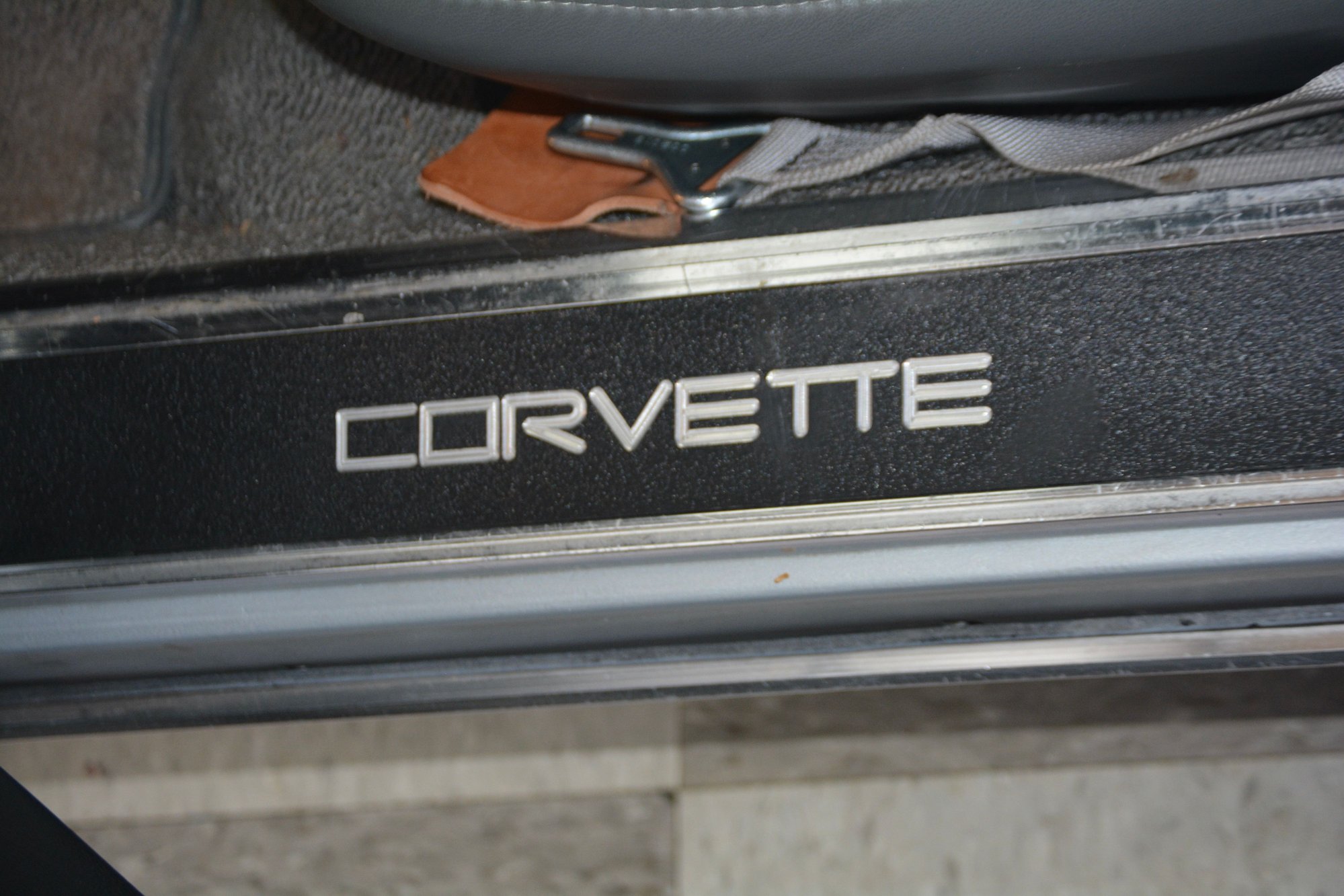

Mine were pretty badly scratched and I thought if I polished them they would show scratches again fairly quickly. I sand blasted them which left a uniform matt finish and then put clear coat on to stop corrosion. They still look good (to me) 4 years later.

Do you have any pics? I'm trying to figure out the best way to refinish mine.

Ah, the sill plates changed in the later C3 years. Mine on my '69 are pretty wide.

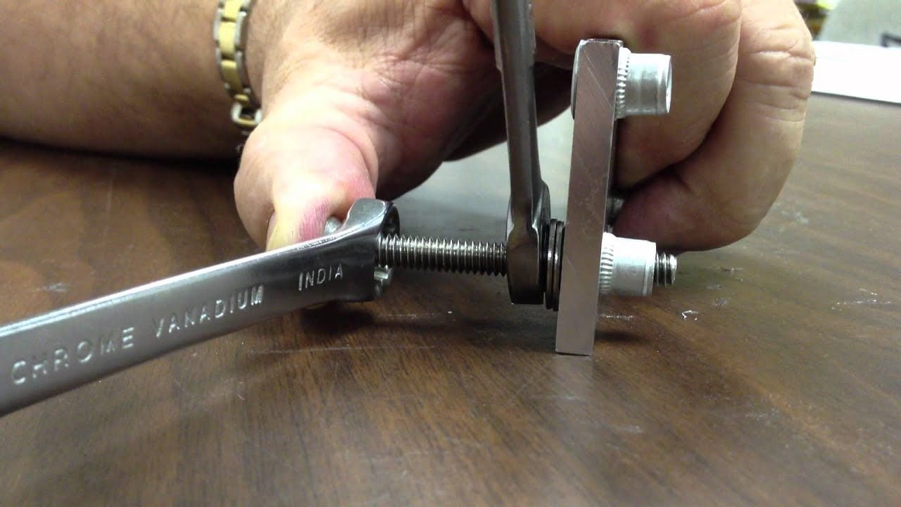

On the subject of sill plates, I have a question. Taking these on and off more than a few times, the fiberglass is mostly stripped. I have two sorts of inserts and am wondering if one is more acceptable than the other? The eight pictured are kind of like a drywall fastener. They expand to remain in place and take a 6-32 bolt. The single on the Apple logo is I guess what is called a "rivnut" and would require a little apoxy to hold it in place, Sort of liking the eight as no fooling around. Both require considerable enlargement of the existing holes. Any opinion on these or any other solutions to a better grip?

Six of one, half dozen of the other
If the "apple" one might be a nutsert or sometimes called rivnut
then they are installed like a pop-rivet and no epoxy or anything is needed. There is a tool but you can install them with a bolt and a spacer / washer stack. I like them in places were the material isn't really thick enough to get more than a couple of threads. Easily found in aluminum but stainless is available.

Thanks Mooser, but I don't think mine are supposed to install like that. Mine have a threaded front portion that is probably intended to screw in, although being aluminum, wood is all I can guess. Also they don't have a very big lip to engage fiberglass.
The deciding factor was I couldn't find a button head 6/32 black oxide bolt with a big enough head to not fall through the exising holes in the sill plate, whereas the single retainer pictured needs 10/32, which works. The stupid part is I got these at my hardware store and there is always some "don't give a sh*t" guy that puts a different thread back where it don't belong, so I've got 6 of 8 of what I need. Shoulda looked, this is not the first time this has happened.
My plumbing store had pencils with the logo ".... where every job takes three trips". Always that way with fiddly bits!

I didn't see the threads on the end there. Normally the wood ones are really coarse threads on the outside to cut and bite into the wood.
For the bolt with a larger diameter head, check for a pan washer head or button flange head (they call them all kinds of things but some version of that usually comes up with results.
Might be something you can work with
