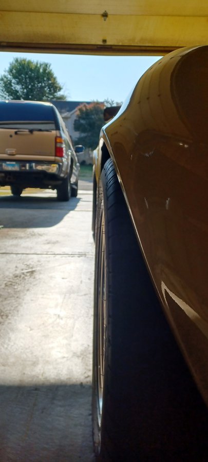

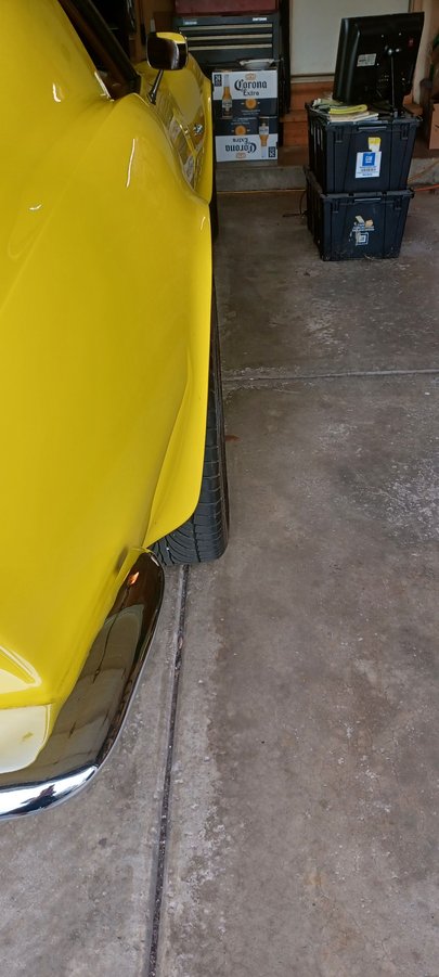

I'm running 255/50/17. No modifications whatsoever. As for rubbing, slightly AT FULL LOCK. There for, I never turn full lock.

4.07. American Racing VN2157861 https://www.summitracing.com/parts/a...57861#overview
I also used hub centric rings as the TT II are lug centric.
