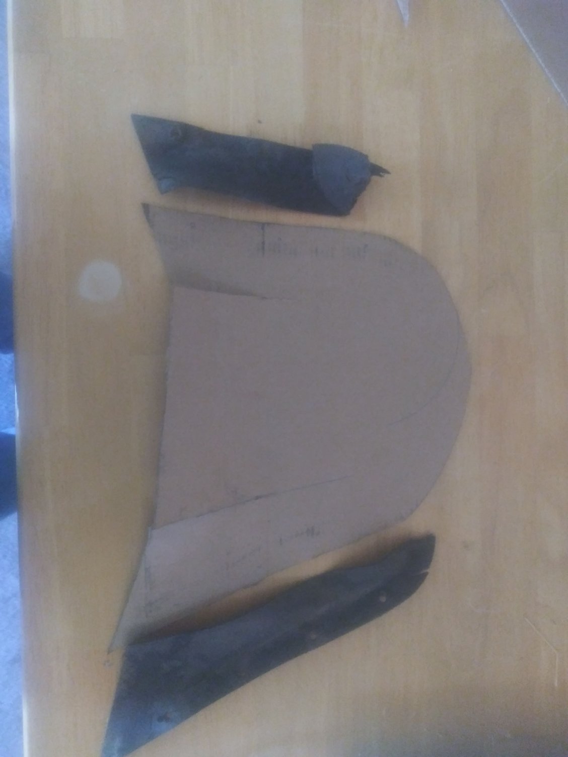

With a lot of luck, old pieces of dust covers and different radius plates, bowls, lids and whatever else I could find I made a cardboard template that is very close to the original curve around the top . I also measured distances of existing holes to help align everything.
Now I just have to get some 1/8" thick rubber and nuts and bolts to attach it

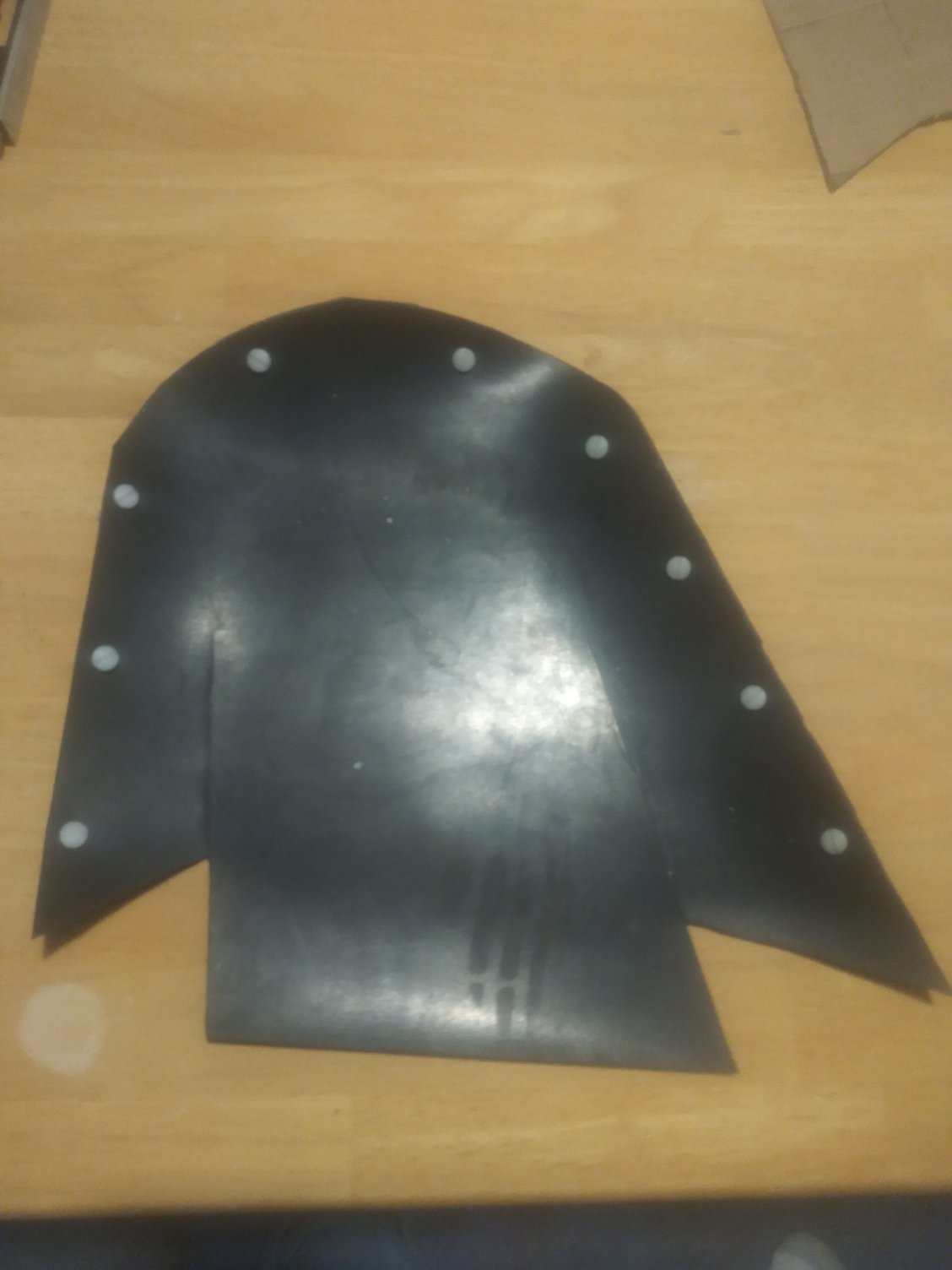

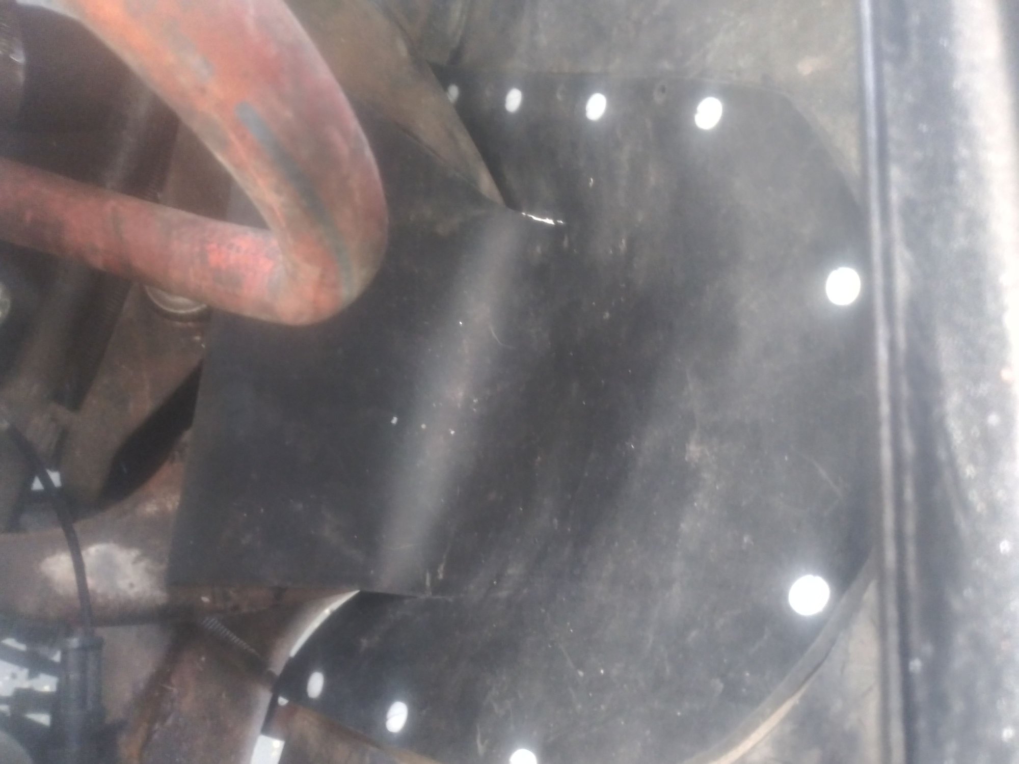

I bought a 12"x24" piece of rubber from my local home improvement store and plastic screws and nuts so they wouldn't rust . Cut them to my homemade pattern , drilled 1/4" holes on the rear side (3 holes) in then marked the holes a couple at a time to ensure proper alignment.
Total cost was about $15 - about same as replacement shields but didn't have to pay shipping , and the material is twice as thick as original and I think it will last much longer than the originals which feel like they're made from thick paper.
