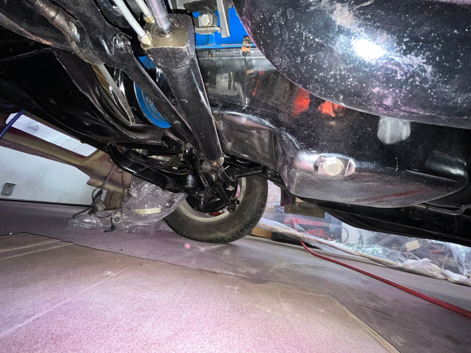

I installed a 350 small block in my 1980 Vette and the stabilizer and drag link are rubbing on the oil pan. Is there a low profile oil pan I can install or does anyone have a better idea on how to correct this? Thanks

yes, vette pan is needed.
orig eng is where?

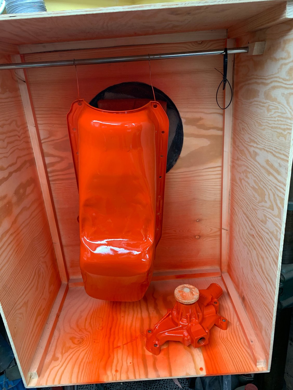

I've been looking for a "low profile" pan with no luck. What should I be searching. OEM oil pan maybe???

What does the current pan look like.....?
Vette pan definitely fits but requires a new pickup......it is different....it is also a much better pan as far as oil control......

That does not look like a Corvette pan. Whether it's a passenger car pan or an aftermarket one, if it's not a Corvette pan you will have clearance issues.
Before you buy another pan, what year is the 350 you put in your 80? 67-79 350's have a left (driver) side dipstick, while 80 and up 350's came with a right (passenger) side dipstick. The pans are not interchangeable, you can't use an early left side dipstick pan on a 80 up block, or a later pan on a 79 or earlier block. There's a left dipstick, 63-79 replacement pan available from most Corvette vendors for about $60-$70 dollars, and a replacement 80-85 right dipstick pan for about $130. If you buy a Corvette pan for the year block you have, you should be okay.

and looking at his pictures it looks like a fancy chrome pan was installed for more horse power = confused
