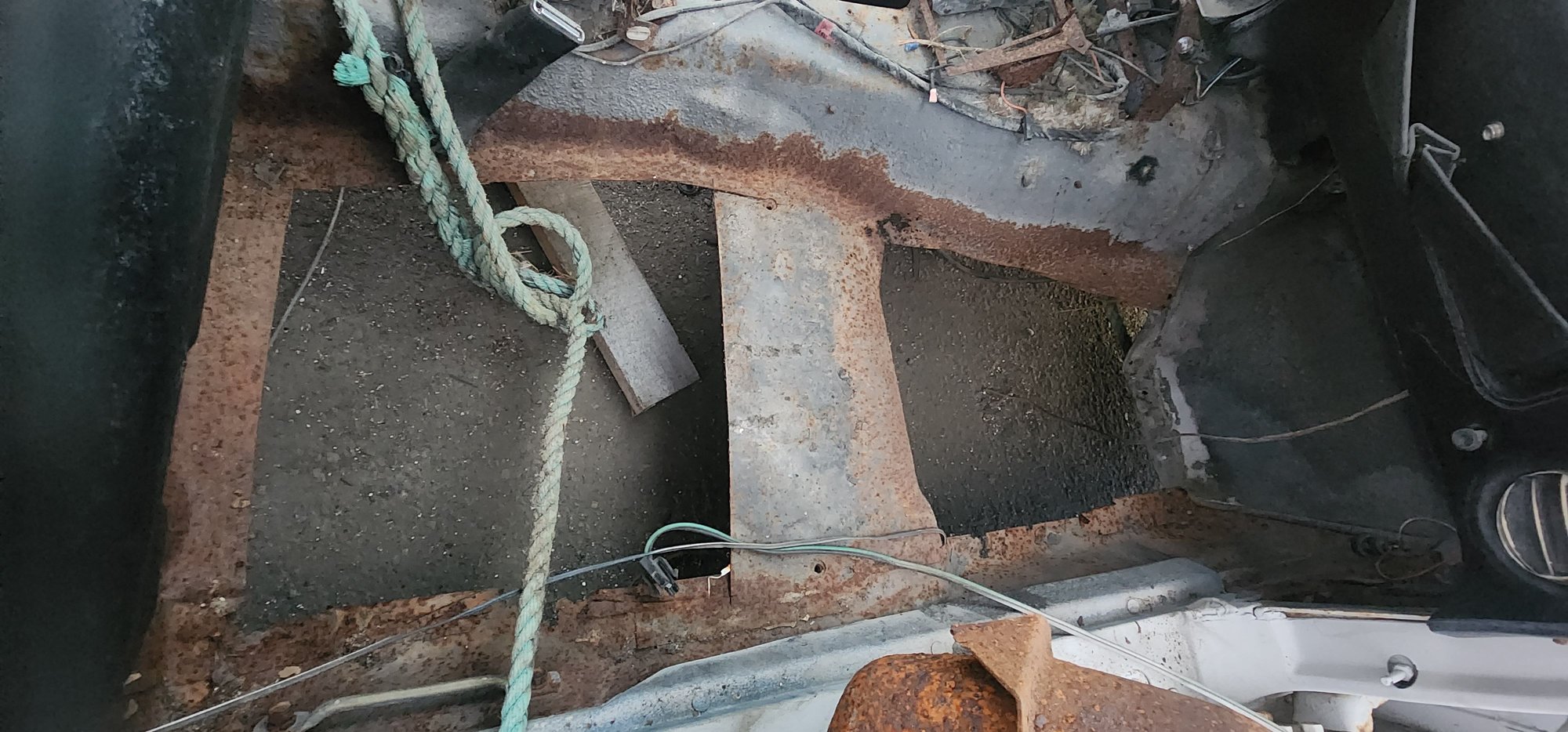

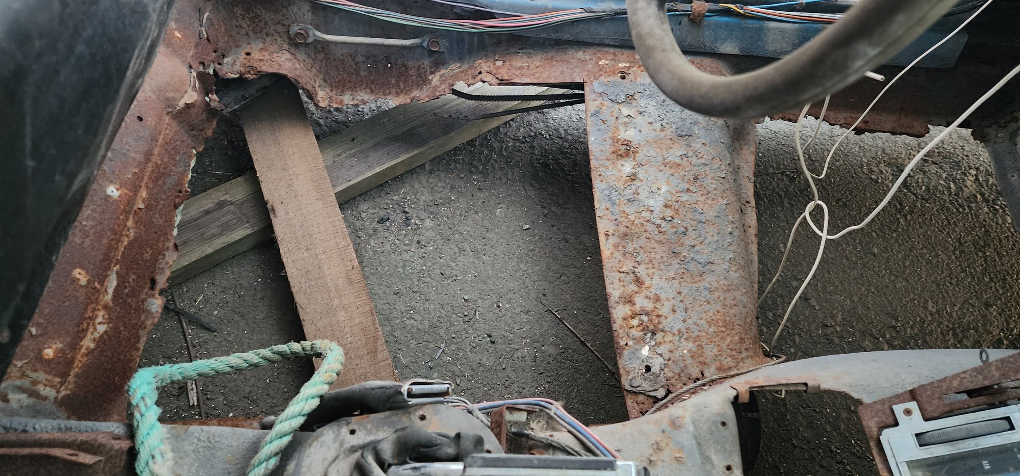

Here's photos of the floor. The stuff not cut out is in good condition.
If I ordered them from corvette central today its going to be 780$ Canadian shipped per floor pan 😢
Passenger floor
Drivers side
Drivers side

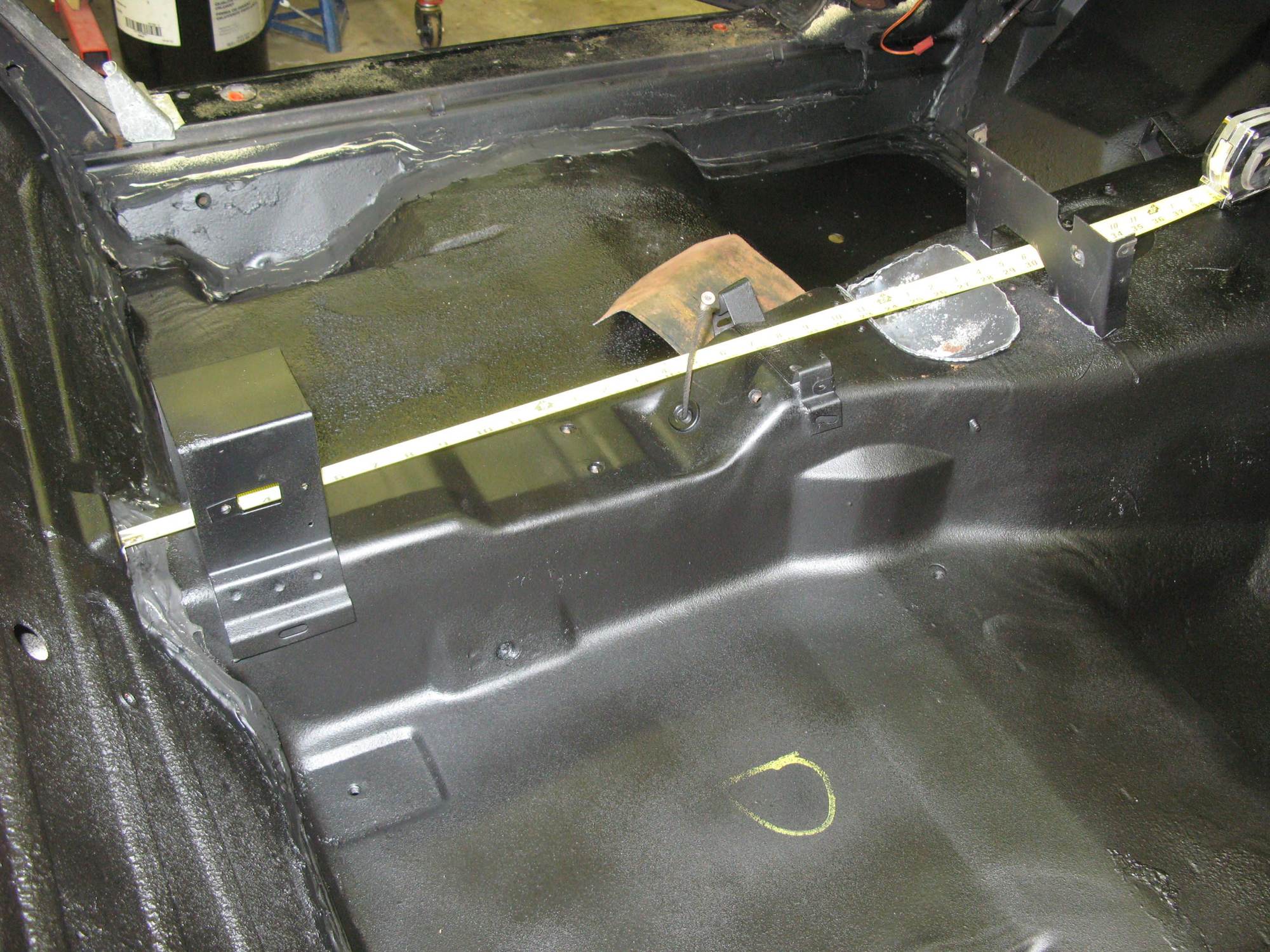

Oh wow. Not impossible though. I have pics of what the floor should look like. Use no thinner than 18ga steel. I'm thinking 16ga since is the floor. There will be some bends that need done and seat track attachments. Need clean metal to weld to and a MIG welder. Gut the interior. Dash & all. Nobody in Canada has those pans?

Looking closer, see just what they did. Cut 2 squares from each side and left the riser part there. Pretty much are just flat pieces you are dealing with. Not too bad.

Yea I have a welder and hoist to use, everything is mostly gutted anyways.
Im guessing all I really need is for the seat to mount correctly? and the seatbelts, then that it shouldn't be bad(famous last words). Im just going to try it and see where we get.

Seatbelt mounts are there. You just need the rear seat track mounting points. The front mount nuts are on the piece they left in the middle.

which is thin, but i can brace it/replace it on its own before doing the rest.
