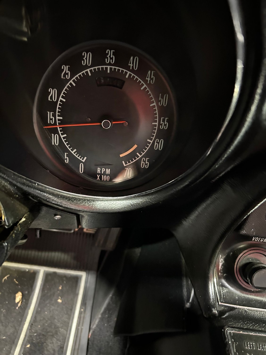

The tach has the orange line marked at 6300 RPM. Does that tell me anything about the engine?
None of these things are going to tell you about the engine by themselves.....but a combination of things will support the fact that it may or may not have had a big block in it.
The 427 L-71 tach redlined at 6500 rpm with the yellow warning starting at 6300rpm.....none of the tachs had a orange line starting at 6300rpm.

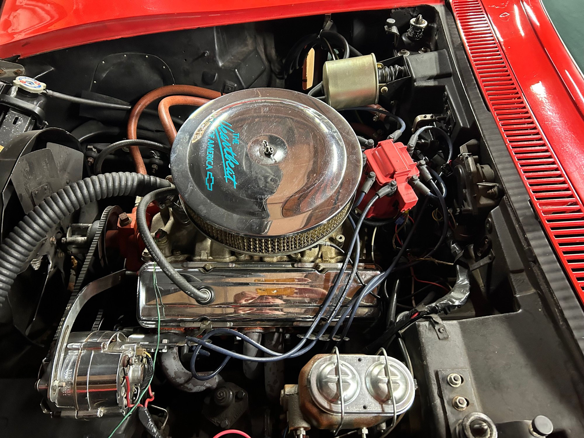

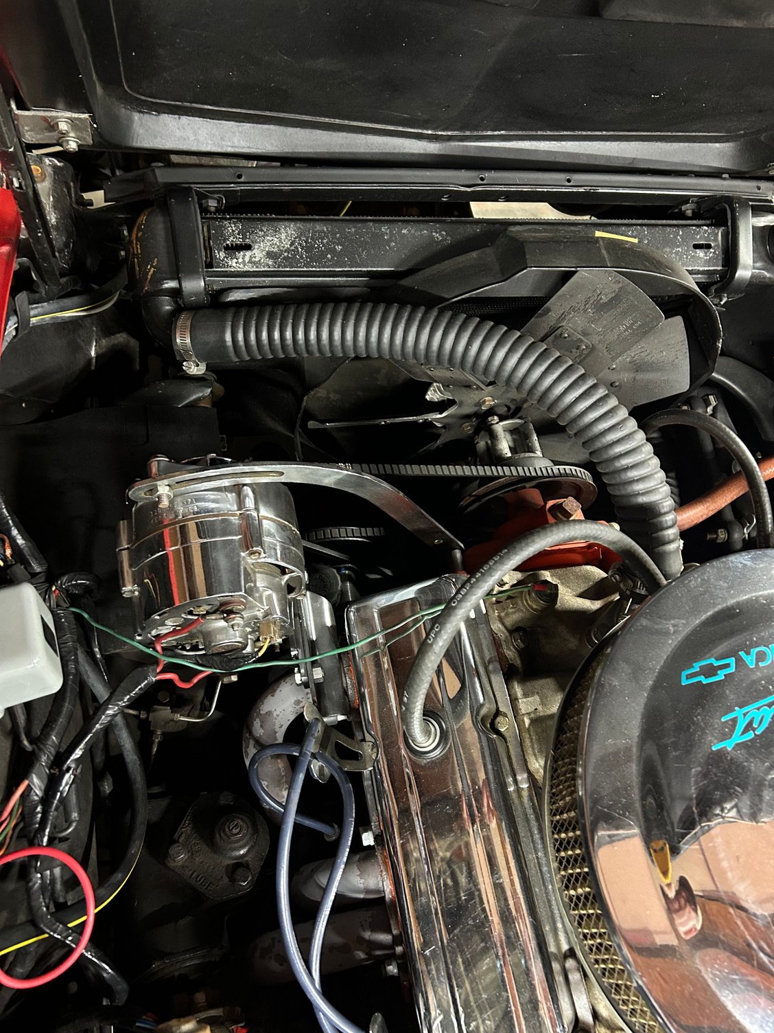

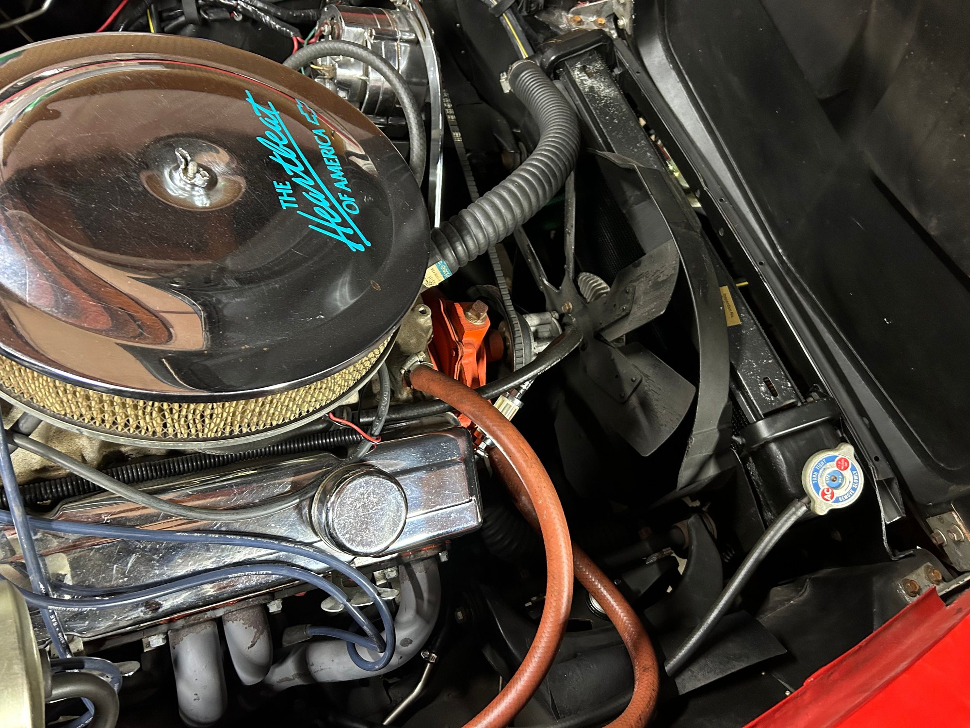

Here’s a few pics. Haven’t crawled under to check u joints. May need to jack it up for that. I guess I just want to know if I can swap it out for a big block easily. I think I have access to a 427 from a 66.
Here’s the tach. I found a receipt where it had been sent out for a modification to work with HEI distributor.

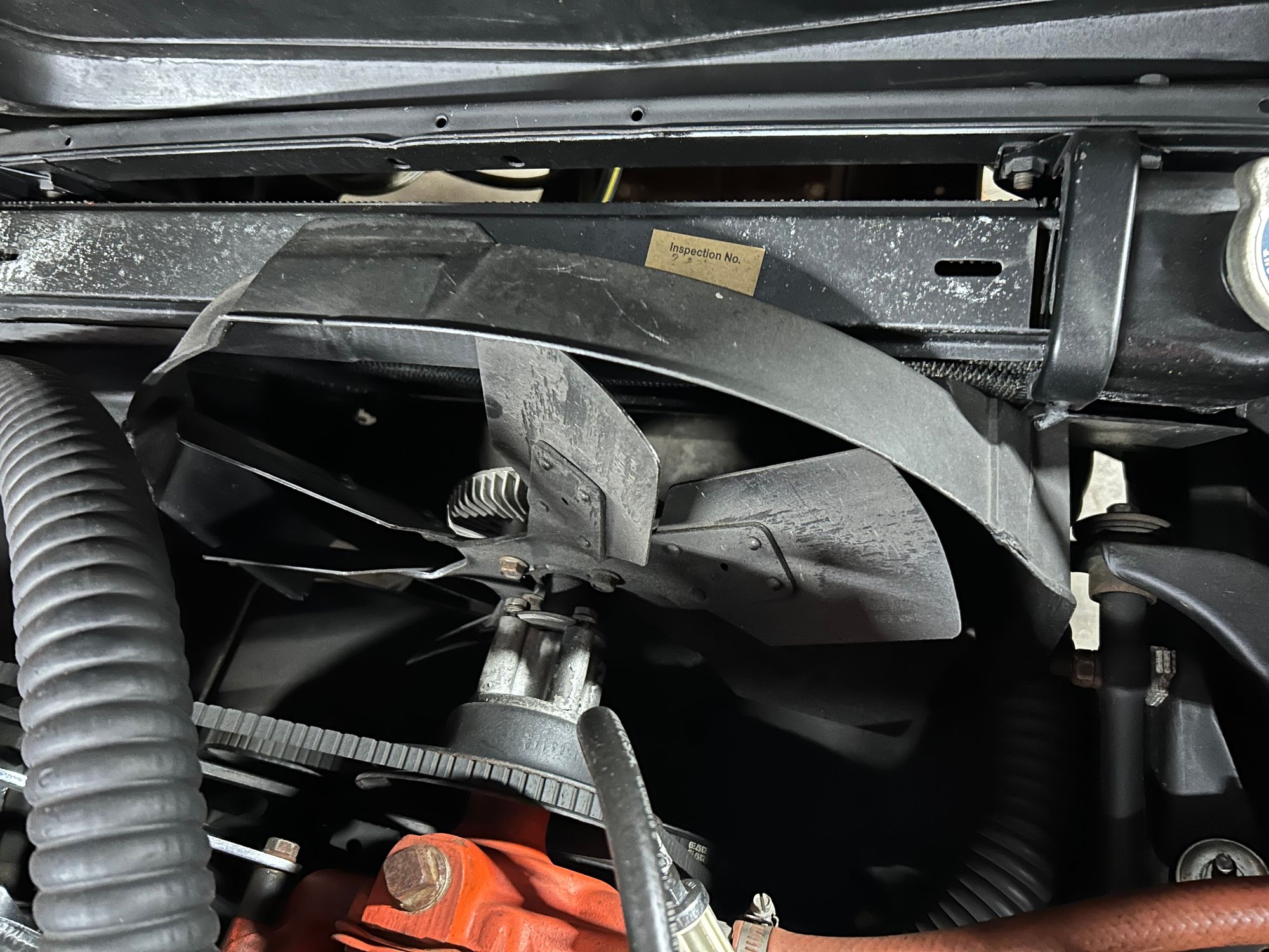

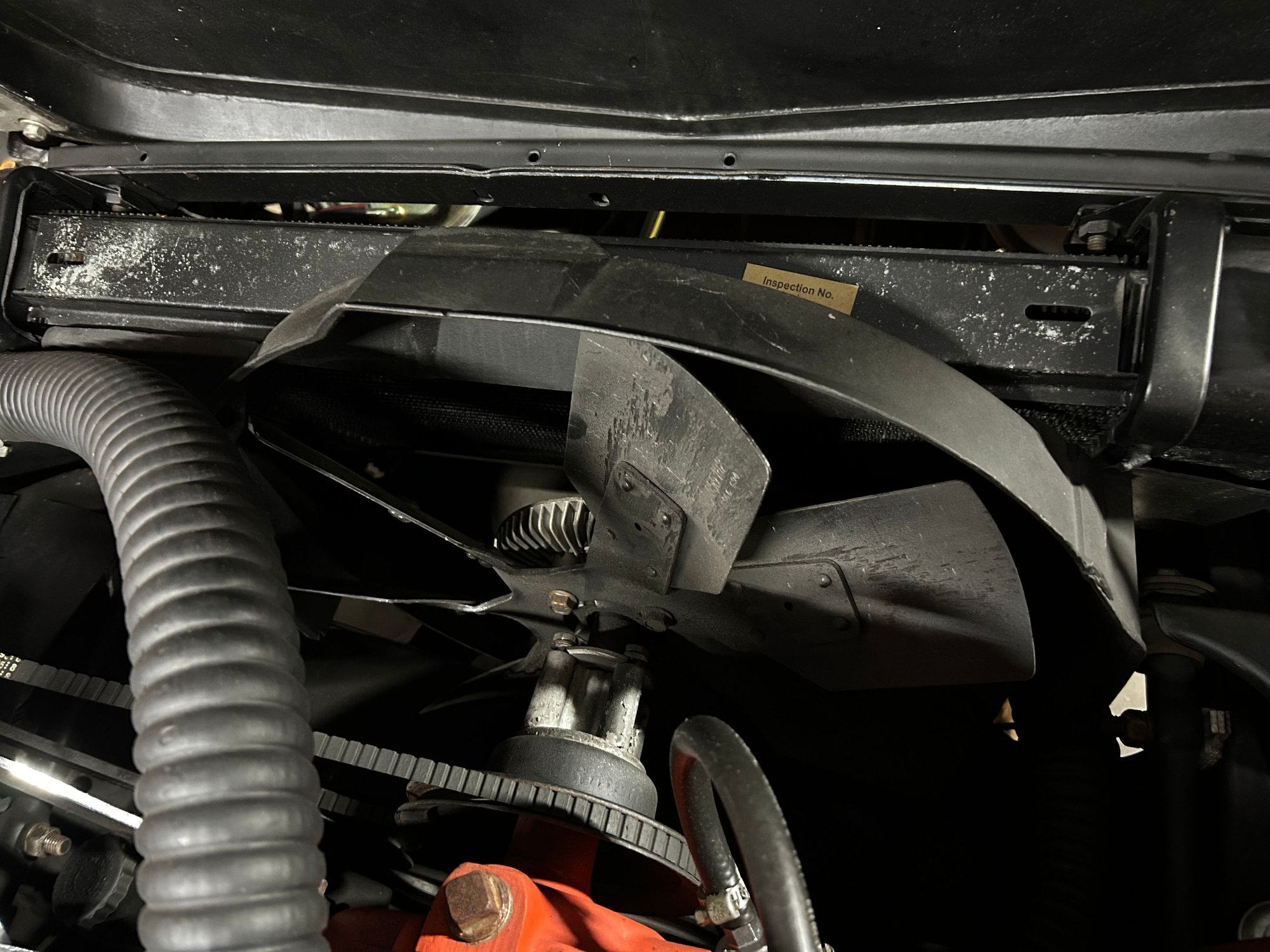

Fan shroud. Not sure the difference between large block or small.
