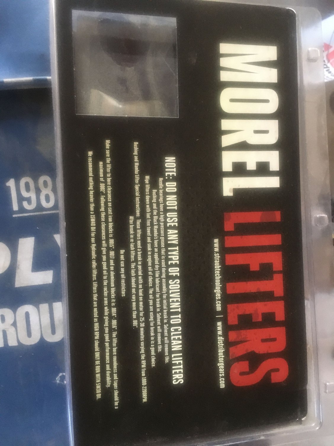

I’ve have had good luck with Morel hyd rollers although some think they are noisy

Morel’s hydraulic roller lifters were what was in mine when they put it on the dyno.
The lifters made so much noise, the builder shut down the engine, pulled the lifters and replaced them.

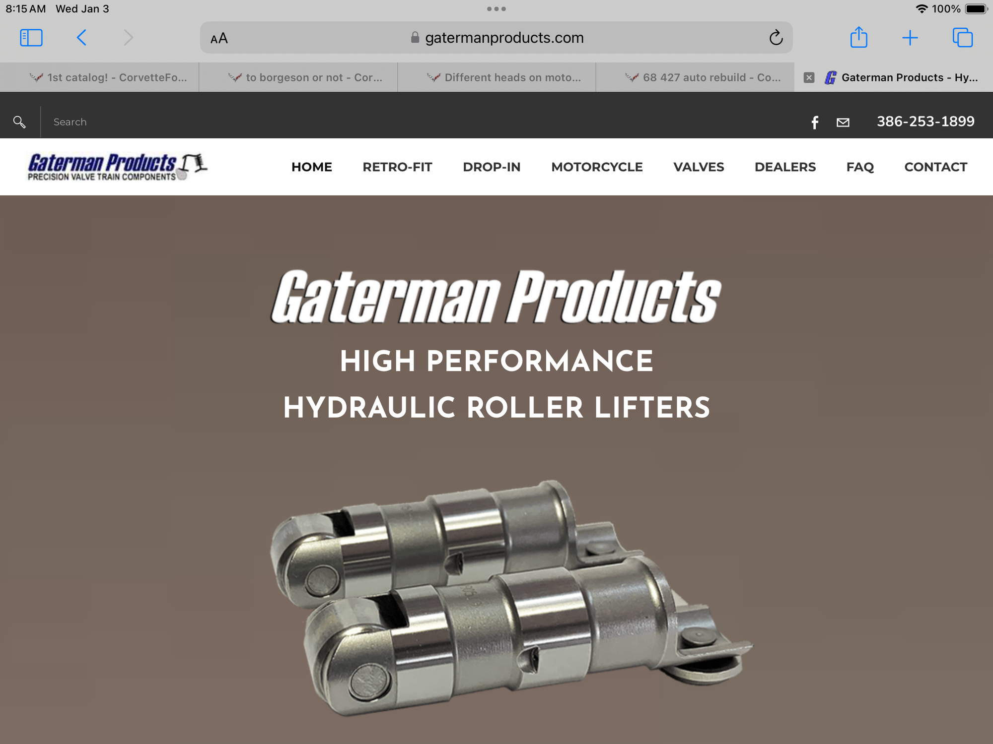

I talked with my engine builder and he recommends Gaterman Lifters.
He believes they are the best on the market now and doesn’t put anything else in his engine builds unless requested by the customer.
