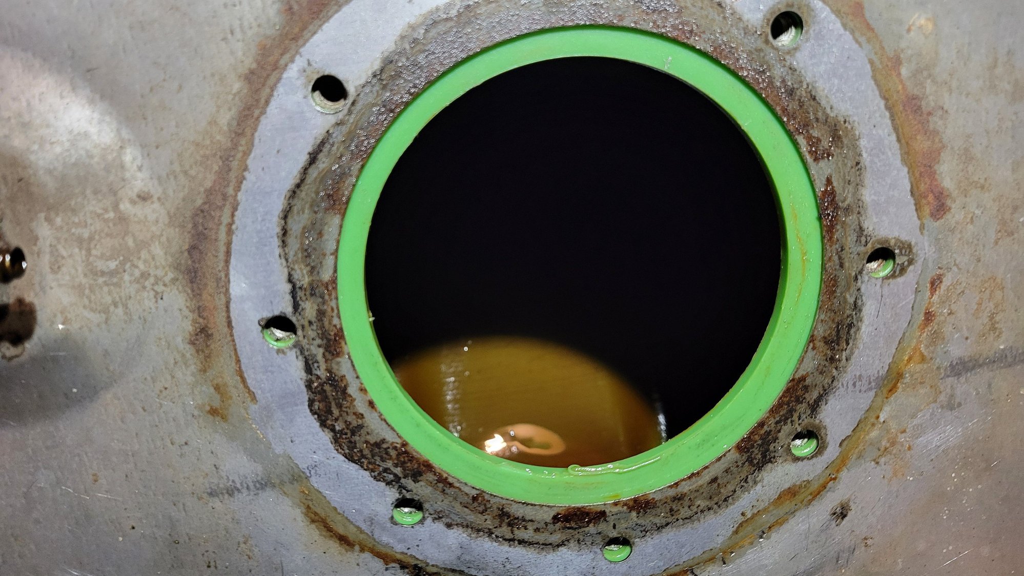

I finally got out the gas tank. It was simpler to cut the short rubber lines. They were extremely stiff, and did not want to come off the lines. The new lines are much more flexible.
With the tank out I was able to test the fuel sender. Nothing happens on the multimeter while moving the float. I'll get that ordered. I was worried about finding a bunch of rust in the tank. It turns out it has a heavy plastic liner. The area were gas has been sitting all these years is a bit discolored, but it seems fine.
Plastic liner.

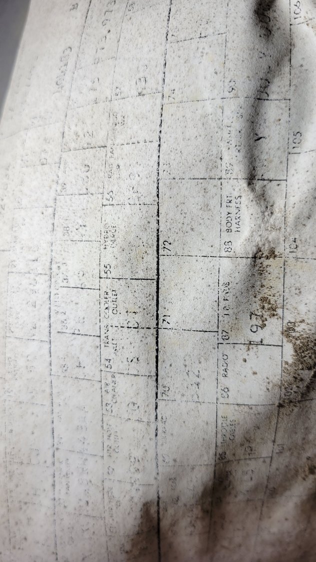

Found the build sheet. Can't really read it, but it's still cool.
No really legible.
Kansas. The car came with a Kansas dealership key ring.
Not much.

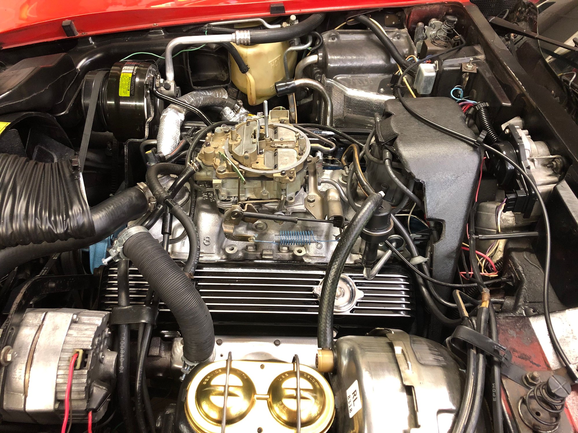

Does anyone have a good shot of their upper radiator hose routing? I'm replacing the coolant lines, and I don’t think this setup is correct. This looks like it might be sort of a universal hose. I think I have the proper hose, but it seems like it could be close to the fan and/or the alternator belt.
Thank you
Current hose routing.

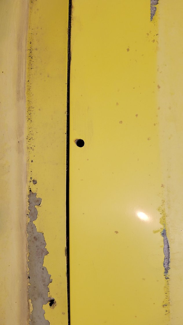

With the gas tank out, I found the bolts that hold on the spoiler. I took it off to clean the crud under it. The spoiler looks like it originally was also glued in place. Was it glued? There are a few more holes that look like I could add some more screws to keep it in place. Should I? It would involve drilling corresponding holes in the rear panel.
Additional bolt holes? Some of the glue(?) visible as well.
Corresponding hole in panel.
Thank you
That hose and routing are definitely not factory. Below is a picture of my car with a GM upper radiator hose and the proper routing. I found a pic with the air cleaner assembly removed so you can have a better looksee.
Note there are two different upper radiator hoses for 1979: 79E and 79L. I'm not sure when the change was made. I believe the only difference in the two hoses is 79L (which I have -- Aug '79 build) fits a larger radiator inlet. I noticed when I received my new DeWitts aluminum radiator (some 12 years ago) that the radiator inlet was made in such a way that it would accept either upper radiator hose, which saved me a potential headache.

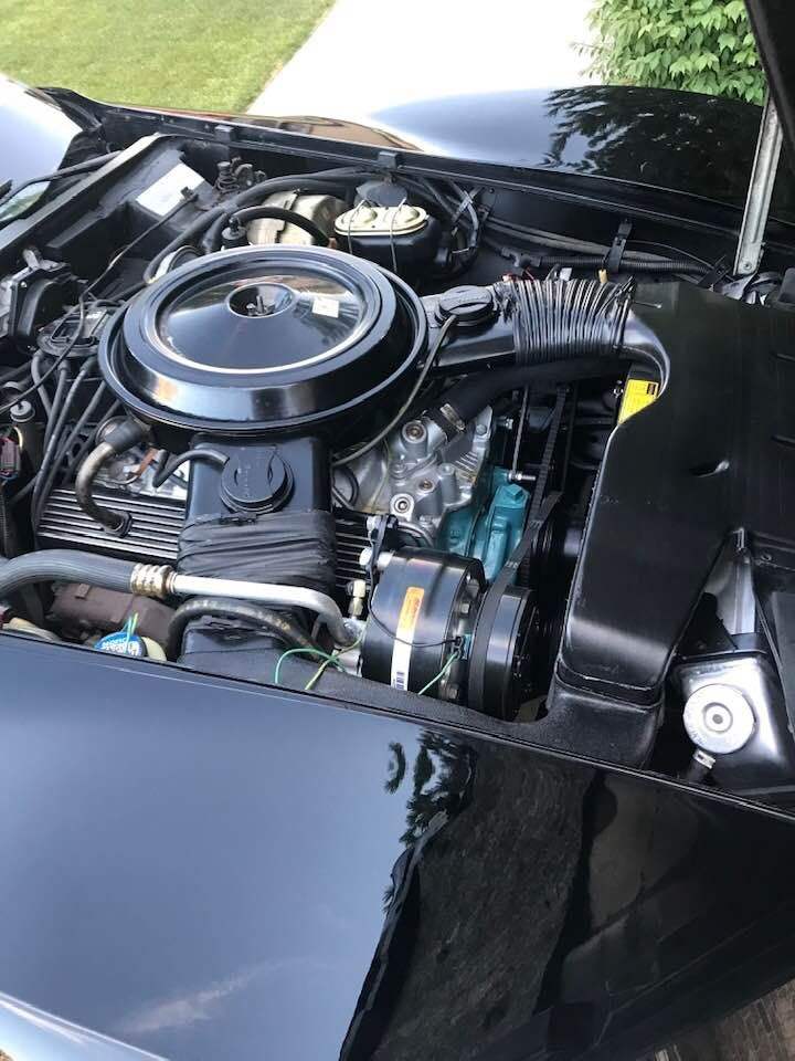

Here’s our setup. Views from both sides…
Driver’s side
Passenger side

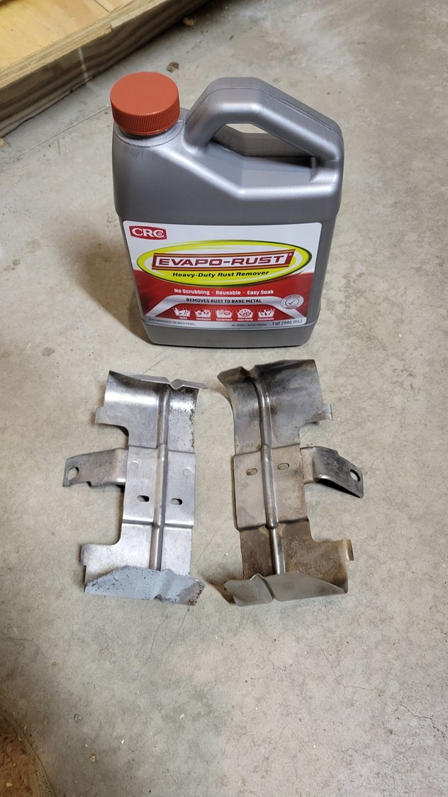

I finally found a decent surface rust remover. Carb parts cleaner didn't really get the rust, and wire wheels couldn't get into some spots. Wire wheels can make something "too shiny" if that makes sense.
This Evapo-rust kind of leaves some of that patina behind while disolving surface rust.
A before and after.

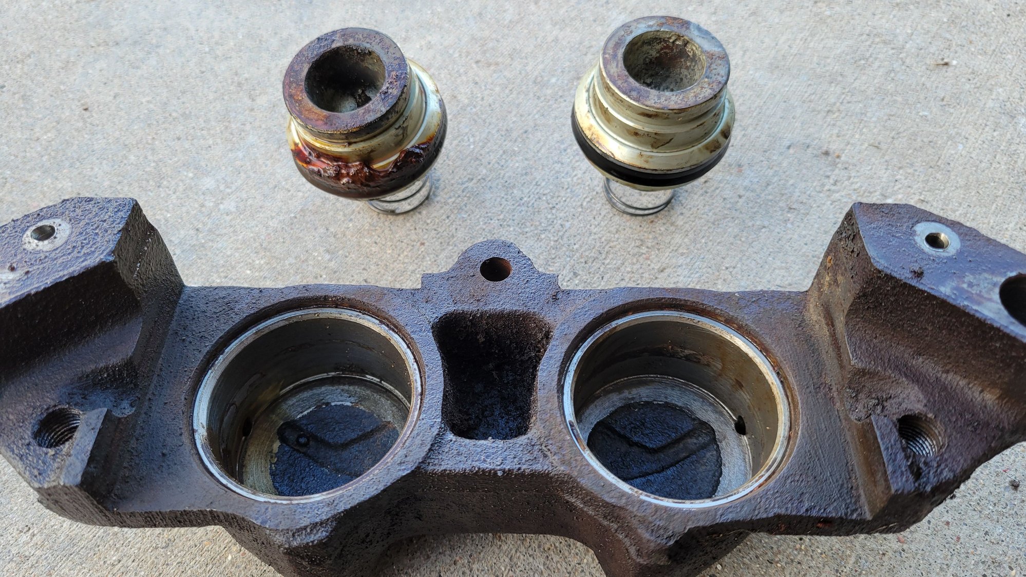

I opened the driver’s side front caliper today. I'm not sure, but I think it's gone. While the bores are shiny, they aren't smooth and have some rough spots. I can't tell if it has been sleeved. There is some rusty colored goo on some of the pistons which I assume is simply rust build up.
The hard and rubber lines didn't want to come apart, so it might be new hard lines as well.
Example of the bore.
Sample of the piston gunk and condition.
Hopefully good bore detail.
General. I tried some bronze scubbing on spots.
They don't appear sleeved to me. Stainless sleeves don't pit or become rough unless scratched or gouged. About the only thing you'll come across with sleeves is staining but the walls should still feel smooth.

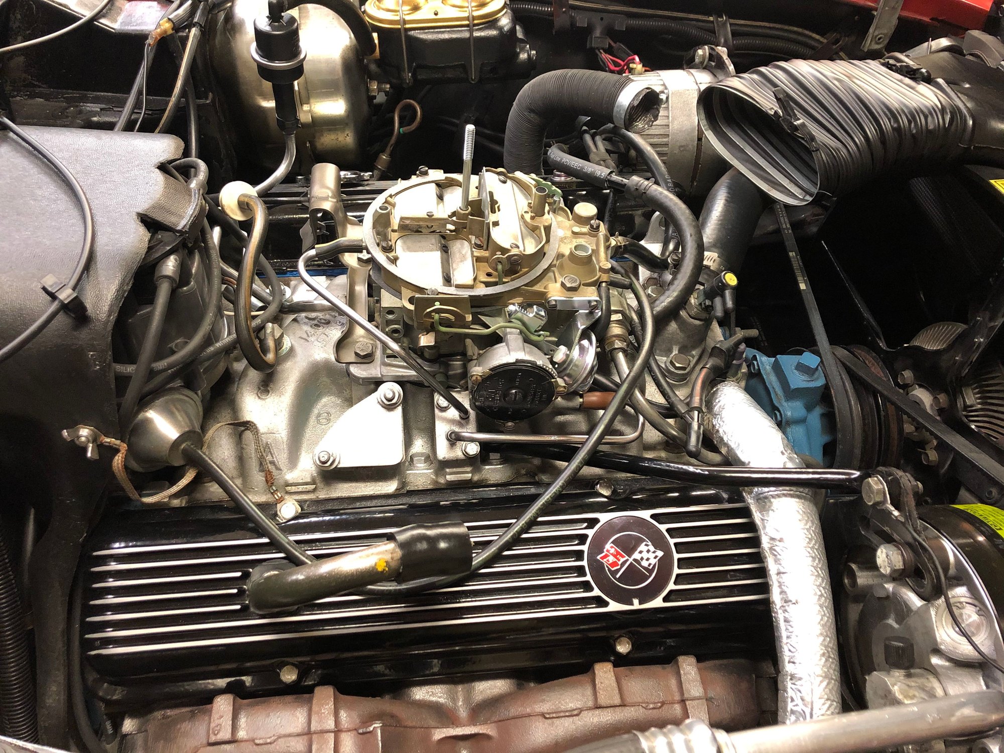

Thank you for this. I read one way to tell early vs late was the number of compartments in the back. I have three. I forget which is which but I ordered the matching hose. This one bells out a bit at the radiator end. Hope it's right. At least I'll now have a good idea how it fits.

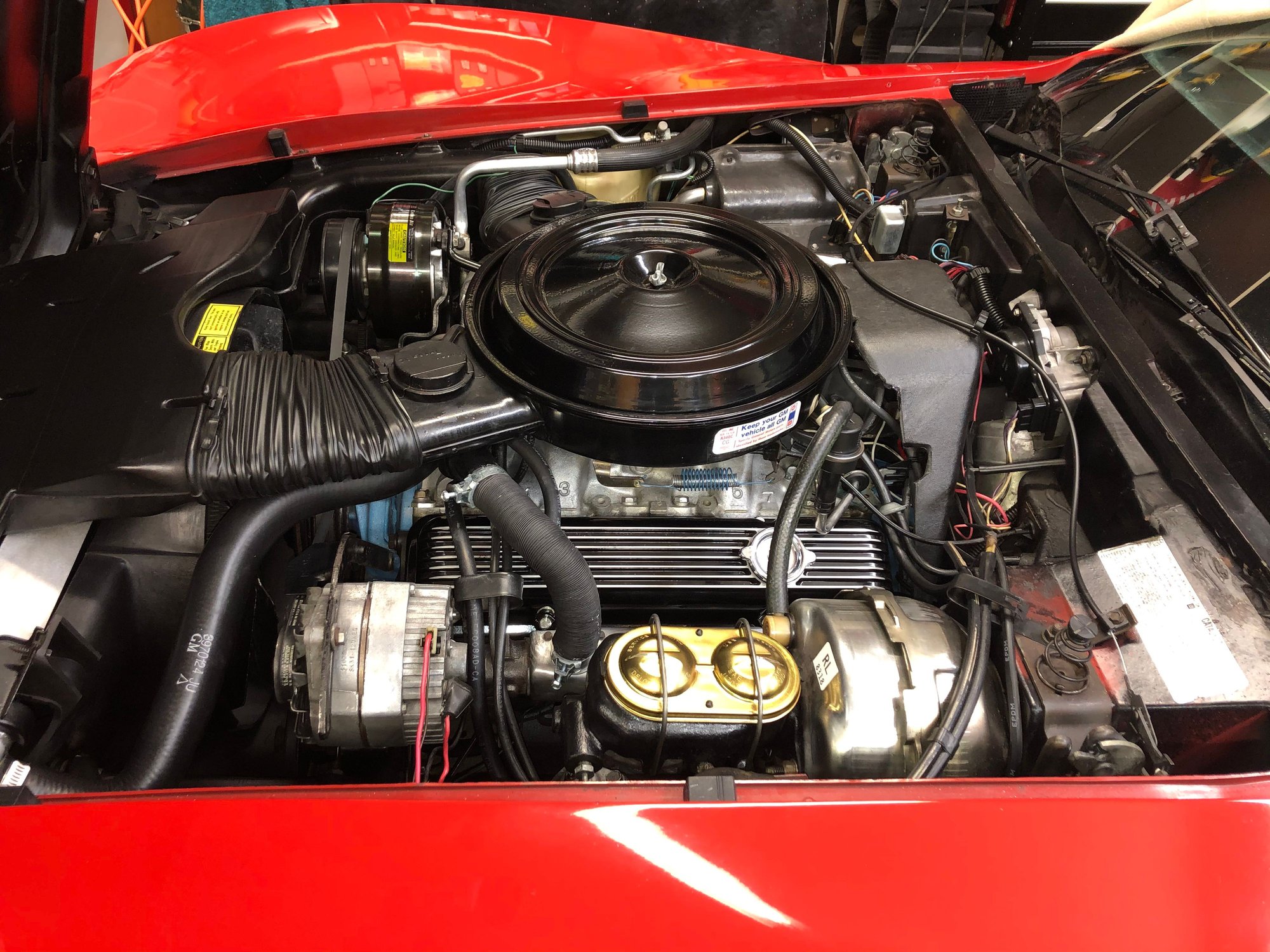

here is a november build 1978…79 l82 4sp original upper hose still..
if you get bored..the threads i started covers everything but engine removal on a 79 L82 and the help i got
So shiny...
Beautiful engine bay, Interpon. A great example to emulate as it looks like a time capsule. I suspect Mark's engine bay will appear similar in due time.
Very nice, I see a lot of my 79 L82 car with 17,000 miles in it. The one component I can't find is the original distributor shield, it was missing when I bought it.
