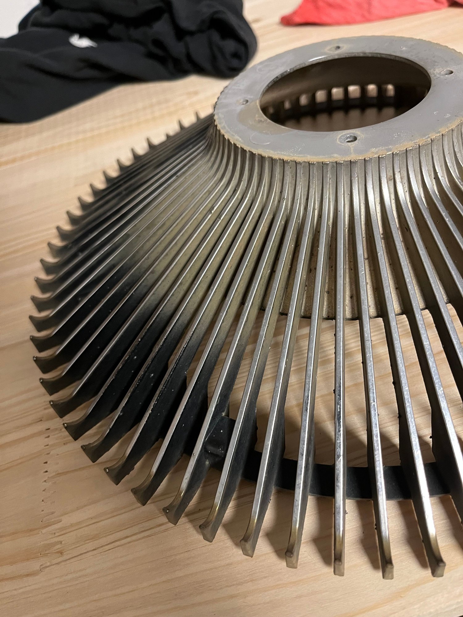

Hello together,
For a while now I've been wondering what exactly the paint job on the P02 hub cap looked like. I am particularly concerned with the inner part of the hubcap, the fins are black on the sides, but they fade considerably towards the top.
Most of the rim caps I have seen so far have not been painted in these intermediate areas. I wondered about this for a while, as it makes the painting and masking process extremely complicated. Until I took a closer look at my caps and found very little color here. I suspect the rest has been washed out over the years.
I found little evidence on the web that it was painted there. It looks like it on the brochures from the past but I can't confirm it for sure. The NCRS book also wasn't helpful.

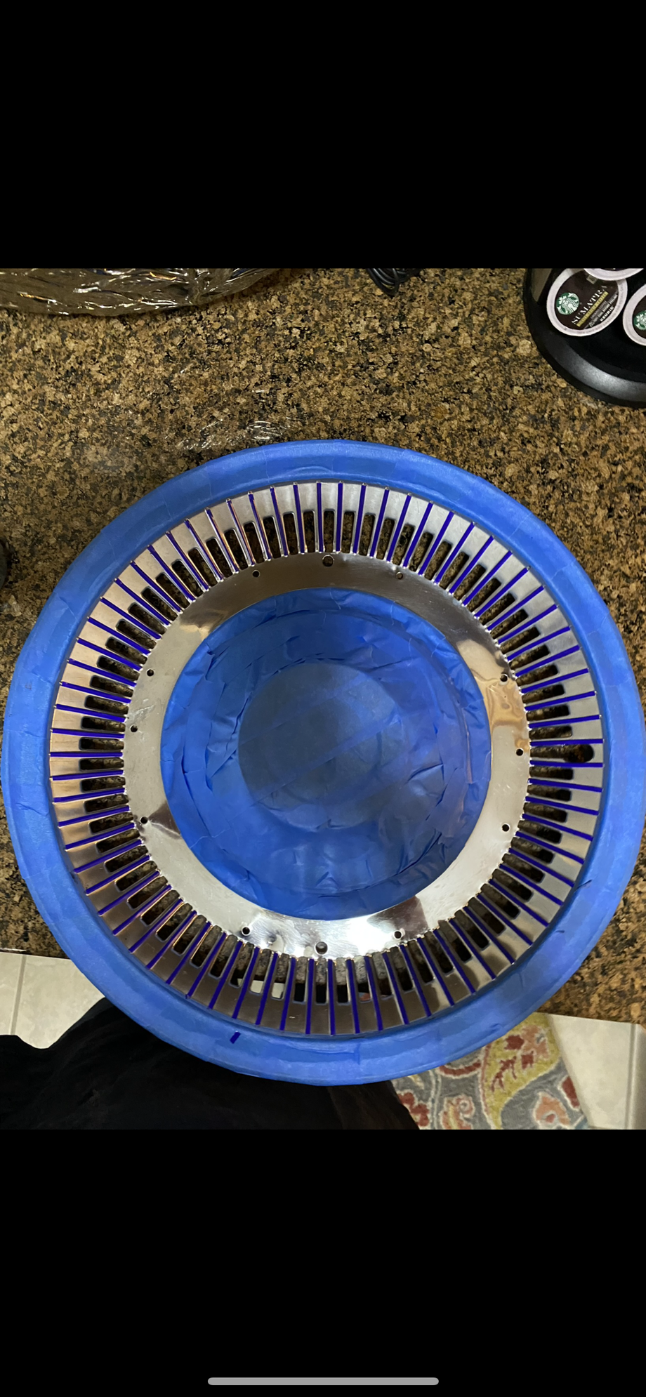

Old Dec 7, 2023 | 04:36 PM

As you can see, it looks like overspray, no consistency.

You have to use super narrow detail tape. You can get at Napa. If I remember, it comes in dark blue. There’s is examples how to tape the narrow parts on the forum. Just search P02 turbine hubcaps, and a bunch of search’s will come up
Old Dec 7, 2023 | 05:00 PM
Kaper220's Avatar
Kaper220
Joined: May 2011
Posts: 423
Likes: 93
From: Mechanicville NY
here is what the tape looks like on the P02

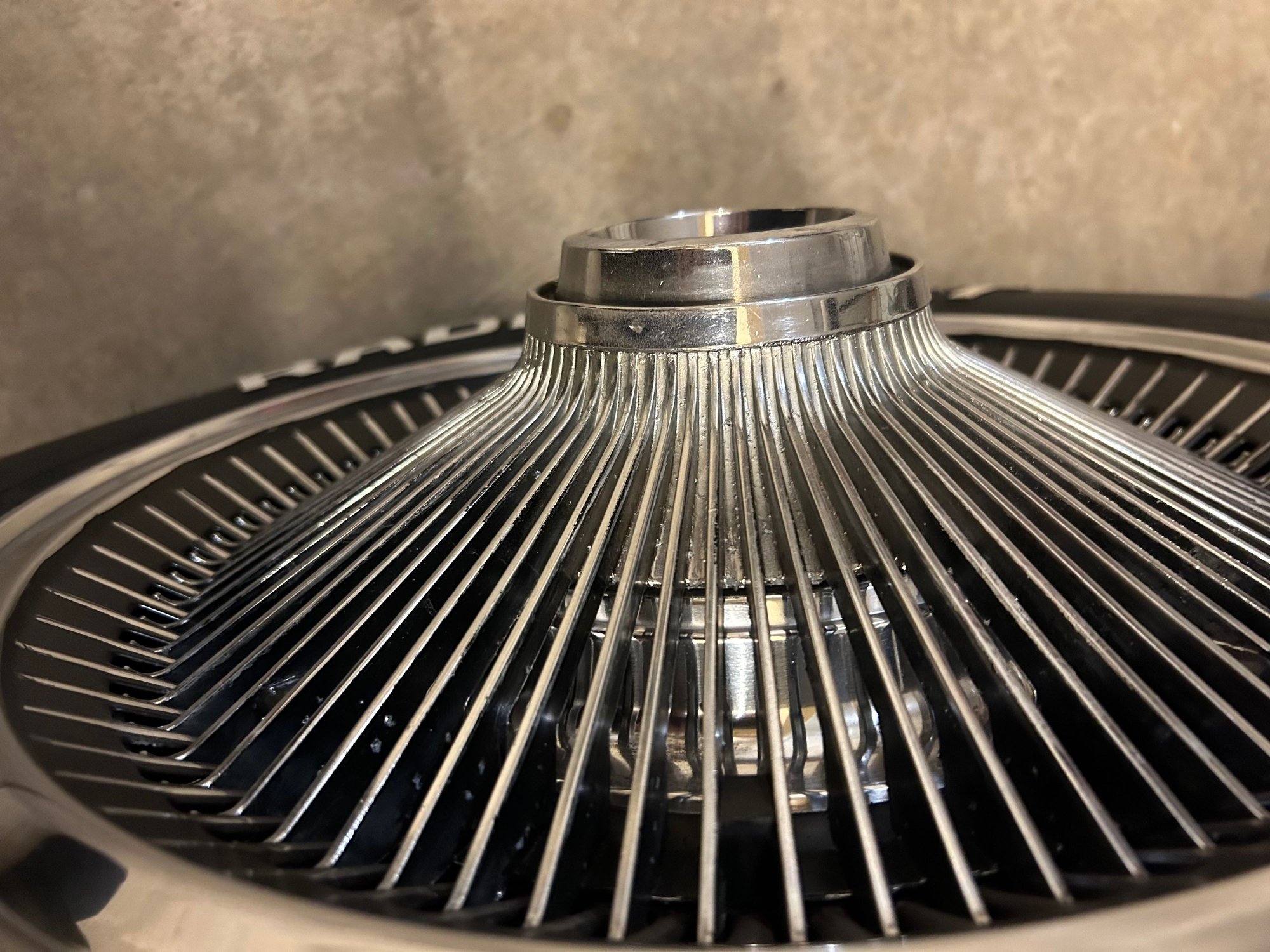

Hi Mark,
Thanks! The outer part of the P02 is clear to me about tapping. I wondering more about the insert fins turbine part, and how to cover this area. The fins on top are easy to swipe off with thinner.

They are all clear. Plain.

Realy? I am skeptical, the effort for GM would have been enormous to produce such an additional cover for the painting process.
And I found this pic.
To P02 - Correct repaint scheme
