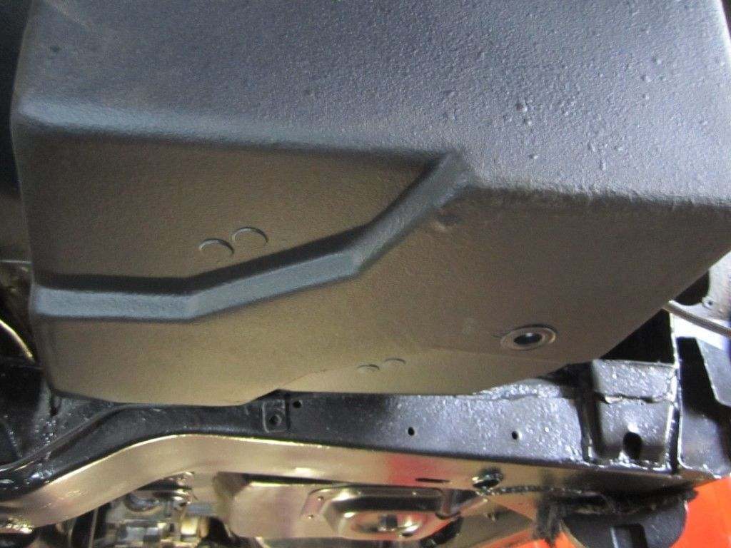

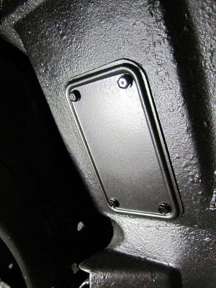

I shot the wheel wells with 3M 08883
and the battery jack trays etc with 08881 (had a slight brown tint so I topped with a dusting of krylon semi black)
Not that you were asking or anything
M

The 08881 is a bit smoother while the 08883 had more texture / thickness, was also glossy which I didn't want on the battery / jack boxes but was good for the wheel wells.
M
