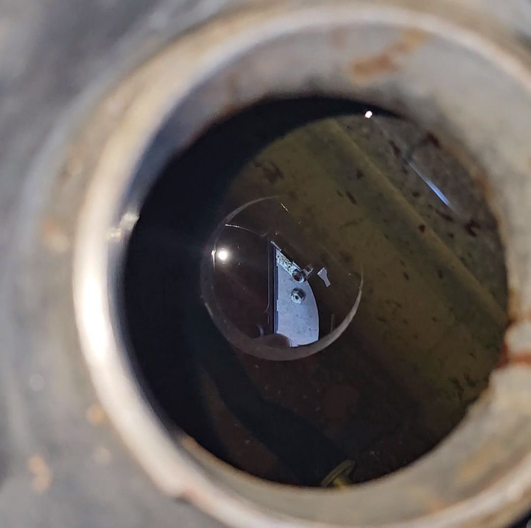

I ran all the diagnostics suggested and can report back that the only issue I came across was maybe the sock in the fuel tank. I researched what it's supposed to look like but each time i try to look in the tank I just notice the reflection of the opening and do not see a sock (image below).
For a multi pronged approach, I'm replacing the air filter, & fuel filter, now the ignition switch and maybe the sock.

when you drain the tank, let it dry and see what all that dark material is at the bottom

I can see the sock in your picture, but the black stuff could be the sock has disintigrated and breaking apart. Lou.
...yep, the sock is definitely there, just looks black instead of white-probably clogged with dirt, dust, debris. You also may have water or moisture in the fuel in that tank. Water will be at the bottom and will look like small pools, or bubbles.

After emptying the gas tank and pulling out the sending unit, I was able to figure out the tank isn't rusted out and that the sock was completely ripped:
Also, the fuel filter next to the tank was disgusting:
Going to be blowing the fuel lines out with an air compressor and attaching a new filter as it comes in (luckily had bought a sending unit sock & gas tank ring/gasket on a feeling.)
Just wanted some thoughts on why it could have gotten so dirty and beyond putting an additive in with the fuel what can I do to clear this up, then also keep it from happening again 🤔

The red stuff is rust, probably from condensation, some of the other bits could be from the old sock or the inside of the filter coming apart. I would flush the lines to see if they are fullnof crap and replace the pickup. Did you say the inside of the tank is rust free?
Im guessing the p.o. was having issues with crap makingnit from his tank to the carb and thats why that filter is thrre. Its not an OEM filter.....stock filters were in the carbs

Looking into replacing the pickup now and even the tank (upon further examination once it dried and I got some more videos of the inside, it was looking crusty and little rusty.)
Just bypassed that other filter since it's not OEM, added some Marvel's Mystery Oil back to the fuel I took out because that was all clear, and the car has been doing better than it has in my possession!!
