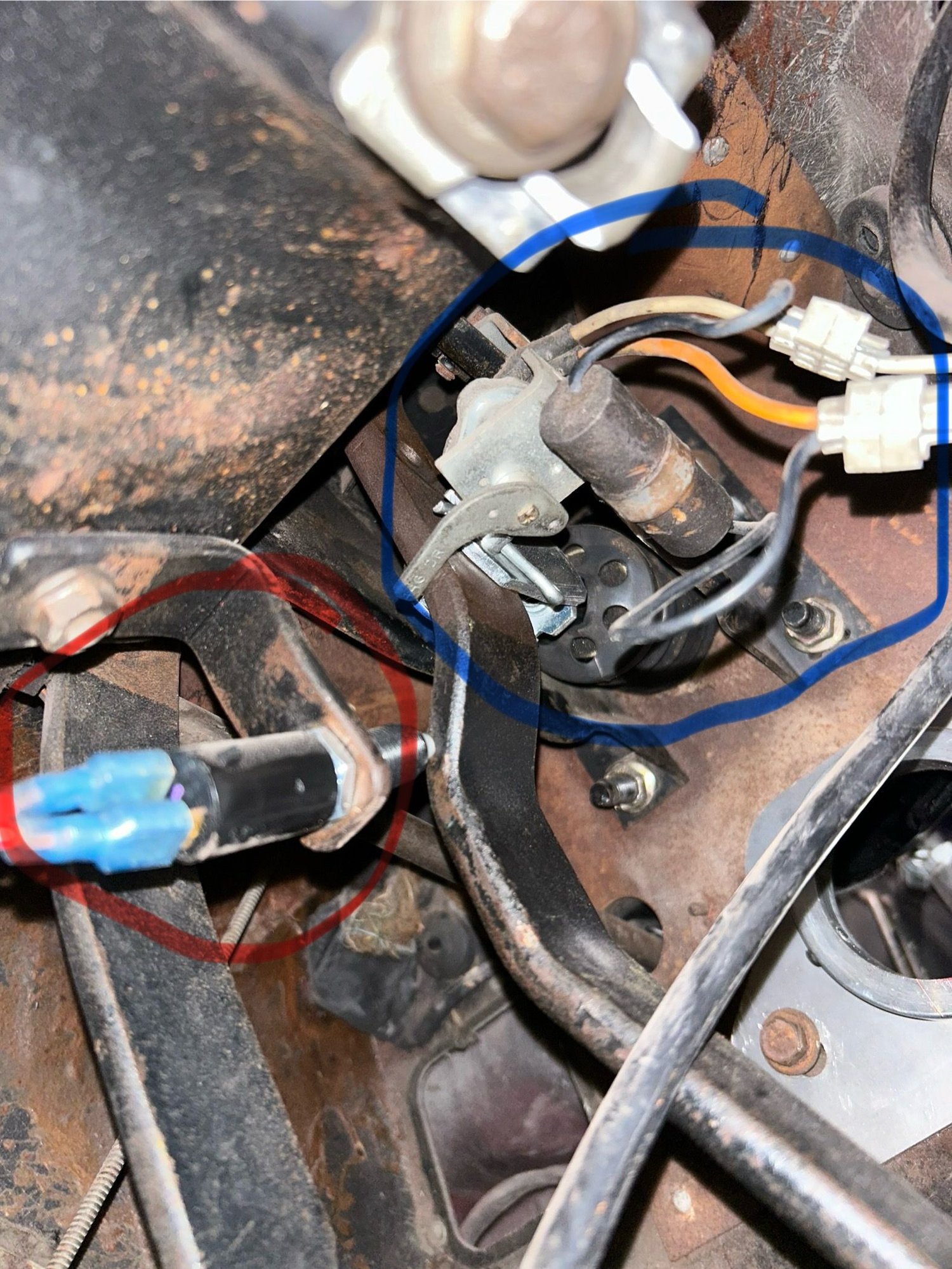

#1. At my brake pedal I have the brake light sensor I have been using “circled in red” but then I found this one circled in “blue”. Is this the same thing but it looks better.

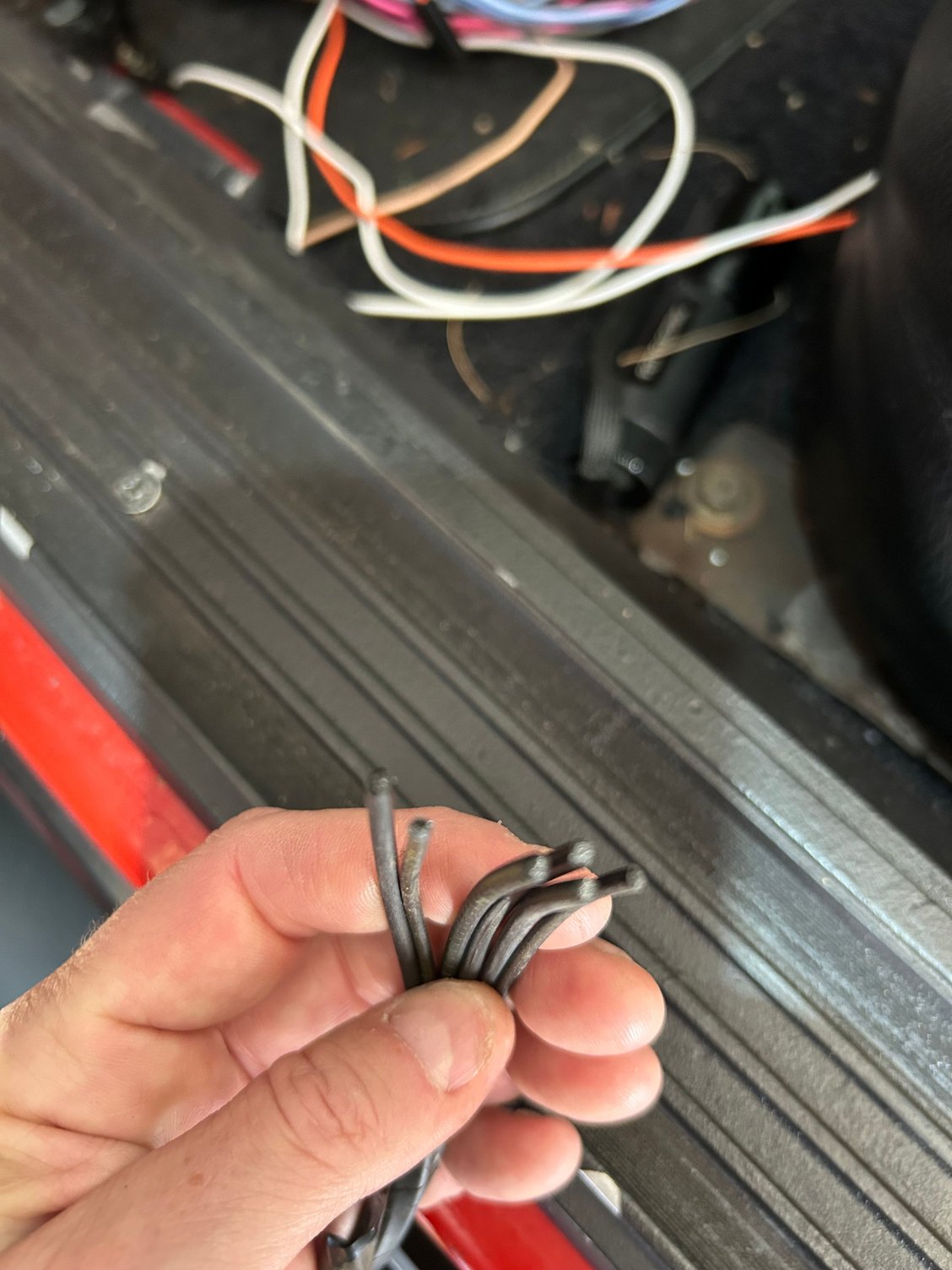

#2. What is this wire that runs just beneath the fuse box and through this grommet? “Circled in red”

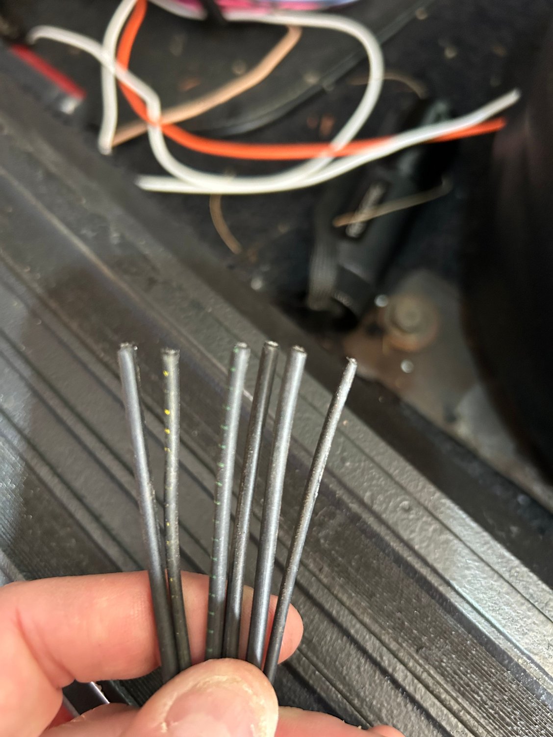

Hello. I think the "wire" in picture # two is actually the fiber optics from the front of the car to the console. That's were it came thru the firewall on my 69,

I guess it could be. I never thought about fiber optics. Ill have to check cause I was only looking at wires
Old Dec 8, 2023 | 12:26 PM

Number 1, circled in Red is the brake light switch. Circled in Blue is a radio noise suppressor.

I peeled back the wrap on #2. Does this look like fiber optics?

In #1 the blue circled switch is the original 68 brake light switch with noise cancelling condensor. These ancient GM truck switches are only found on the 68's, and they do not last long and are very hard to replace and adjust due to their location. The red circled switch is the 1963-1967, 1969-1996 plunger type brake light switch and a bracket that someone added instead of the original 68 switch.

I believe they are. Correct number. Four for the headlight and two for parking/signal lights. They should be little tubes and often almost look solid at the cut ends if not cut cleanly. Perhaps that is why they don't look like tubes.
