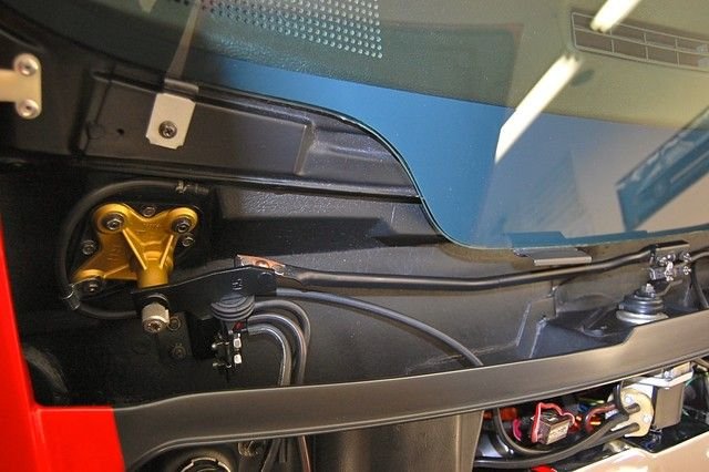

Here you go John-
Hope you and yours are doing well-
Thanks to "Alan71"

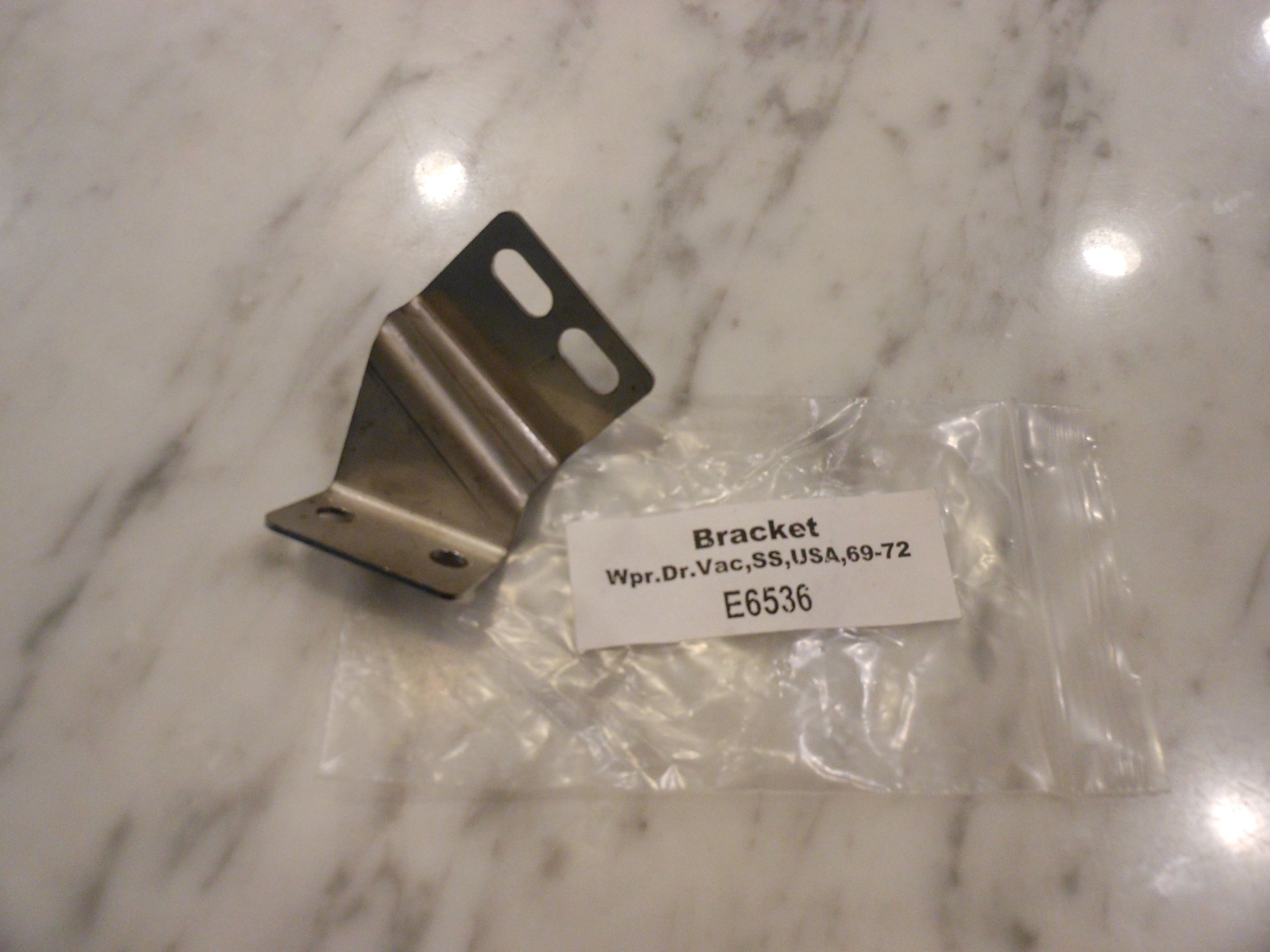

Have you got this bracket? Black painted originally- now reman with SS

Thanks Richard!! YOU ROCK!! I am pretty sure I have the bracket - just exactly where it is the question!! LOL! Too much aah STUFF!!

the bracket is original phosphated and sometimes has black out over spray
there is 2 nuts and switch is secured with two raised edge bolts with integral washer( if you want a pic let me know)

I found the brackets (aftermarket) but they don't have the captured nuts. I will search my storage bins today and see what I can come up with.
